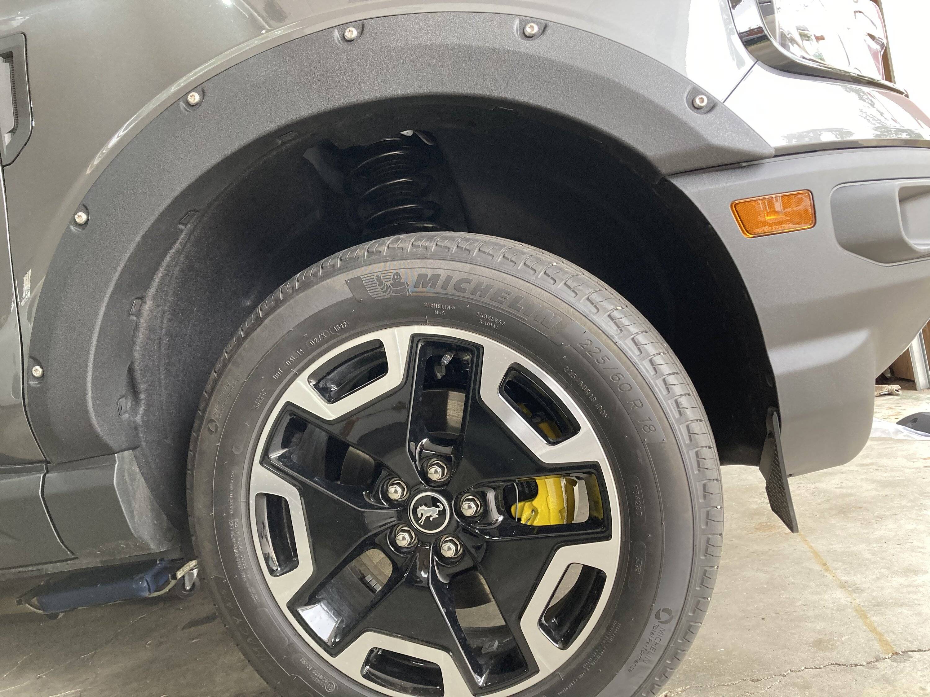

Lifted sport outer banks with rough country 1.5 lift. Went to bell tire and they told basically nothing for options to get more aggressive tires… is that true?
Anyone have pics of tires they put on there lifted outer banks with the 18” rims. I don’t know much about tires so sorry for the dumb questions ?

For an 18" wheel the biggest tire you can comfortably get is the 245/60/18, which is 29.5".
This same tire size can be had in other wheel sizes:
  • 245/55/19
  • 245/65/17
  • 245/70/16
I think you can get the basic idea here. The interference/rub that happens on the Bronco Sport is that the tire will hit the pinch weld at the back side of the wheel well when the suspension is compressed and the steering wheel is turned. Anything larger than a 29.5" (go to tiresize.com for information) will most likely cause a rub at the extremes.
Some people have cut the pinch weld to get more clearance, but this is a very dangerous idea for a unibody vehicle. They are basically applying old "body on frame" logic to a unibody. The unibody is the frame and cutting it could have unforeseen consequences.
If you are willing to say that you will never compress the suspension and turn the steering wheel at the same time, then you can put a bigger tire on but not very much bigger.

100% agree but I'll add, there seems to be a much better selection of Sport-ute type tires in 17" sizes, though I know he already has the 18's. I'll also add that if you want to push the limit on diameter a little, a 235/70/17 at 30.0" in diameter and narrower would be a good choice or it's equal in 18's the 235/65/18 but the tire selection in both sizes is not great.

Thanks guys, both great responses… very appreciated.
just got off the phone with bell tire. Ordered good year work force tires. 245/60r/18, it will have to do.
