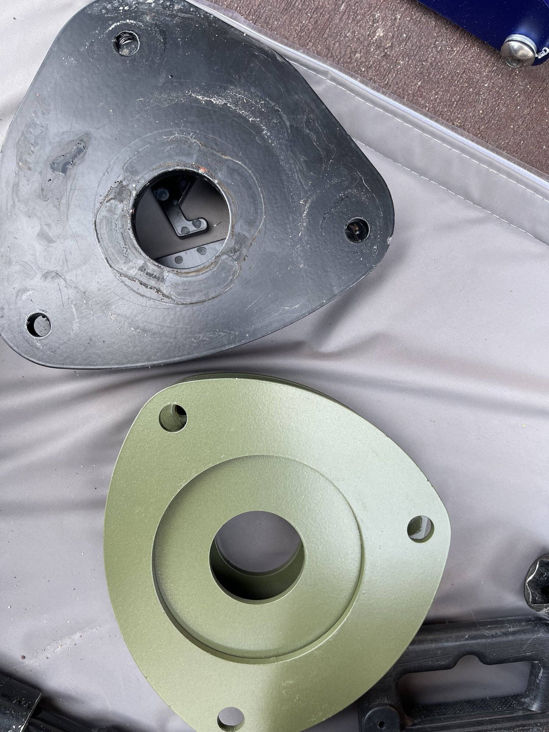

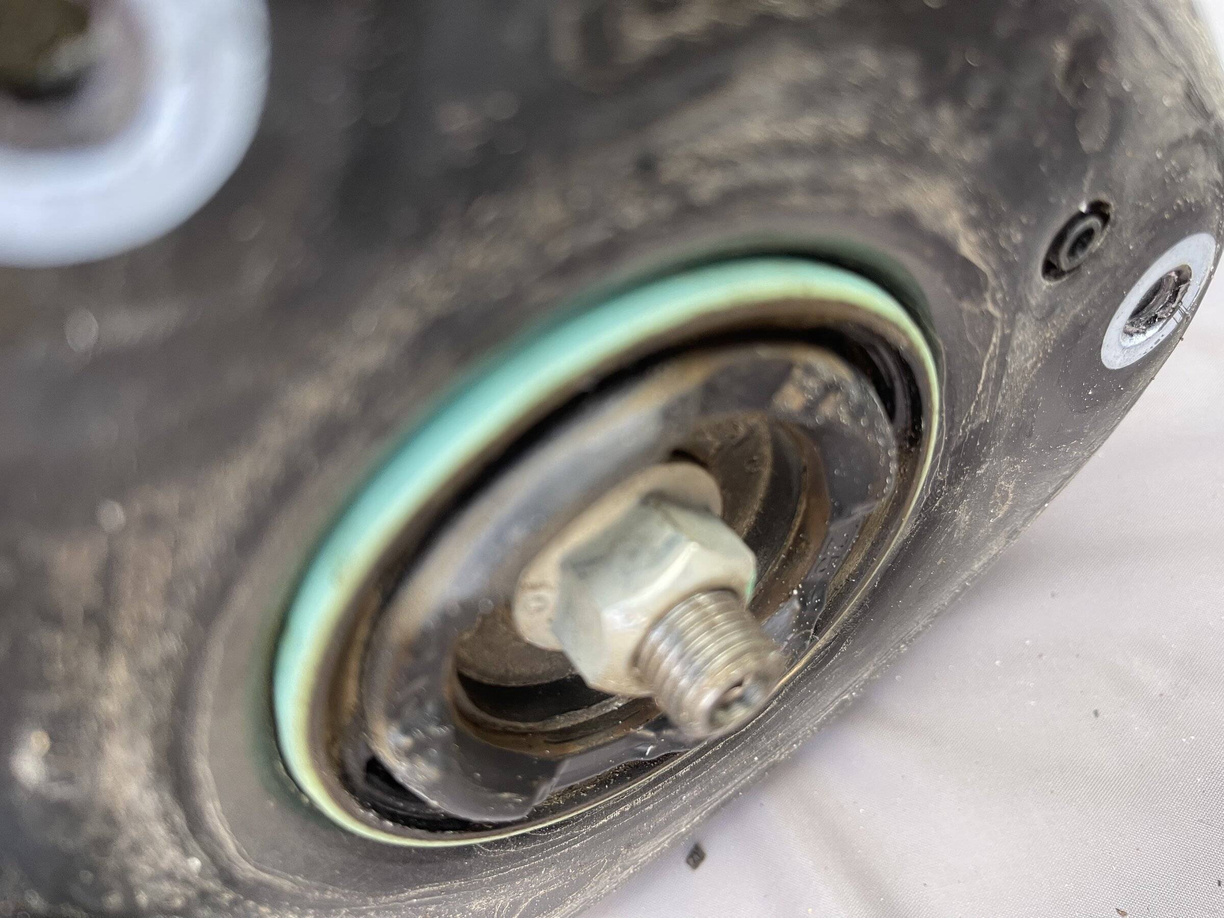

Tightening it won’t help the clanking comes from not having a cut out for the strut hat, I learned the hard way by having a readylift which supposedly fixed, as what I was told directly from readylift.

Thank you so much!!! Glad I got that HRG lift coming then. I will deal with / drive it very limited the next 2-3 days until I get it put on. I wish I wasn’t such a forgiving / nieve person. I should’ve never put it on after I saw some of the reviews.
