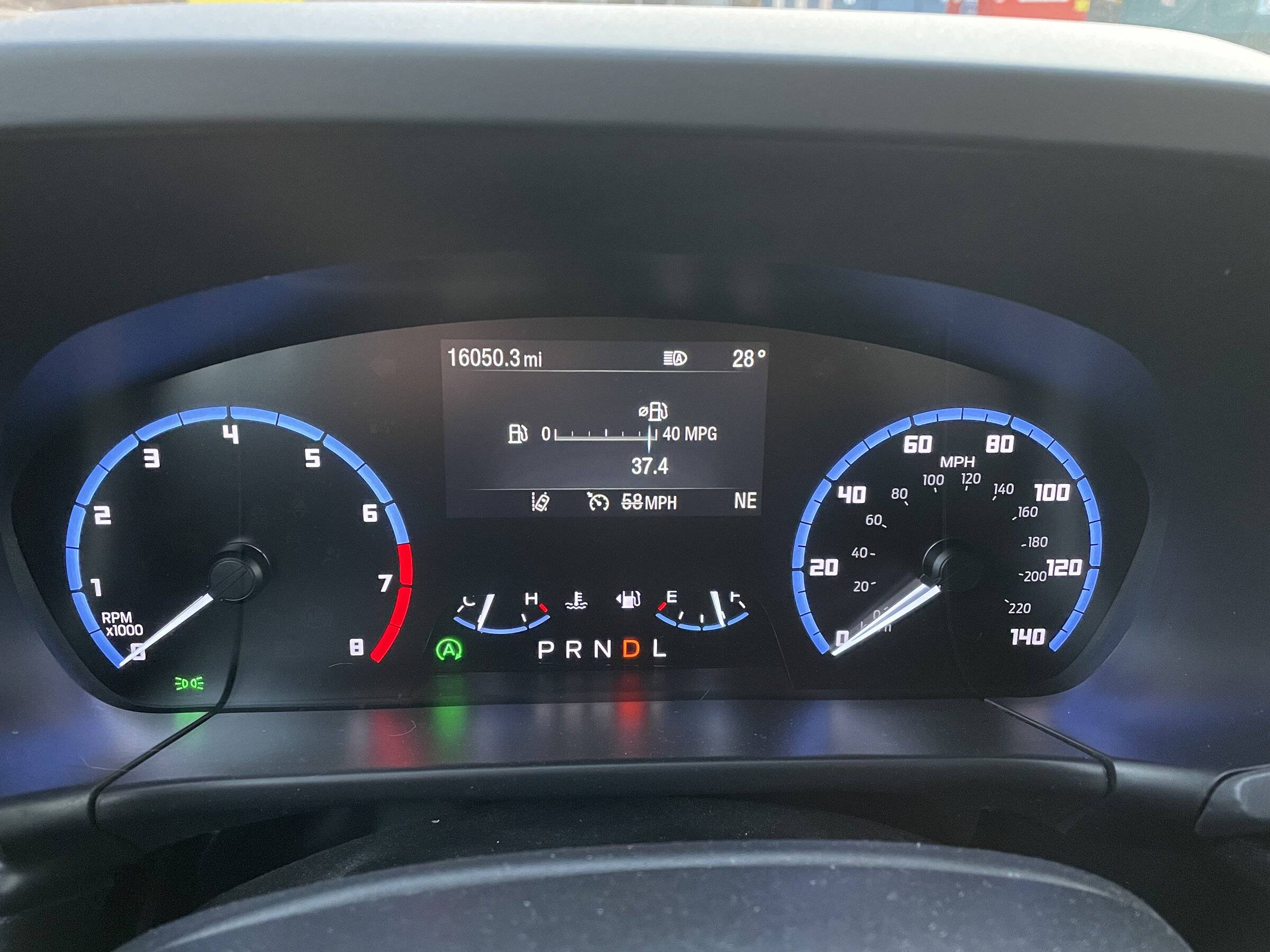

Base Model.. In shadow black of course..
Ford Bronco Sport Lagging gas mileage 53E1D616-74F6-4612-B4D7-E5EF09DD2066
My granny driving mpg’s after a reset, meaningless but I wanted to panic the mileage guru’s :’P

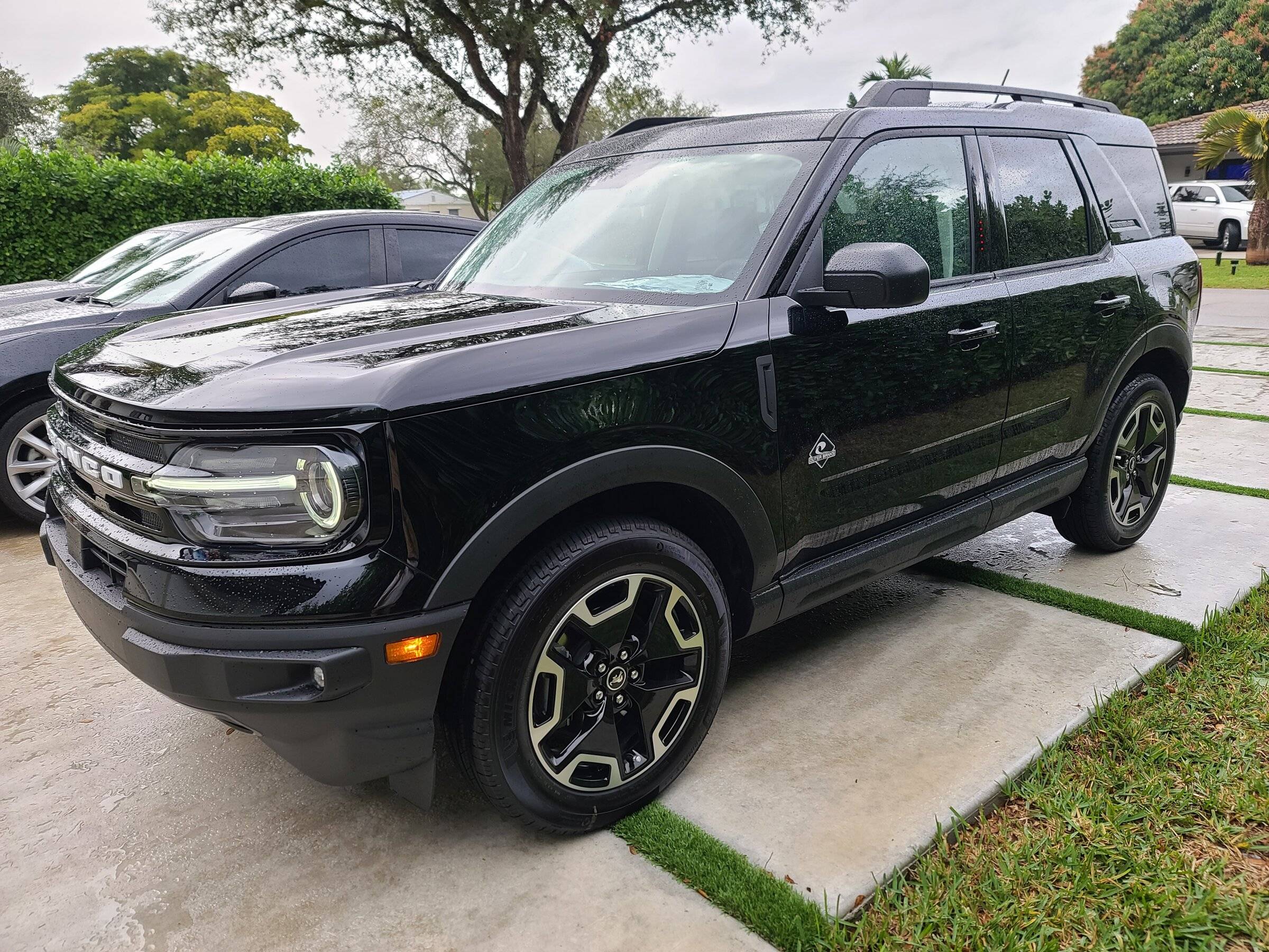

I just put in my forth full tank of gas at around 1200 miles. Barely broke in my mpg with the 1.5 is averaging 33, +/- 2 which is amazing considering my cummute. I drive in "Normal Mode" exclusively from Hallandale to Miami International, a 50 mile round trip. It's Freeway 95% of the way. It's almost impossible to use cruise because of congestion and wild swings in speed, that is why I am amazed at my mpg. One big difference I've noticed is type of fuel I use. It loves Sunoco ethanol free 90. I put in a tank of Mobile EF 89 and milage dropped to 25-27 mpg. Be sure and reset the mpg at fill up, you'll have a more accurate average if you change fuel specs.
Ford Bronco Sport Lagging gas mileage 20220120_172949
