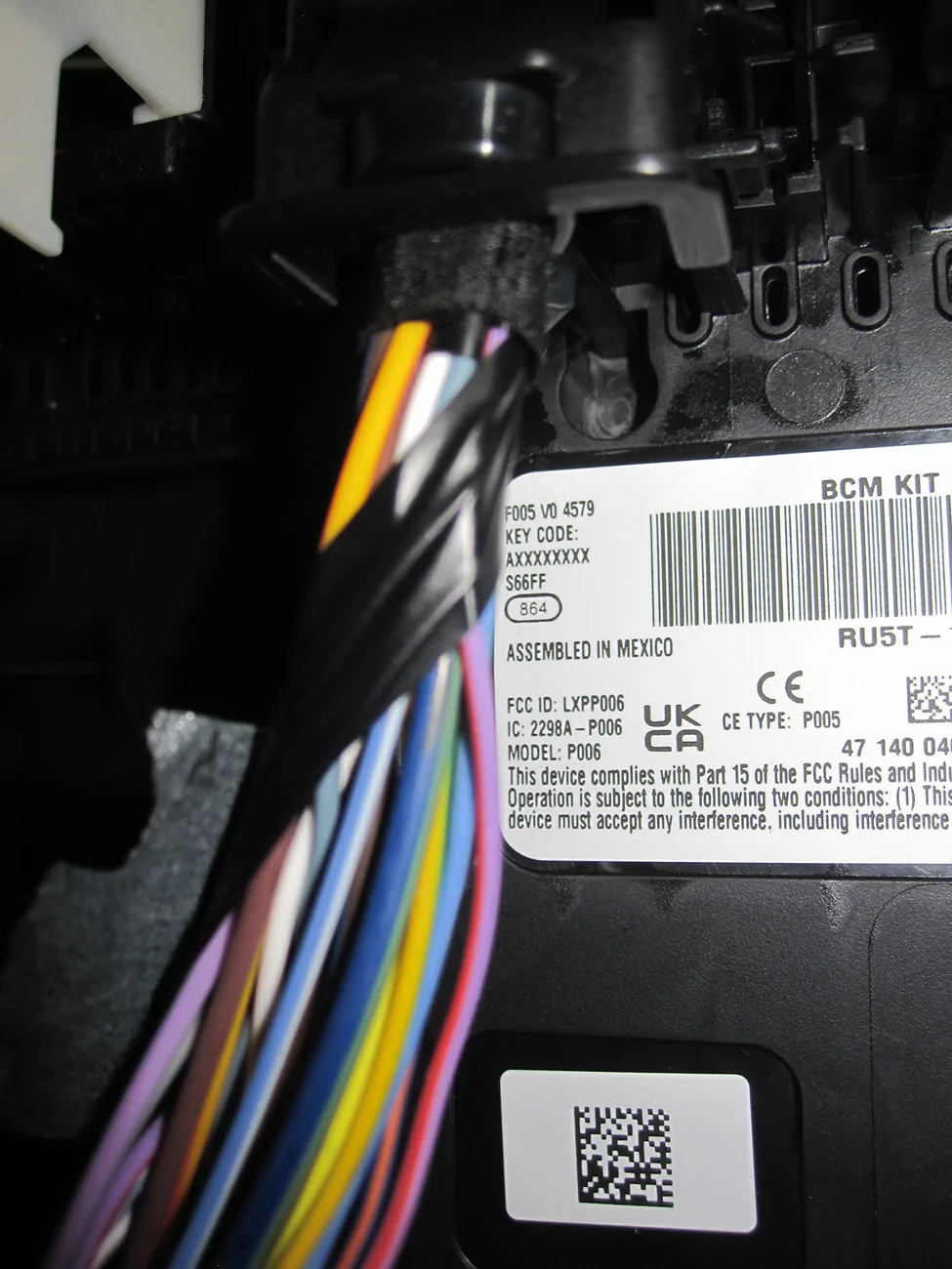

Welp, The touchpad will allow me to lock the doors now with the (7\8) (9\0) buttons. I also have a new menu item within the SYNC 4 that will allow me to program my own 5 digit key providing I have the OEM key...But there is no OEM key on the module and the 2 key display on the cluster method displays nothing on the screen. (I must of tried 30 times.) I used ForScan to look in the BCM module to see if there was a place to see the OEM key or program a new key.....so far NO DICE....
Maybe the backup key slot location is different for 25?
I had to try a few times to get the code. Have to swap keys pretty quickly.
Did you try the code under the dash?

There is a spot for a key but nothing is printed there.
I'll try to swap the key quickly and see if that works. (like I said I tried this at least 30 times)
Ford Bronco Sport Keyless Entry Keypad: there is hope IMG_0481
