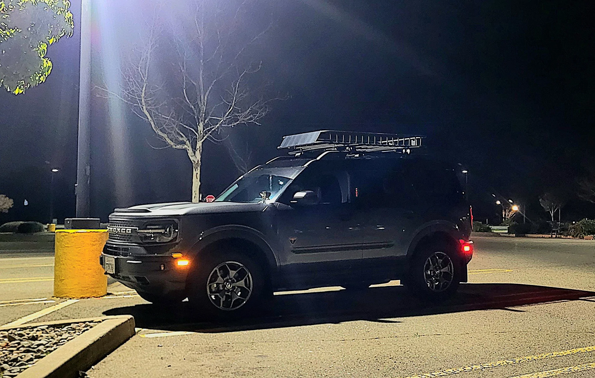

our big bend had it and this badlands didn't so i had to add it myself. Ford's accessory website that is linked is where i ordered mine using points. it also says it isn't compatible with badlands/wildtrack. it does require some panel removal as well as the window glass to install. and some forscan programming.
