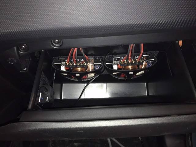

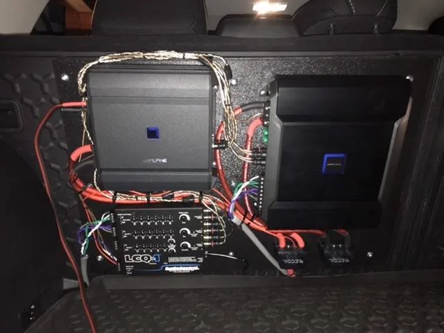

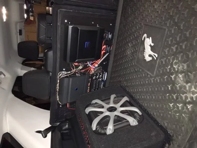

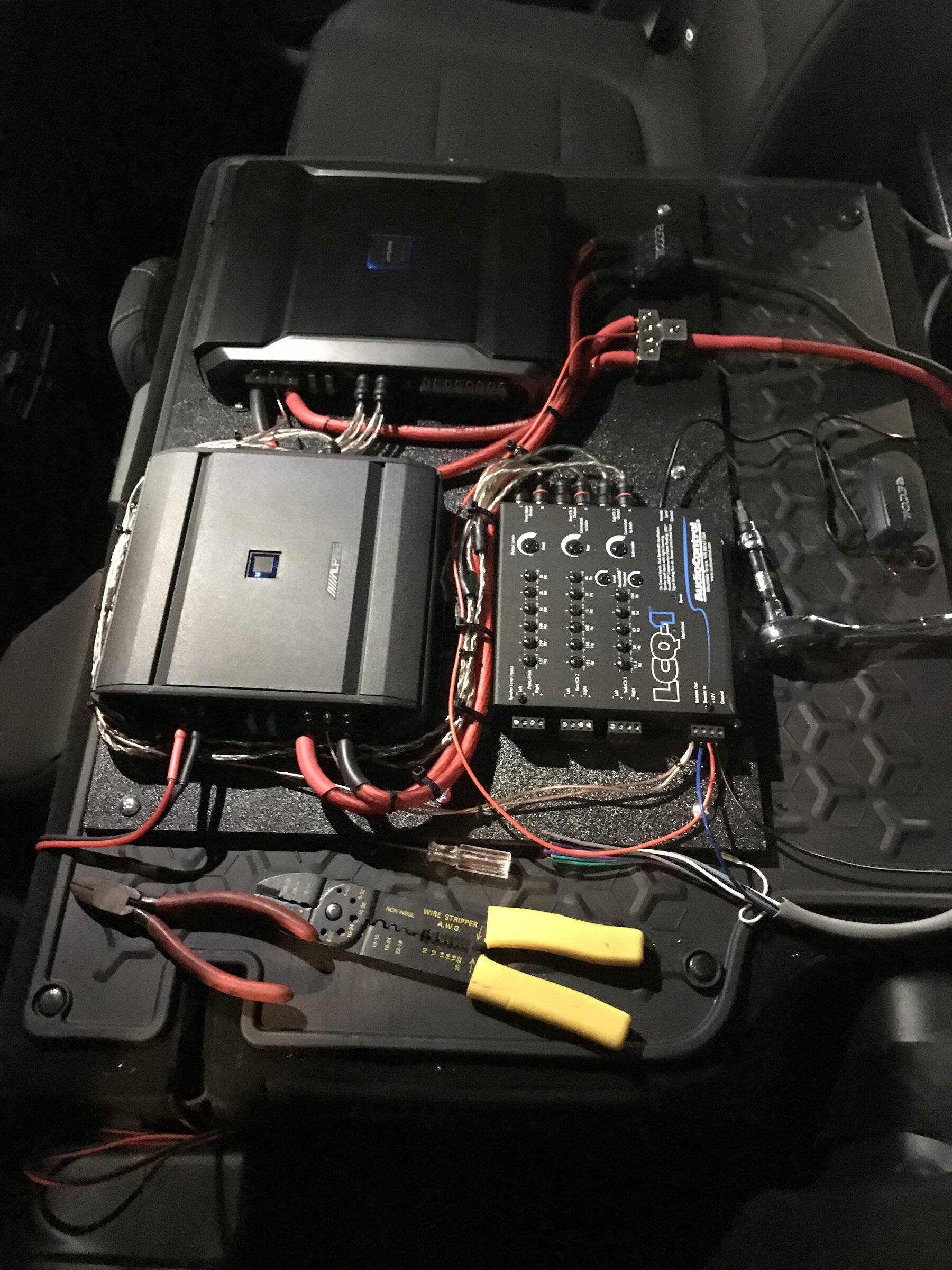

Finally installed my amps, LOC and crossovers. I’m not a professional, so it’s not the prettiest. I put the crossovers and bass knob in the glovebox and mounted everything else on the rear seat. Took me two long days.

I guess there's no flipping the back seats down and hauling a big item in the back.
Deleted member 6599
Guest
I can still put the seat down. I can just toss a blanket or something over the amps. I have the full size spare so didn’t have room around the tire.

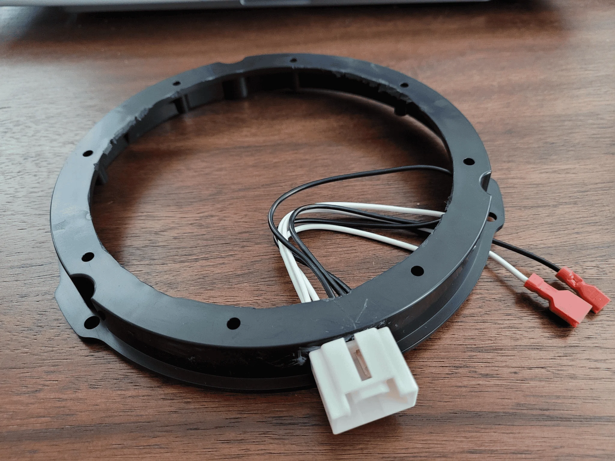

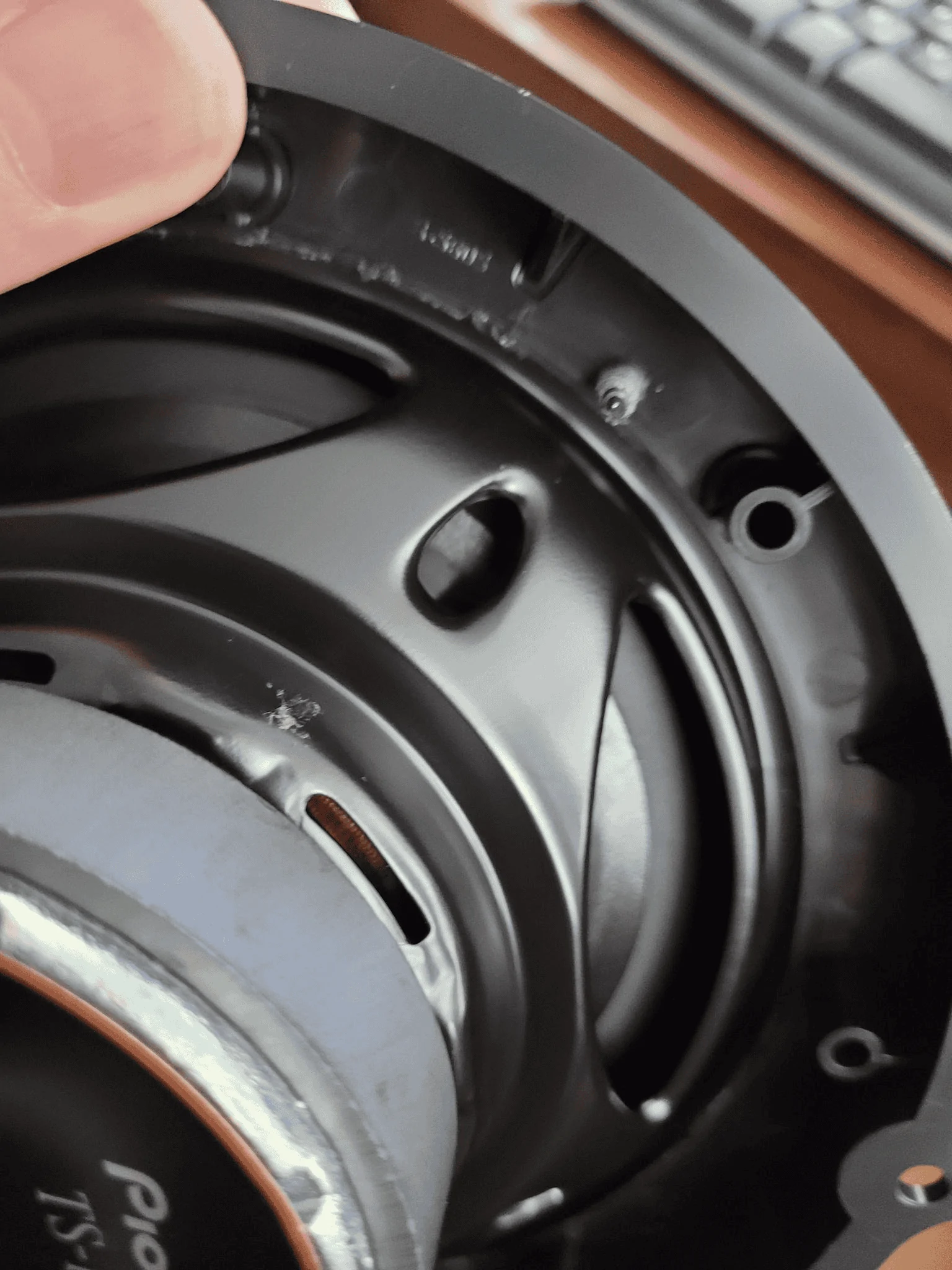

I used the Metra 82-FD1 (amazon: B09NB32MV6) speaker kit. I had to use my dremel to cut off the tabs in the middle, then I cut the cable adapter a slot in the side of the standoff. After that I superglued it into place.
Ford Bronco Sport Installing aftermarket speakers and sub in Bronco Sport! 1666381432399

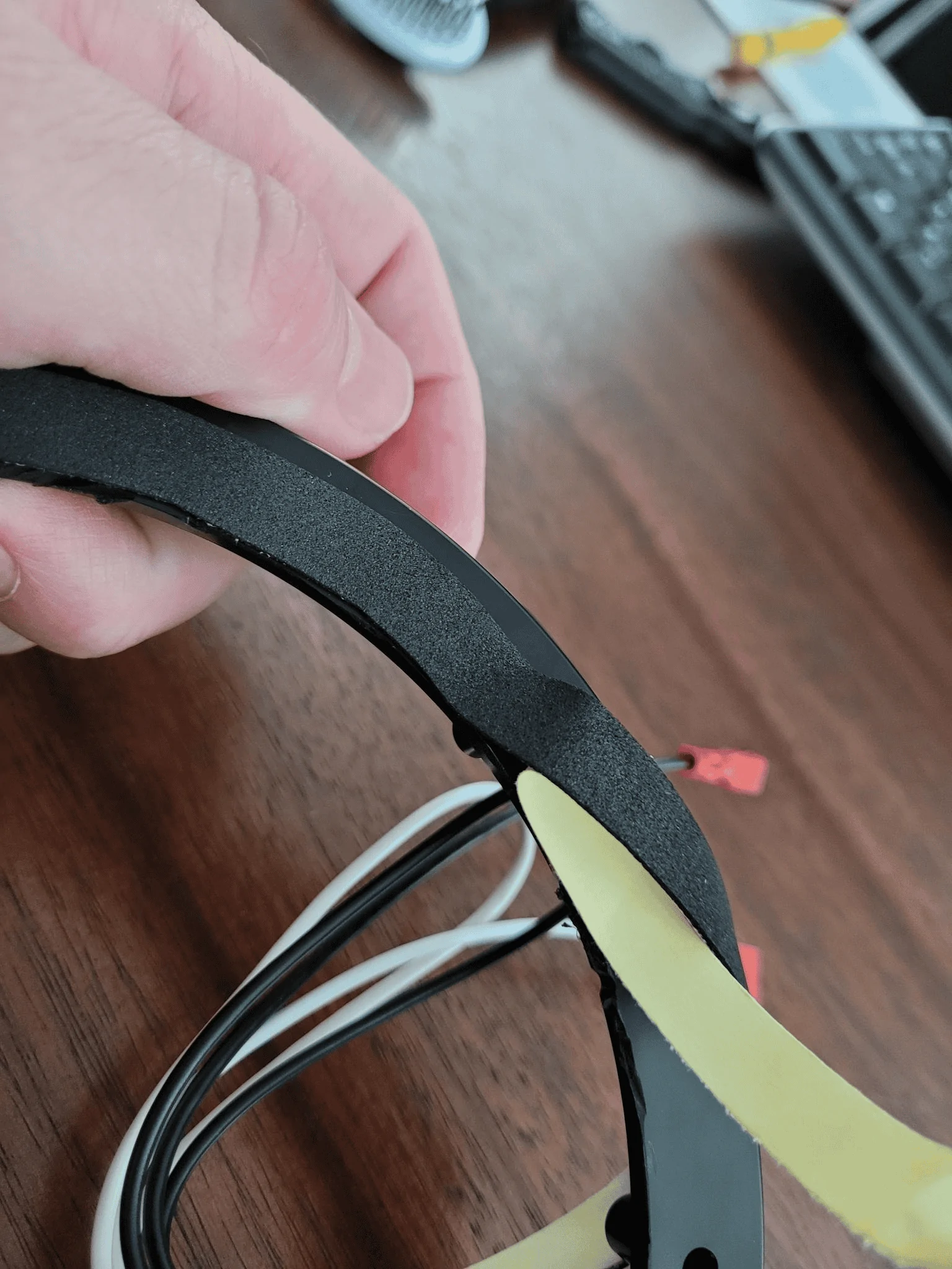

After that, I added the speaker mounting foam (amazon: B00WW6MZLM) to the front of the riser. If you have enough you can do the back of the riser as well where it mounts to the interior door panel.
Ford Bronco Sport Installing aftermarket speakers and sub in Bronco Sport! 1666381731149

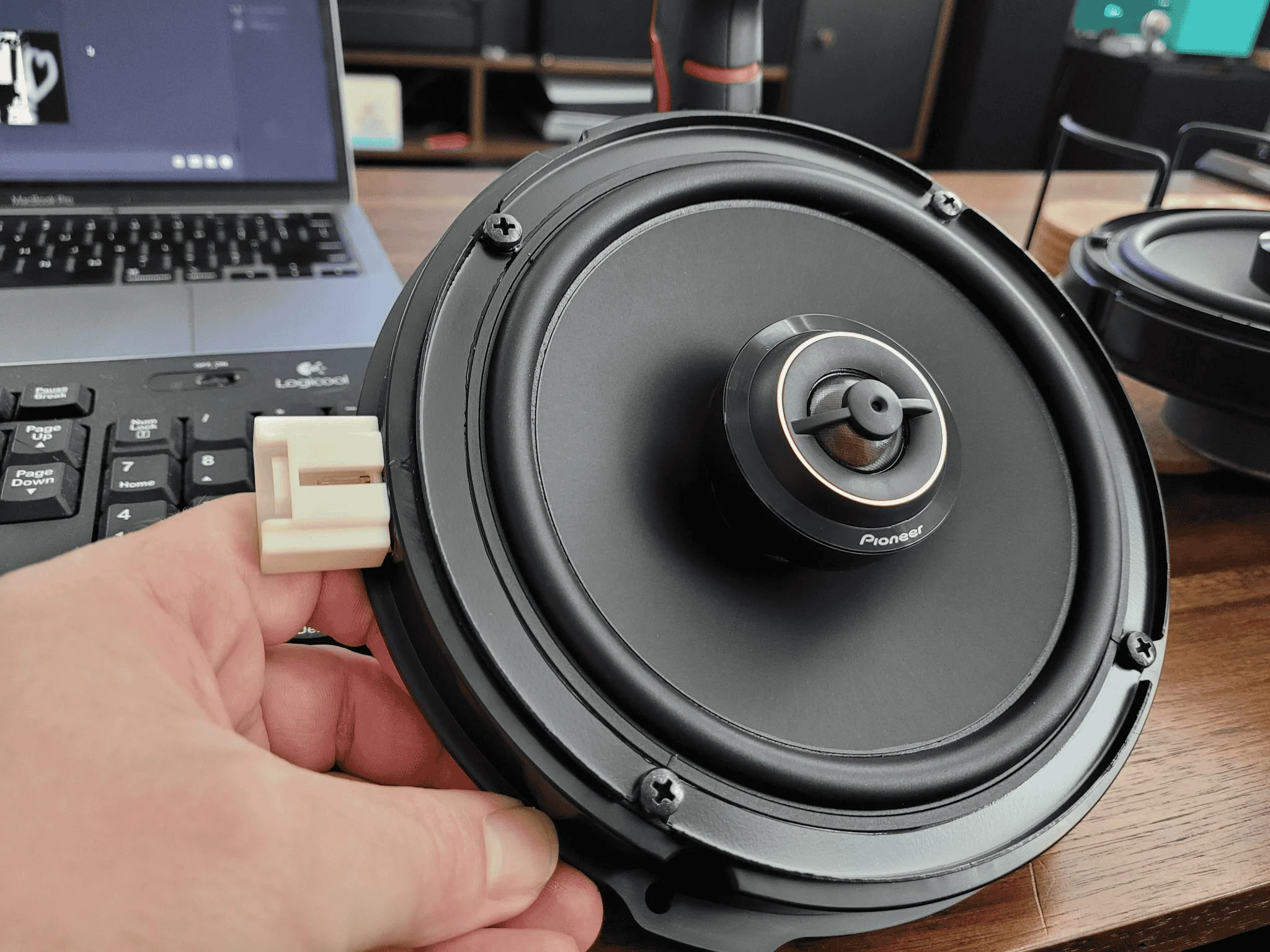

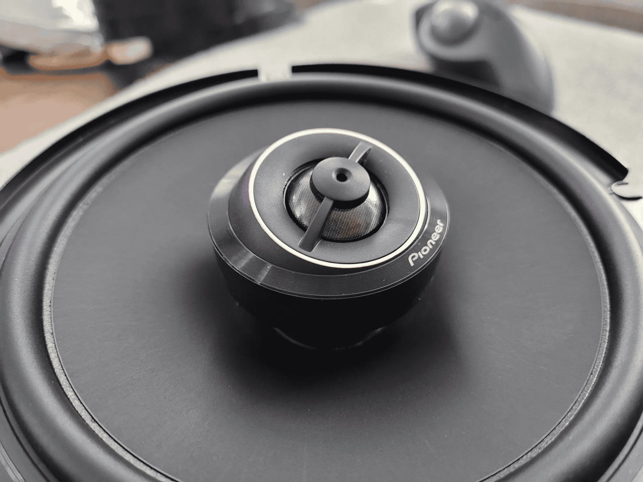

The speakers I got are Pioneer TS-D65F D (2 sets, amazon: B0777SKV7D). As with most speakers you can change the angle of the tweeter:
Ford Bronco Sport Installing aftermarket speakers and sub in Bronco Sport! 1666381958982
The screws shipping with the speakers are too small for the screw holes so I recommend just drilling a small hole in the side of the riser and using the screws that ship with the speakers:
Ford Bronco Sport Installing aftermarket speakers and sub in Bronco Sport! 1666382064591
This is the finished speaker:
Ford Bronco Sport Installing aftermarket speakers and sub in Bronco Sport! 1666382095939

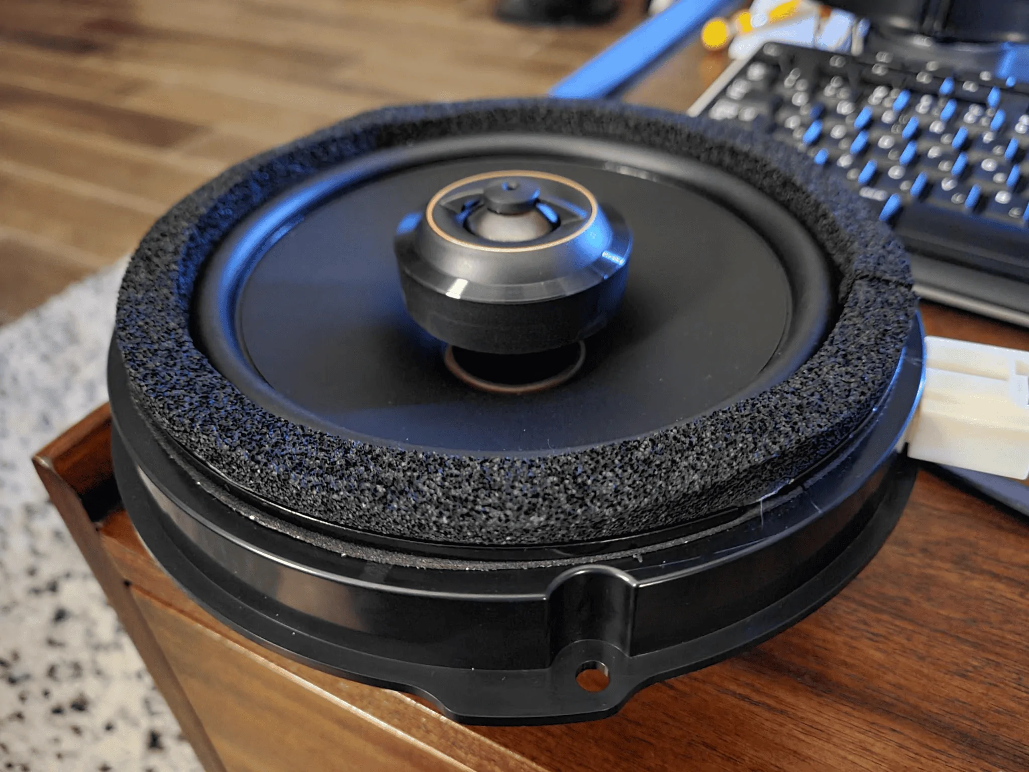

I added the open-cell memory foam (1/2"x1/2" - amazon: B07W5GGVFT) which seals against the door panel:
Ford Bronco Sport Installing aftermarket speakers and sub in Bronco Sport! 1666382206228

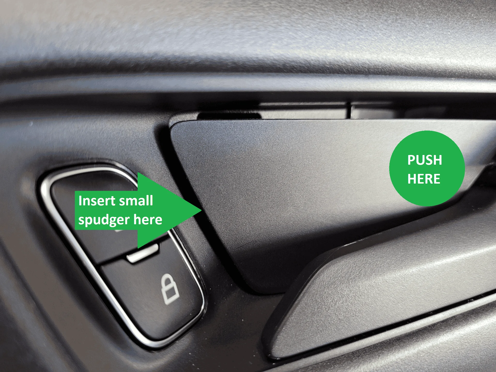

Installing was easy:
This is the first secret screw:
Ford Bronco Sport Installing aftermarket speakers and sub in Bronco Sport! 1666382395727
This is the second:
Ford Bronco Sport Installing aftermarket speakers and sub in Bronco Sport! 1666382478072

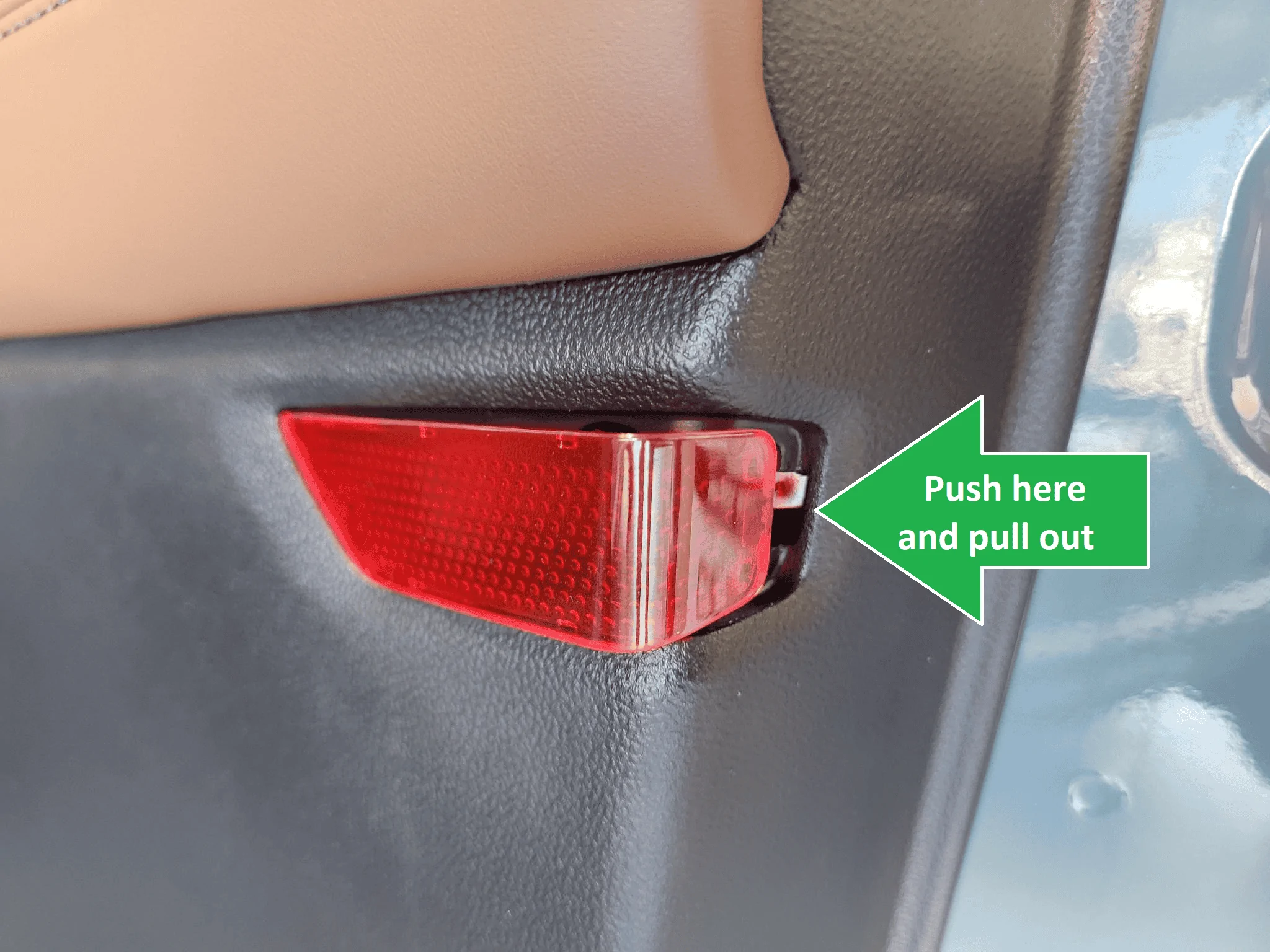

Insert a spudger under the panel with the window controls and lift straight up to get access to the 10mm bolts.
The screws under the reflector are the same as the two screws under the door.

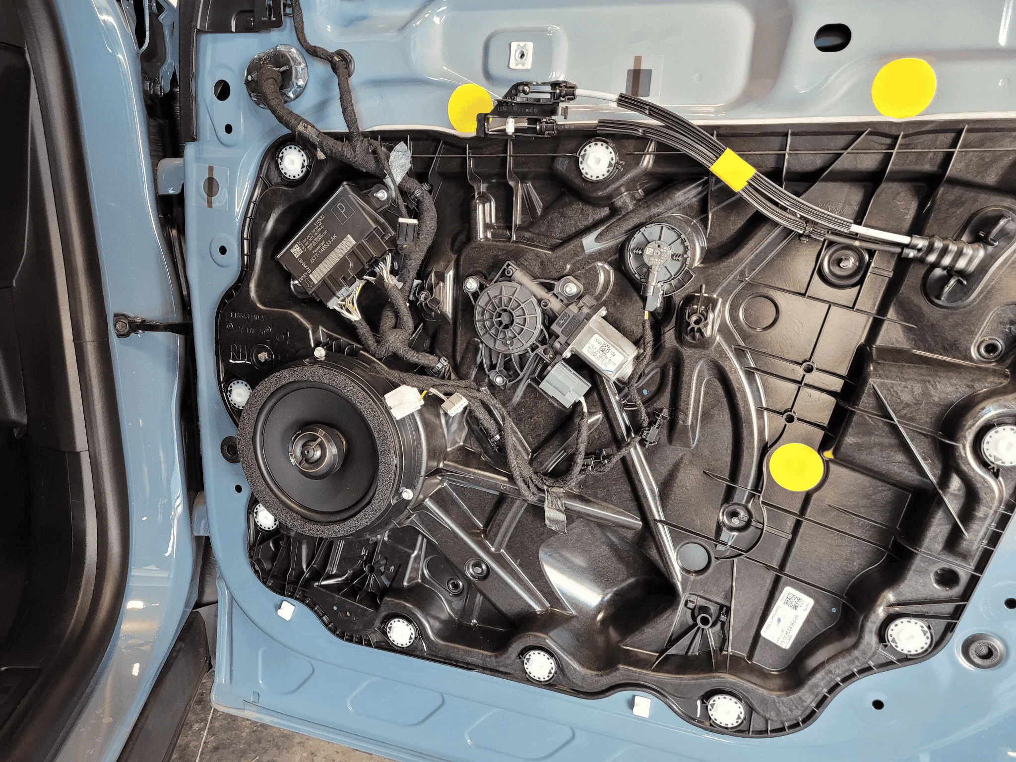

Here is the inside of the door. You can see how I angled the tweeter upward:
Ford Bronco Sport Installing aftermarket speakers and sub in Bronco Sport! 1666382658724

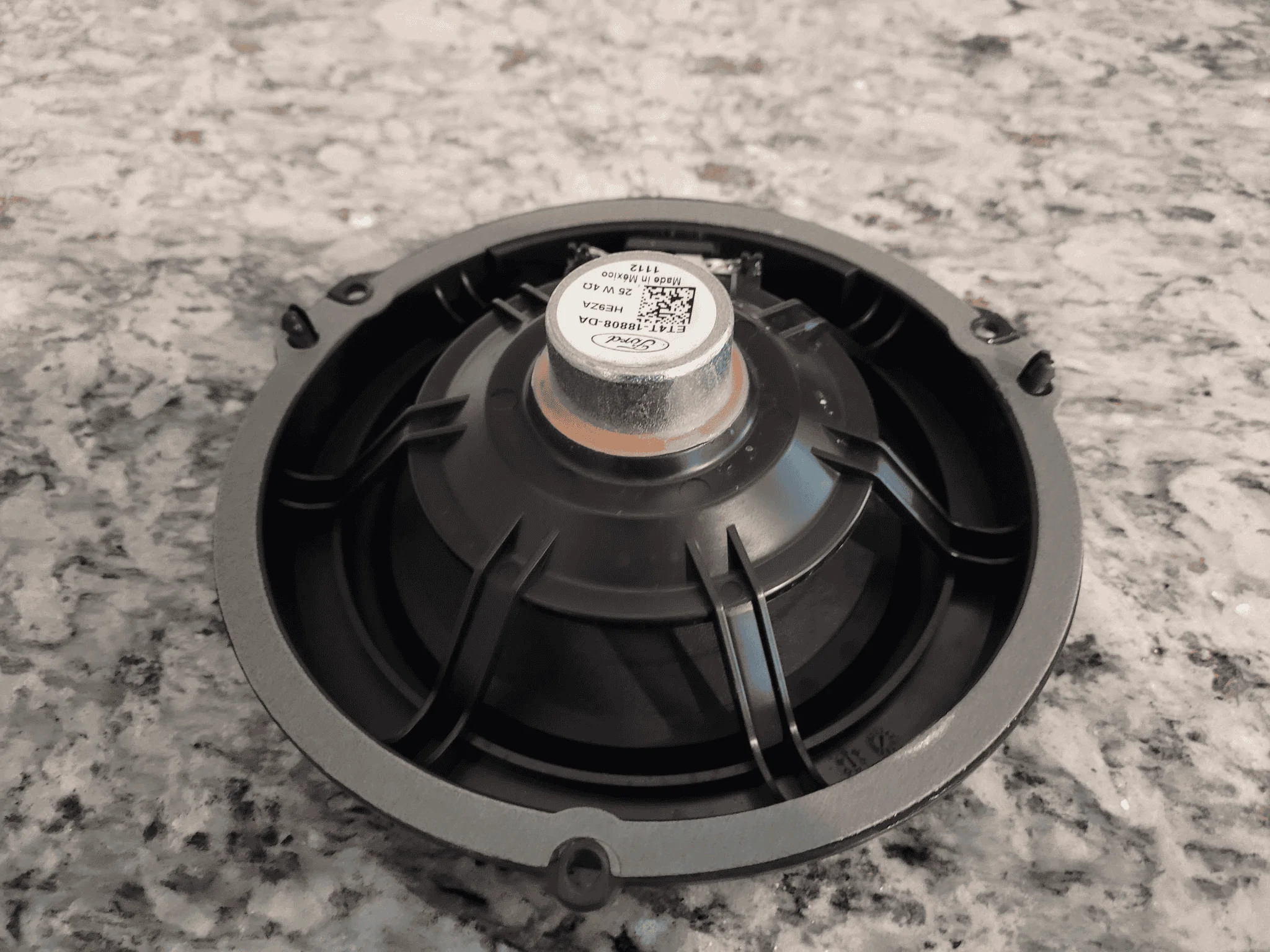

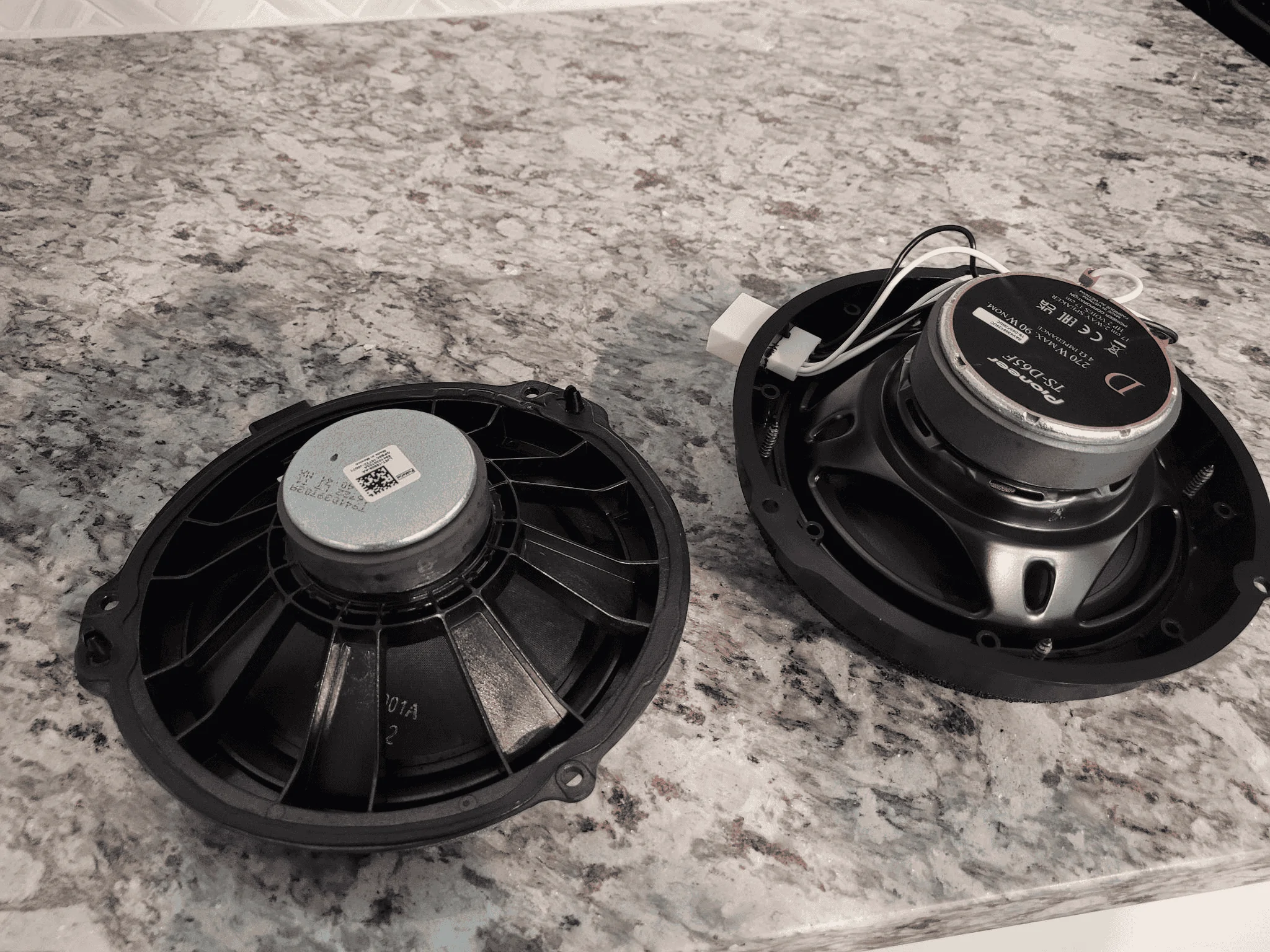

Finally, here are some pics comparing the speakers. This is the new speaker versus the B&O front speakers:
Ford Bronco Sport Installing aftermarket speakers and sub in Bronco Sport! 1666382841608
This is the rear B&O speaker:
Ford Bronco Sport Installing aftermarket speakers and sub in Bronco Sport! 1666382848328
