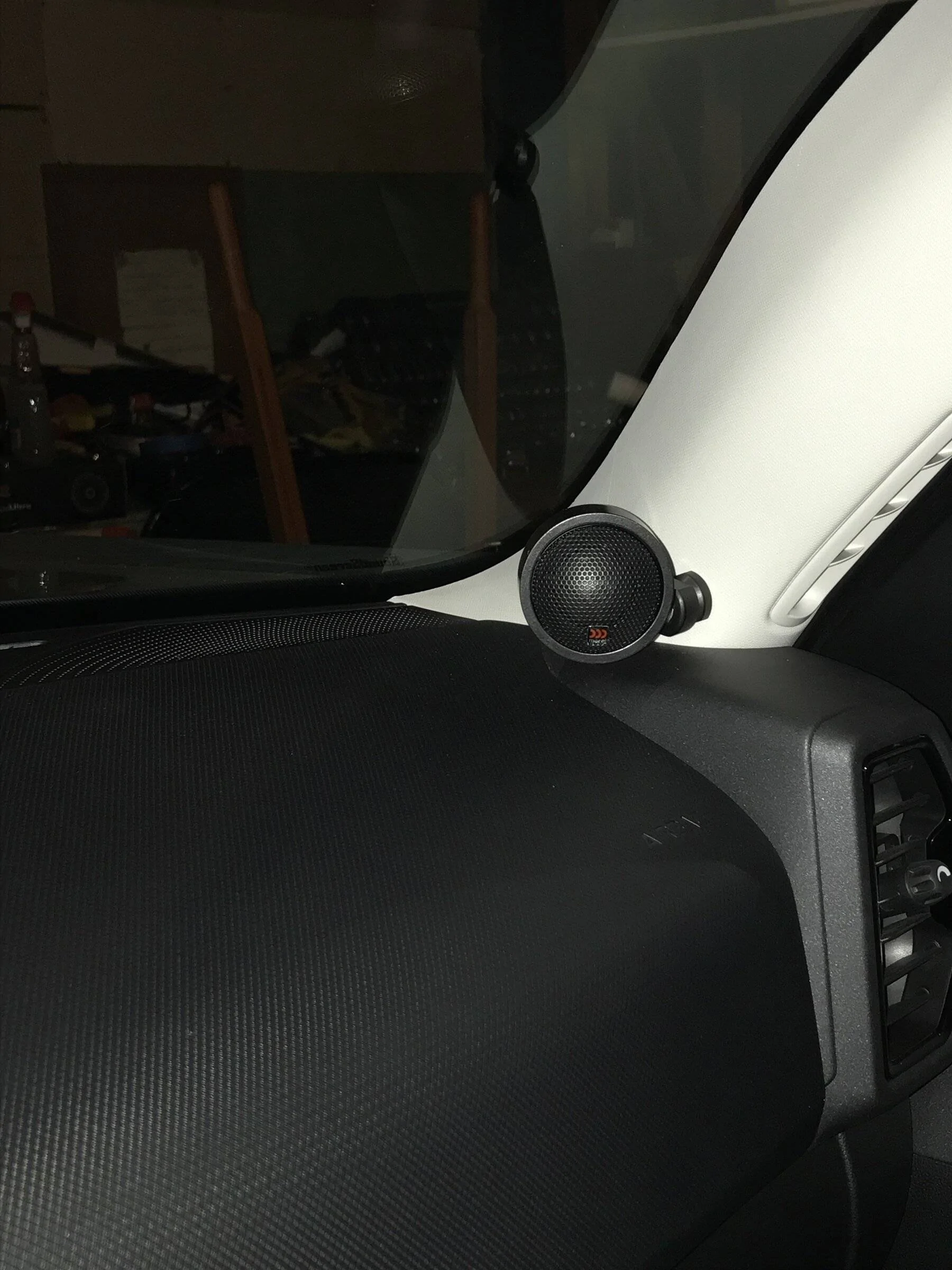

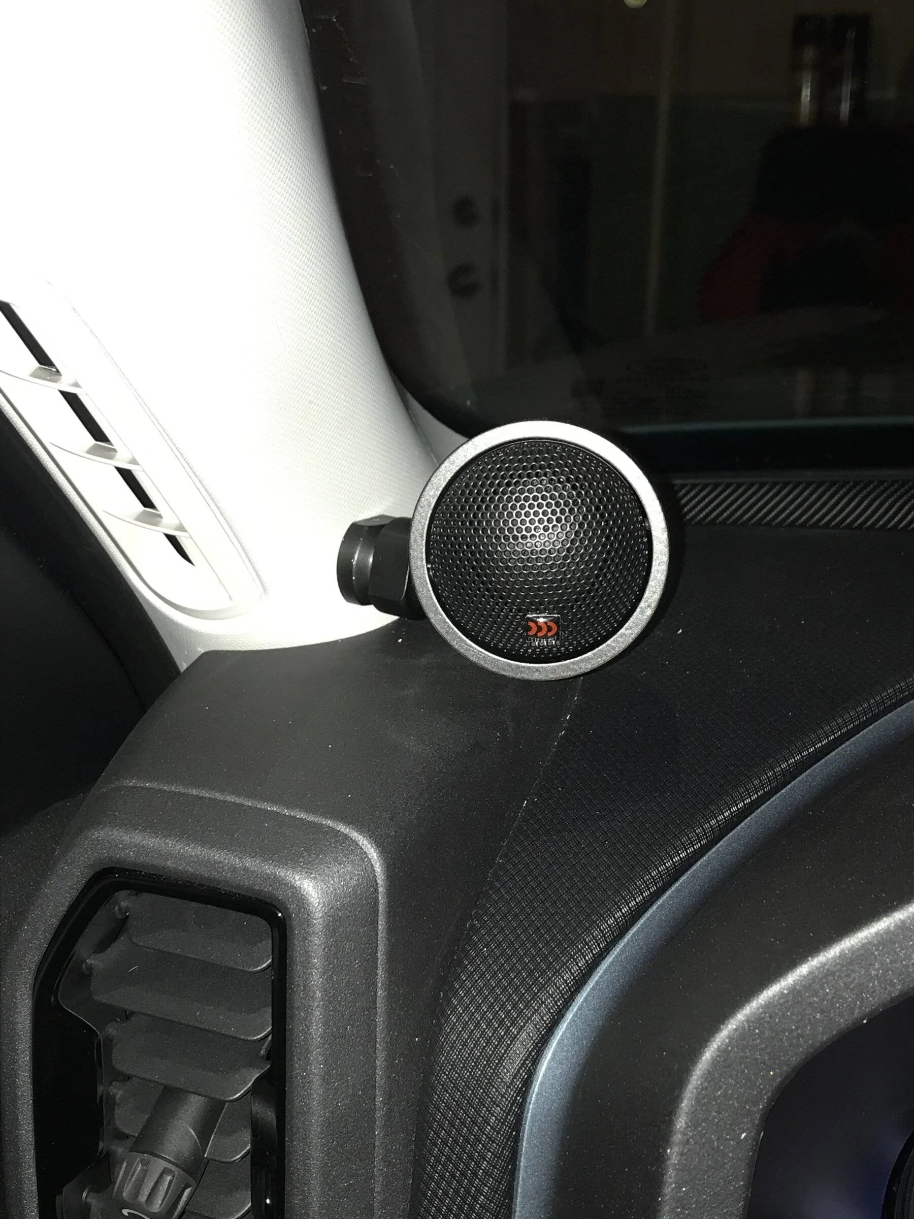

Pioneer TS-D65Fs. They are great. If you dig through the thread you'll find I posted links to the adapters and harnesses. There is also photos of how I mounted the harnesses by cutting a small hole in the adapters. I also used speaker foam and a sealer for a baffle. They sound amazing for not being amplified.
Links to stuff
https://www.bestbuy.com/site/metra-combo-speaker-mounting-kit-for-select-ford-2011-2020-vehicles-black/6438740.p?skuId=6438740
https://www.amazon.com/dp/B00WW6MZLM/ref=cm_sw_r_apan_glt_fabc_RS40CE4XP3GNXHB97FP9?_encoding=UTF8&psc=1
https://www.lowes.com/pd/M-D-Expandable-Foam-Weatherstrip-1-2-in-x-1-2-in-x-20-ft-E/1002926160
Ford Bronco Sport Installing aftermarket speakers and sub in Bronco Sport! 20210626_131008
Ford Bronco Sport Installing aftermarket speakers and sub in Bronco Sport! 20210627_180251
Ford Bronco Sport Installing aftermarket speakers and sub in Bronco Sport! 20210704_115801
Ford Bronco Sport Installing aftermarket speakers and sub in Bronco Sport! 20210626_131032
I was able to snag two pairs of the Pioneers for $96 each yesterday on Amazon. Looking forward to this install! Thanks for the links!
