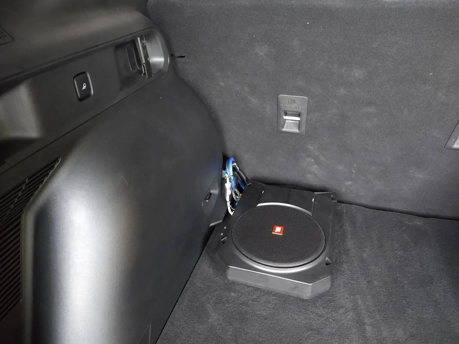

I secured mine in the cargo area with two strips of 2" wide velcro, and it holds quite well. I have to use both hands and my weight to pull it off.
Ford Bronco Sport Installing aftermarket speakers and sub in Bronco Sport! IMG_20210625_080423413
Where did you tap the speaker wire and did you write down the wiring colors by chance? Thanks!
I tapped into the driver side rear speaker. Since I was replacing the speakers also. you won't believe how cheap the factory speakers are. Can't remember the wire colors, they were multicolor if I remember correctly. I followed the wires from the speaker to the center pillar, and from there I tapped into it and ran a length of wire to the Sub.
