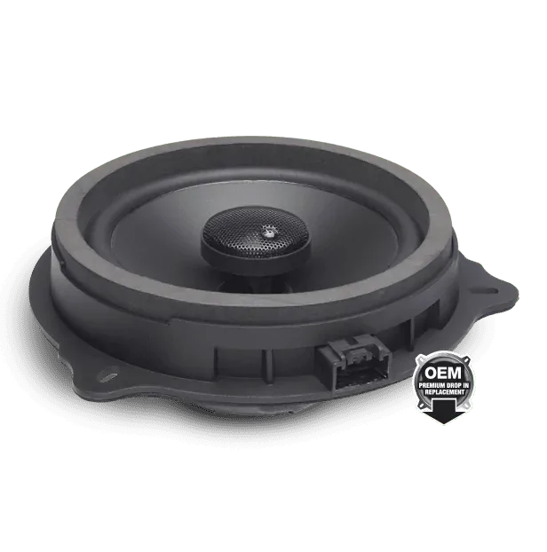

I just ordered 2 pairs of the PowerBass OE652-FD coaxial plug & play speakers for my Badlands. I'm sure they will sound much better than stock. Nice size 10oz magnet and 4ohm :sunglasses:
