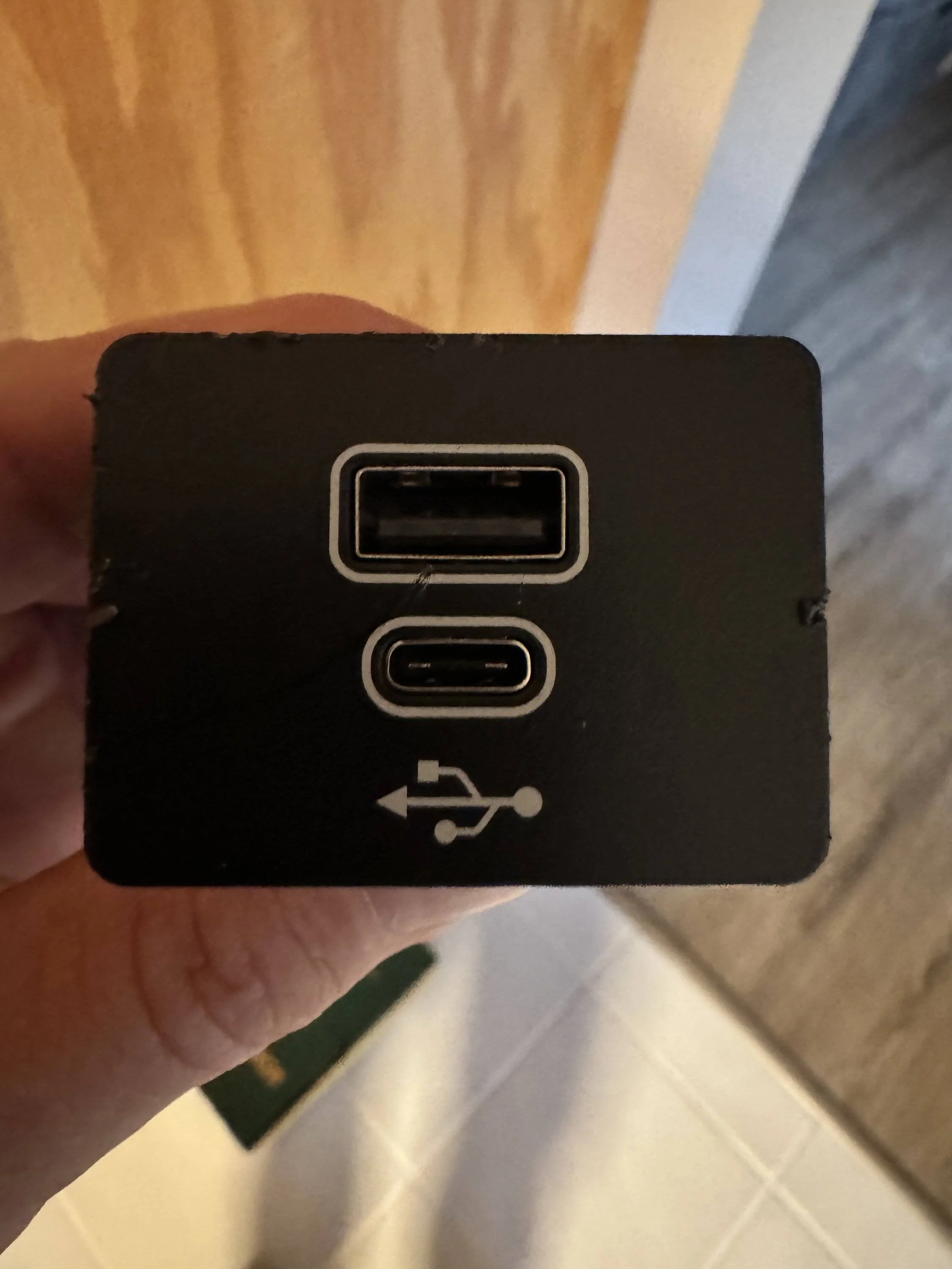

Old port showing white painted ring-

New Module showing translucent ring-
Ford Bronco Sport Illuminated USB Media Port DIY Install IMG_0787

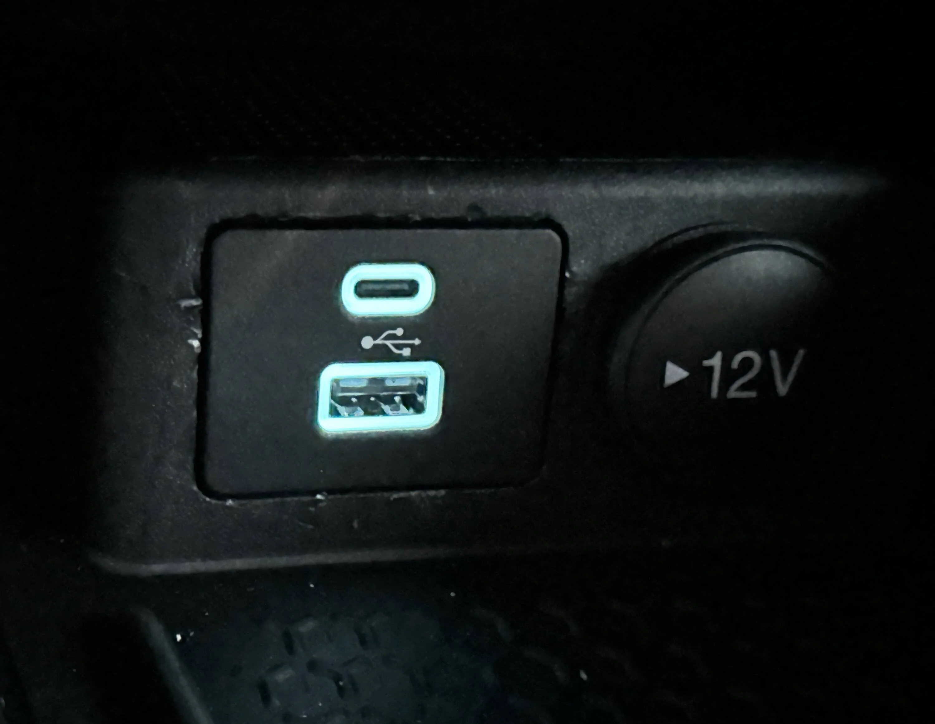

After Install… ENJOY!!!!!!!!-
Ford Bronco Sport Illuminated USB Media Port DIY Install IMG_0786
