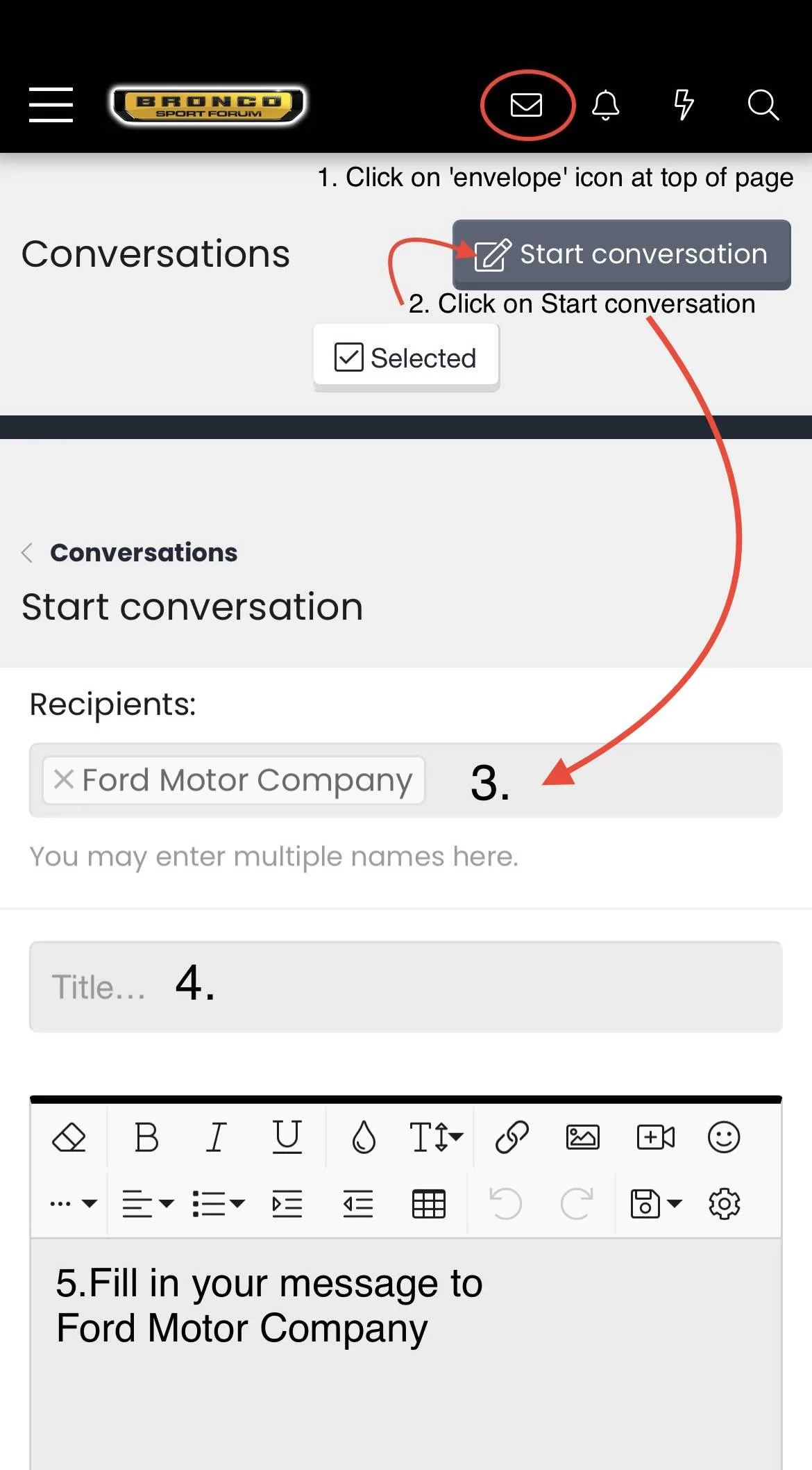

How do I know you’re legit & I’m not somehow getting scammed? ?
They are legit. You need to send them a "start conversation" to continue though.

No scam. It’s the Ford internet representatives. Can be very helpful!
Ford Bronco Sport I dread going up my driveway 1690303253841
Nice job with these instructions. I've been telling them (Ford Motor Company member) they needed to include something like this in every request to help out that they post on.
Maybe they will copy the above and paste it into their signature. At the very least, I'll remember this thread/post #, and cut/paste it to any member that asks how to contact them.
Or it would make for a great stickie thread, if only this site had that option; been asking for that too, and volunteering to monitor that.
