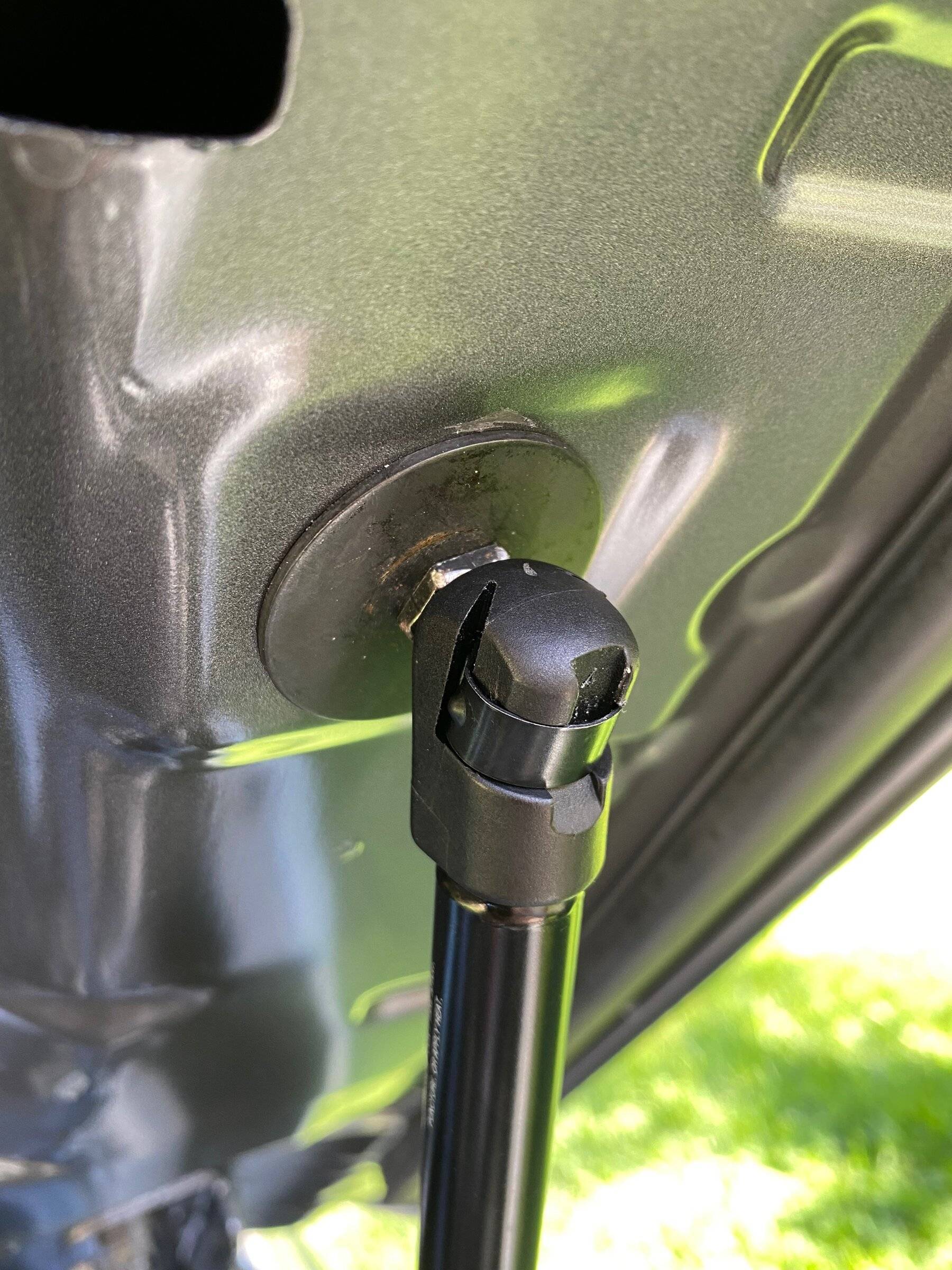

Going to back-pedal my "outstanding" rating...I'll now recommend against them.
When I installed these, I had some trouble aligning the ball connector on the driver side...it fit the rectangular hole, but screw-on nut that wedges the ball connector between an open space in the hood above, and the sheet metal below it, I found just barely wedges itself on the sheet metal...any deviation of its position during the tightening process (which you can't see since because it's on the above side of the hood in a hollowed out space) and it will come out of proper seating.
A few days ago, I heard a "pop" sound come from that area, thought nothing of it, perhaps a rock in the fender well. When I opened the hood, the ball fastener to the hood had worked loose (probably from normal driving vibration), detached from the hood, and the strut was wedged against the fender well (ball and socket joint in tact).
I detached the ball and socket from each other and remounted the ball fastener, this time, watching alignment oh so carefully. All seemed to go well....that is until I started to tighten the ball fastener "nut", which is actually part of the ball piece. The "nut" started to strip and round-off; very soft metal, not a lot of force applied. You can see this if you look closely at the picture. Just FYI, I have excellent quality tools and used the correct socket and wrench per the instructions.
All-in-all, I question the quality now of this kit, and wonder if a failure could hurt someone. I will likely remove mine and I'm sorry that I cannot recommend it now.
Ford Bronco Sport Hood Strut by Redline Tuning Installed IMG_0674
Anyone else have this problem? Is the Elite better?
Wow !!! Mine did the exact same thing as yours, but mine popped out as soon as I tried them after installing them, I just chalked it up to me not tightening the nut enough, I put some more torque into it an so far so good.
