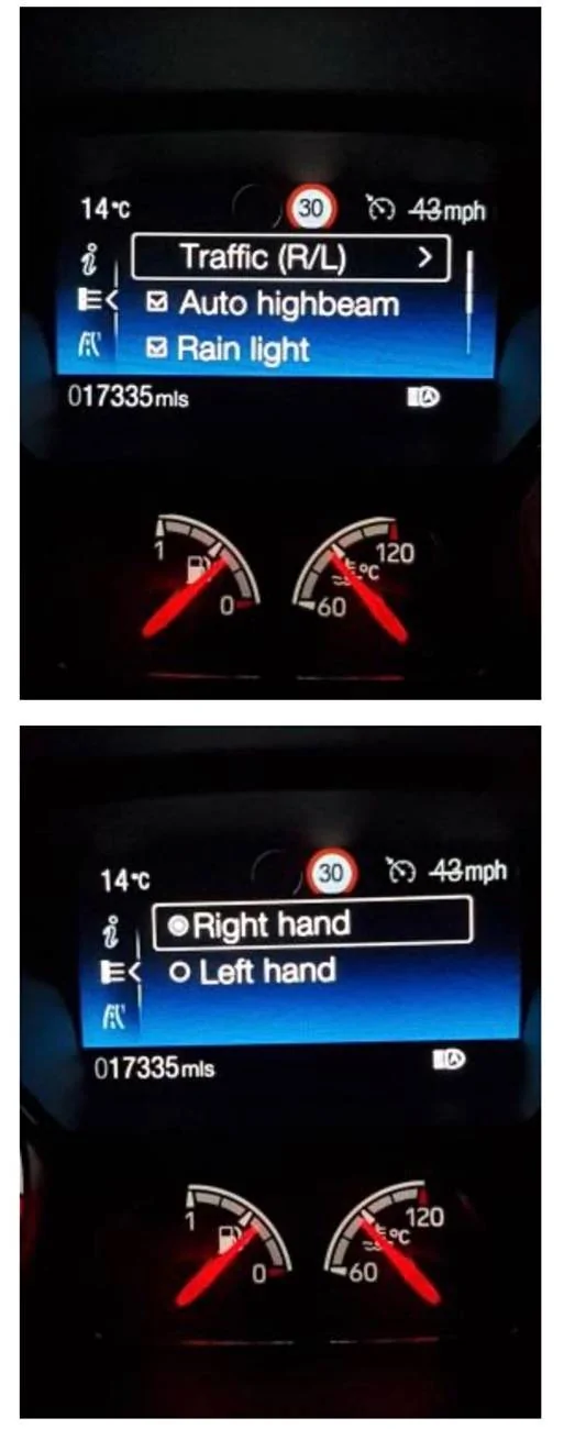

I know some later model Fords also had the ability to switch the beam left and right, as you alluded to…
