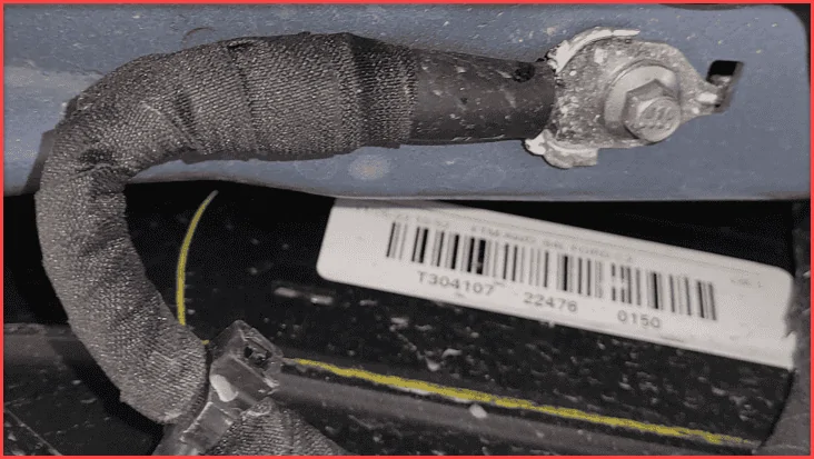

I am running into one concern. Does anyone know what this wire is?
Ford Bronco Sport Go Rhino rock sliders installed on my Bronco Sport 1676056019456
Assuming I'm reading the instructions right, this thing is in the way. Looks like I can loosen the screw move the wire. Do the install and put it back, but before I start playing with my brakes or something, I would like to understand it.
Looks like it is only on the drivers side around the back tire.
Any thoughts/suggestions are appreciated.
That appears to be a ground wire. All electrical devices need a connection to power and to ground. Since the battery's negative terminal is grounded to the chassis manufacturers often ground electrical devices directly to the chassis as well. The chassis itself returns the electrons to the battery's negative side. There shouldn't be any worries with disconnecting it during your slider install. If you're worried about damaging any of the electrical components using it just disconnect your battery first.

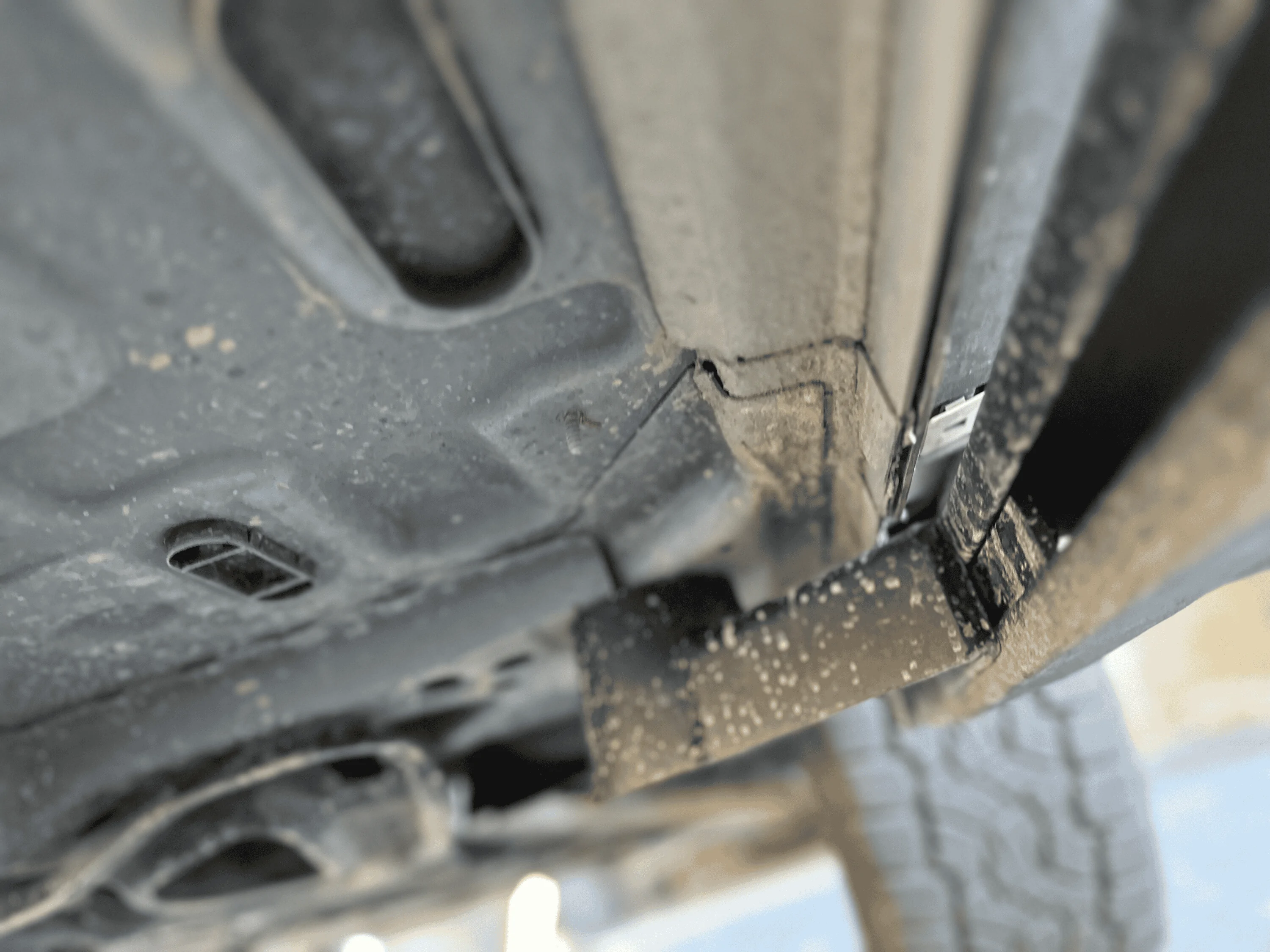

After looking at this over many times. The Go Rhino looks to be below the pinch weld. It looks like the arm goes to the underside and bolts to a point in the unibody frame section. Is is not giving any more clearance than the JCR. And does it actually interact with the pinch weld? It seems not to.
Ford Bronco Sport Go Rhino rock sliders installed on my Bronco Sport 1678550956669
Winds of Change
Sep 12, 2022
53
862
811
Chicagoland
2023 Bronco sport
You’re gonna high center with these by the looks of them. Looks like you lose like 2” of clearance. Hard to tell. Everyone takes potato pics
I've rubbed the high center but never turtled with the jcr setup.
