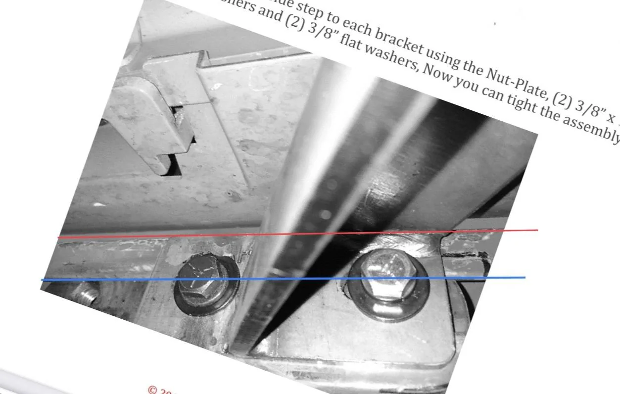

Your pictures make it look like they sit bellow the pinch weld,
But this pic from the instructions makes it look like they clamp it
This is why I asked for detailed information about how they mount. The website advertises "no drill." It appears they use a few holes in the bottom of the unibody that come that way from the factory but I only see two attach points. If that's the case what prevents the thing from bending in the middle?

Following the PDF those round brackets bolt into existing holes on the underbody. Then bolt on the side step to those brackets. Looks like they are floating below the pinch welds. No drilling.

This shot has it clamped, blue is bottom of the rocker pinch-weld, red is top of the bracket and presumably roughly the top of the slider. Weird angle, but the bolts seem to be right up against the pinch-weld​

The instructions seems extremely minimal, and don’t mention this
If it clamps to the pinch weld it seems like it's only on the ends where the brackets are installed, the center is unsupported. But the rails seem beefy enough for a bronco sport. Yeah the directions are a bit crap.

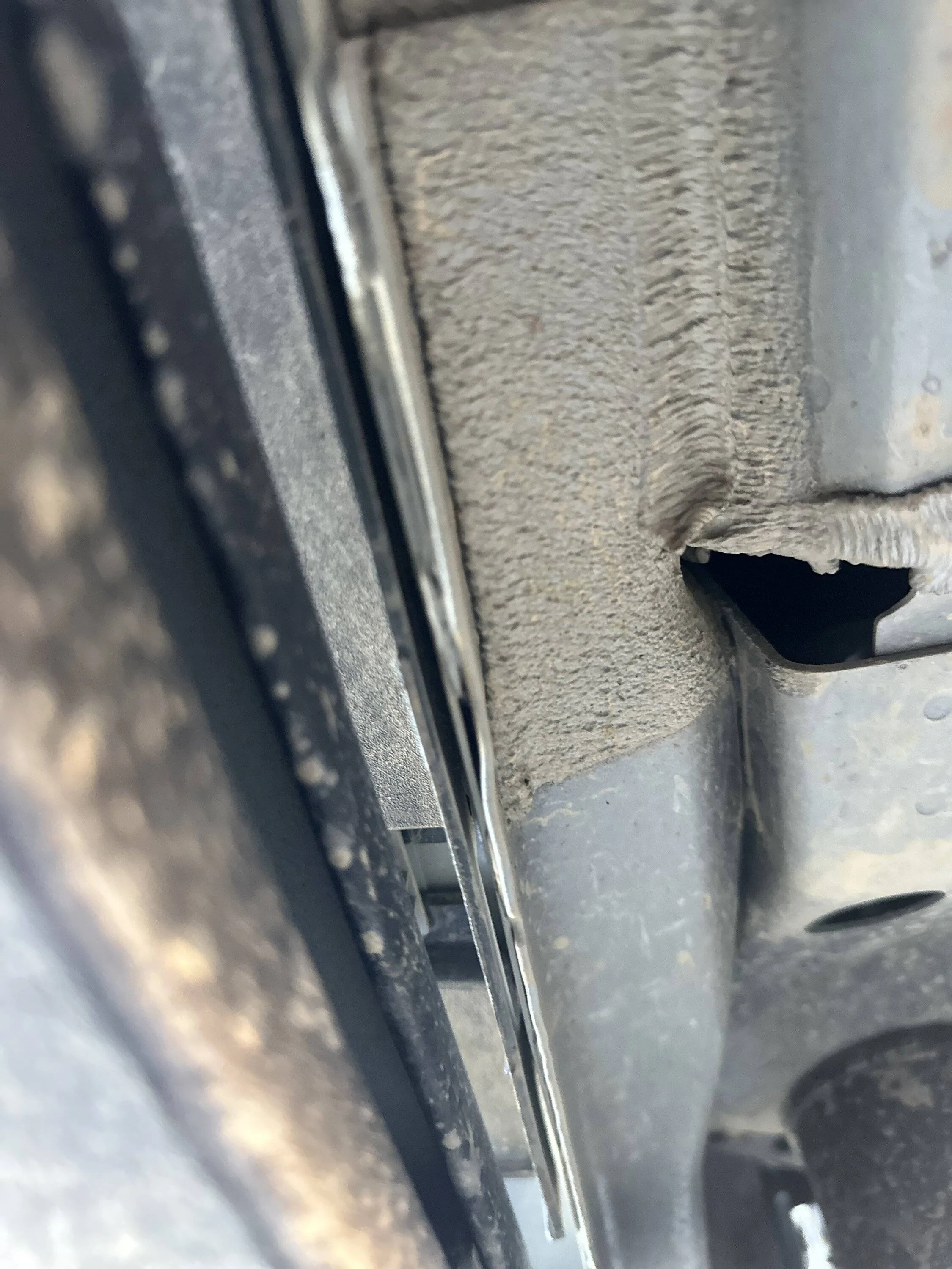

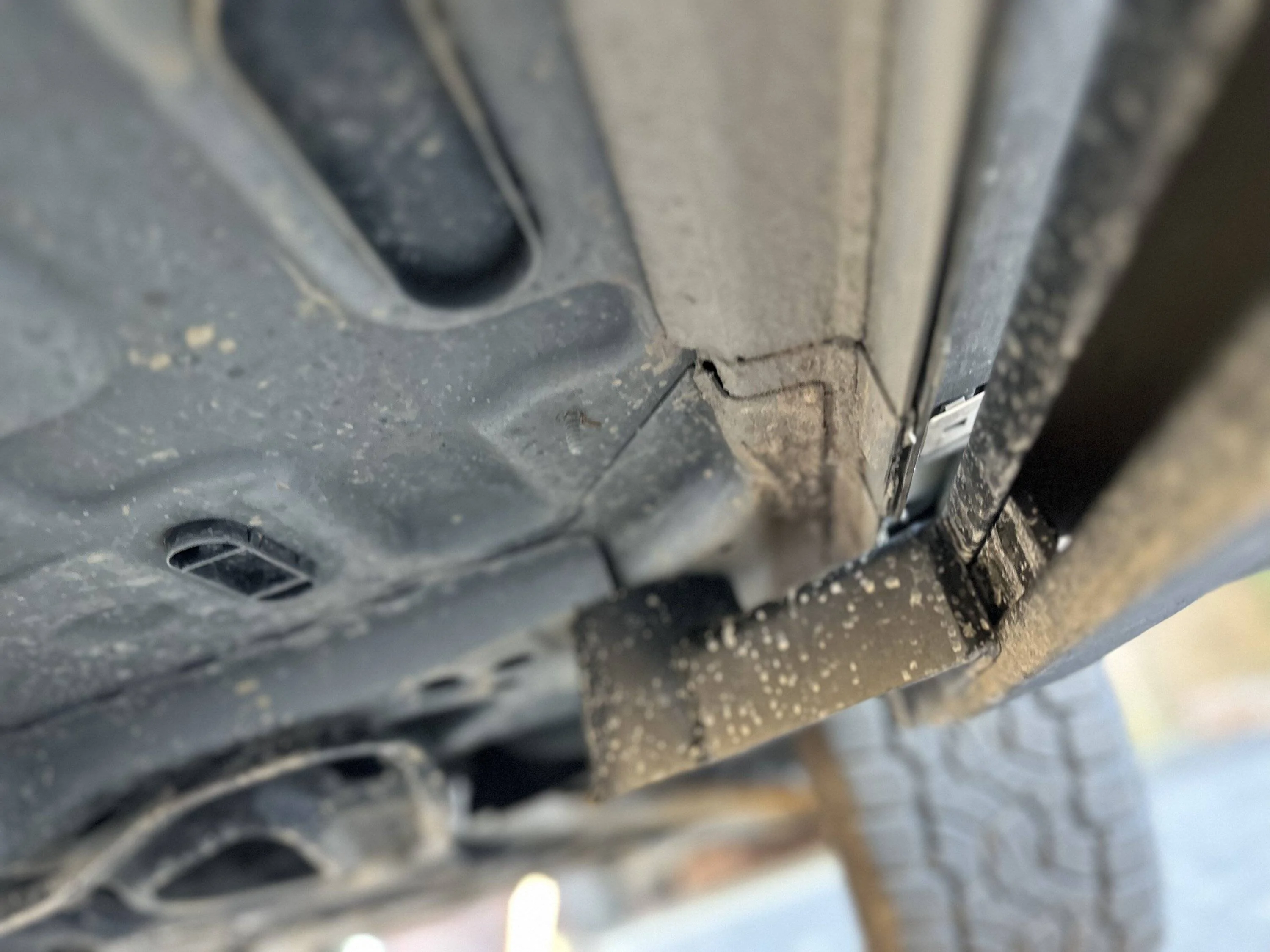

Here is what it looks like underneath it seems pretty solid even though it is attached at 2 points
Ford Bronco Sport Go Rhino rock sliders installed on my Bronco Sport 4343E58A-9D6B-476B-9F25-C1EEDA1DE775
Ford Bronco Sport Go Rhino rock sliders installed on my Bronco Sport 860BBCEF-11D7-47FC-B37E-EA71DC3AB2FD
Blue oval fan
Nick
Sep 8, 2022
270
384
Greenville, SC
22 Bronco Sport
I'm sure for the application they will be just fine. The BS is not a rock crawler. These will reduce the chances of body damage for sure. I personally wouldn't be smacking these things intentionally. I would be worried about the bolt/bracket failing before the slider itself bends. But having said that with only two mounting points and how it's attached, these seem to be more of a step than a slider.
