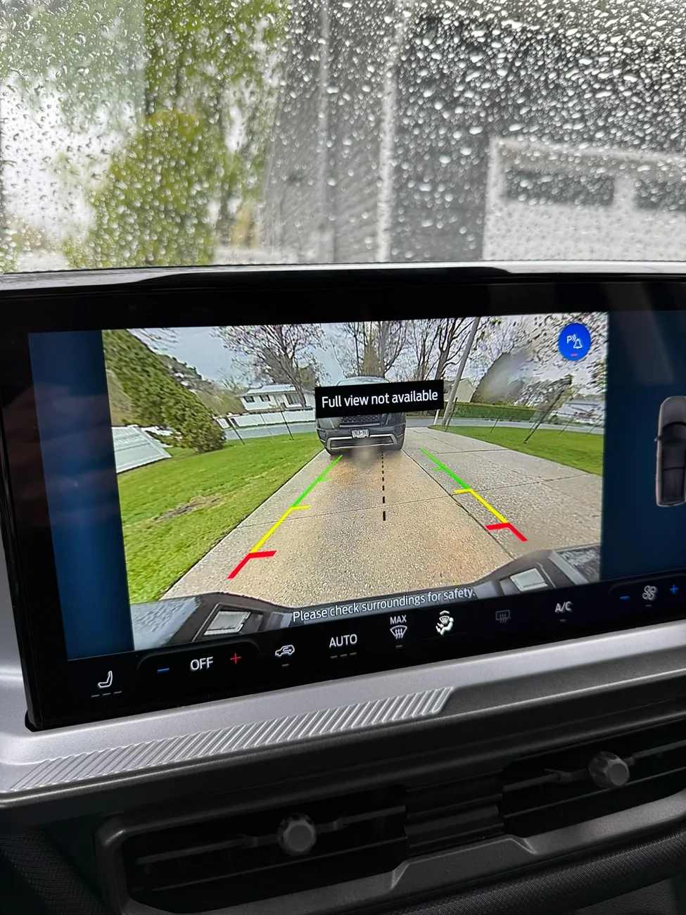

Will they remove that banner on Forscan at the dealership? I don't want to have to buy a Windows laptop and the software just to get rid of that stupid banner.
Thanks,
No, the dealer does not use FORScan. They use FDRS and there is no way to do that with FDRS.
I also would like someone to try it to make sure it works on these vehicles. I don't see why it wouldn't, but I would still like for someone to try it first.

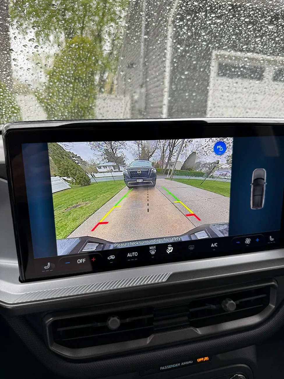

confirmed that this works on 2025+ APIM 720-02-02. Before:
After:
Good. That black box there is one of the most ridiculous things I have ever seen on a vehicle.

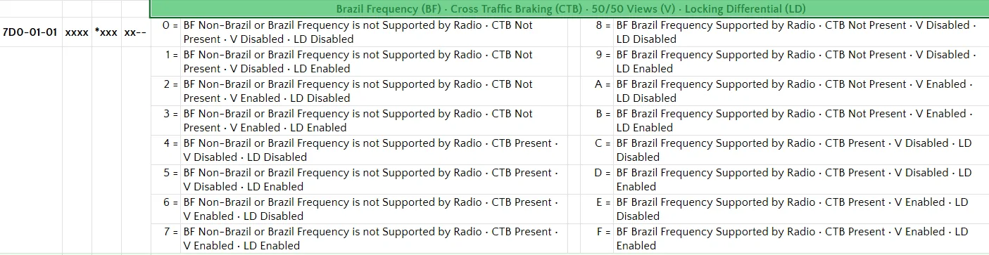

also related to the rear camera - this appears to have worked, and i can turn on the rear camera while driving:
7D0-01-04xxxxx*xxxx--
9 = RCODVS Enabled • HVS Disabled • PD Disabled • OVS Enabled
Ford Bronco Sport Full view not available (rear view camera) 1777171010578-kc
I’m trying to figure out what you changed in this block of coding? I have a 9… but what did you change it to?
Ford Bronco Sport Full view not available (rear view camera) IMG_5529
After:
Ford Bronco Sport Full view not available (rear view camera) IMG_5530
Also, can confirm this works. Had a little time to mess around with a few things tonight. 😊
sorry, i didn't document that well - i had 0 initially.
EDIT: I see you added the RCOD w/o Blackbox set. maybe it will work now that both options are set? I believe that's all that remains in my settings that i changed.

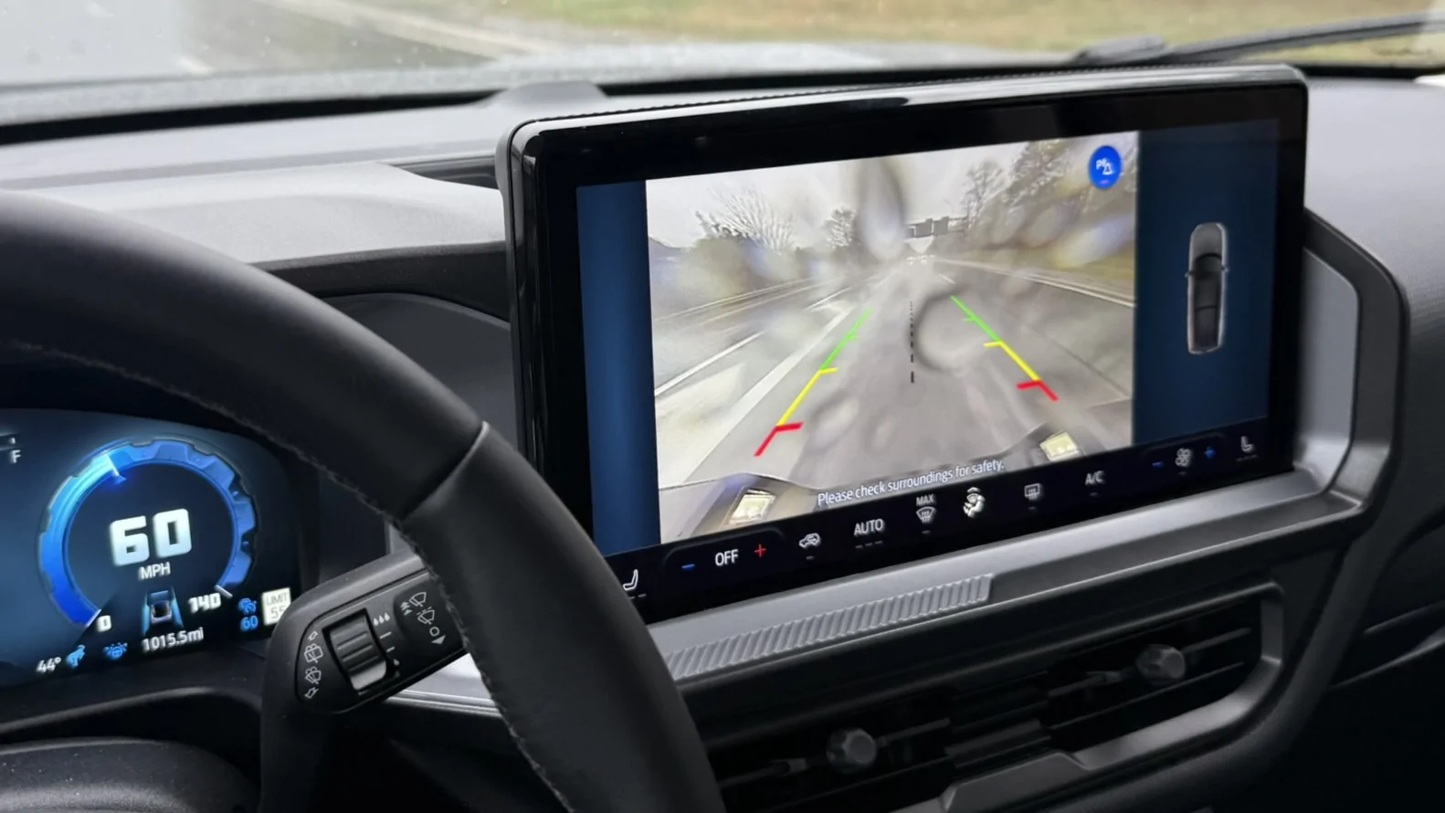

Interesting. To get this to work on the F150, it also required enabling cameras at speed in the IPMA. There's a 50/50 split view that can be enabled that's pretty cool, too.
Correction: It is already enabled in the IPMA on the trucks. Enabling cameras at speed in the IPMA was to fix an issue caused by an OTA for some trucks.

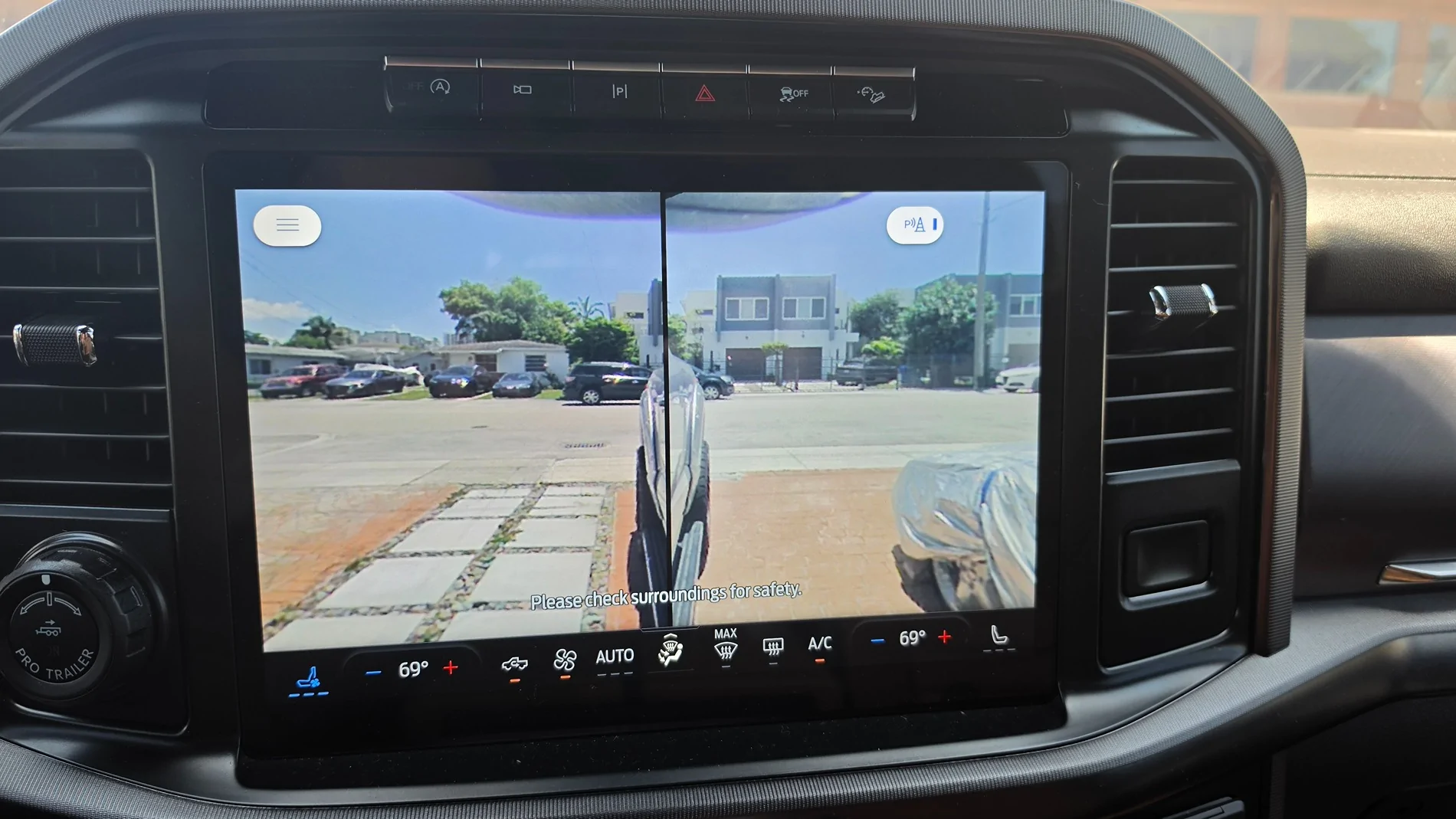

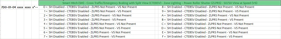

Also make this change to be able to use 50/50 view at speed:
Ford Bronco Sport Full view not available (rear view camera) 1777322025786-k7
Edit: This is what it looks like. Not sure how it would render in the wide horizontal screen, though.
