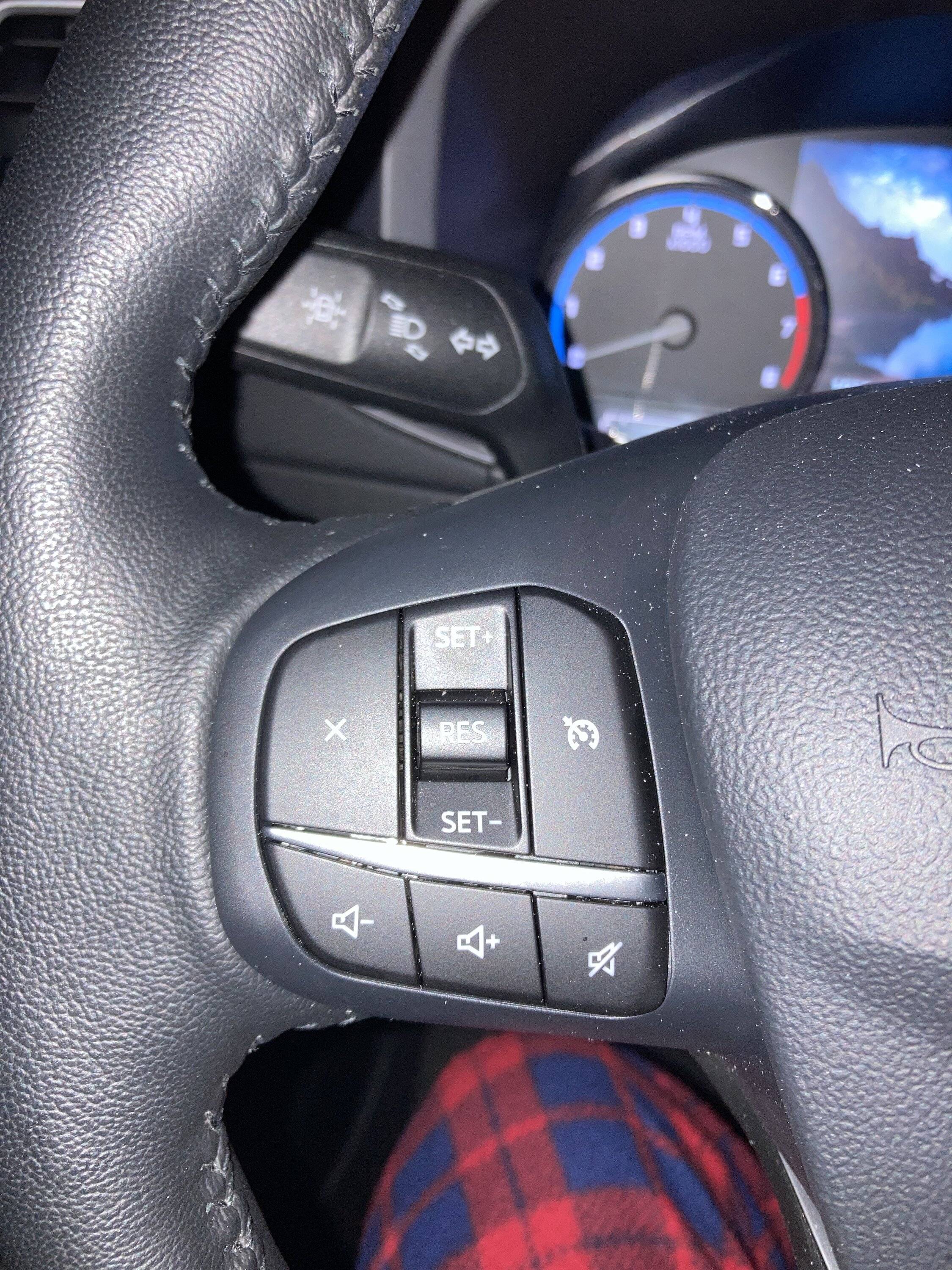

Do your controls on the left side of the steering wheel look like this ?

No, my steering controls look different.

No, see pic.
You do not have lane centering. You have lane keeping.
Lane centering is only available with Ford Co-Pilot360™ Assist+
Lane centering along adaptive cruise control will give you a form of self driving.
Lane keeping will just bounce you back and forth trying to keep you in a marked lane.
The reason I asked, your vehicle has vacuum assist power brakes. Ford issued a recall because if the power brake assist were to fail, the driver may not be able to stop the vehicle in a predetermined distance. The front brake pads were changed out to offer additional friction when applying. The result is more brake dust.
Vehicles with Ford Co-Pilot360™ Assist+ have an electric brake assist. Vehicles with this unit were never recalled for brake issues.
