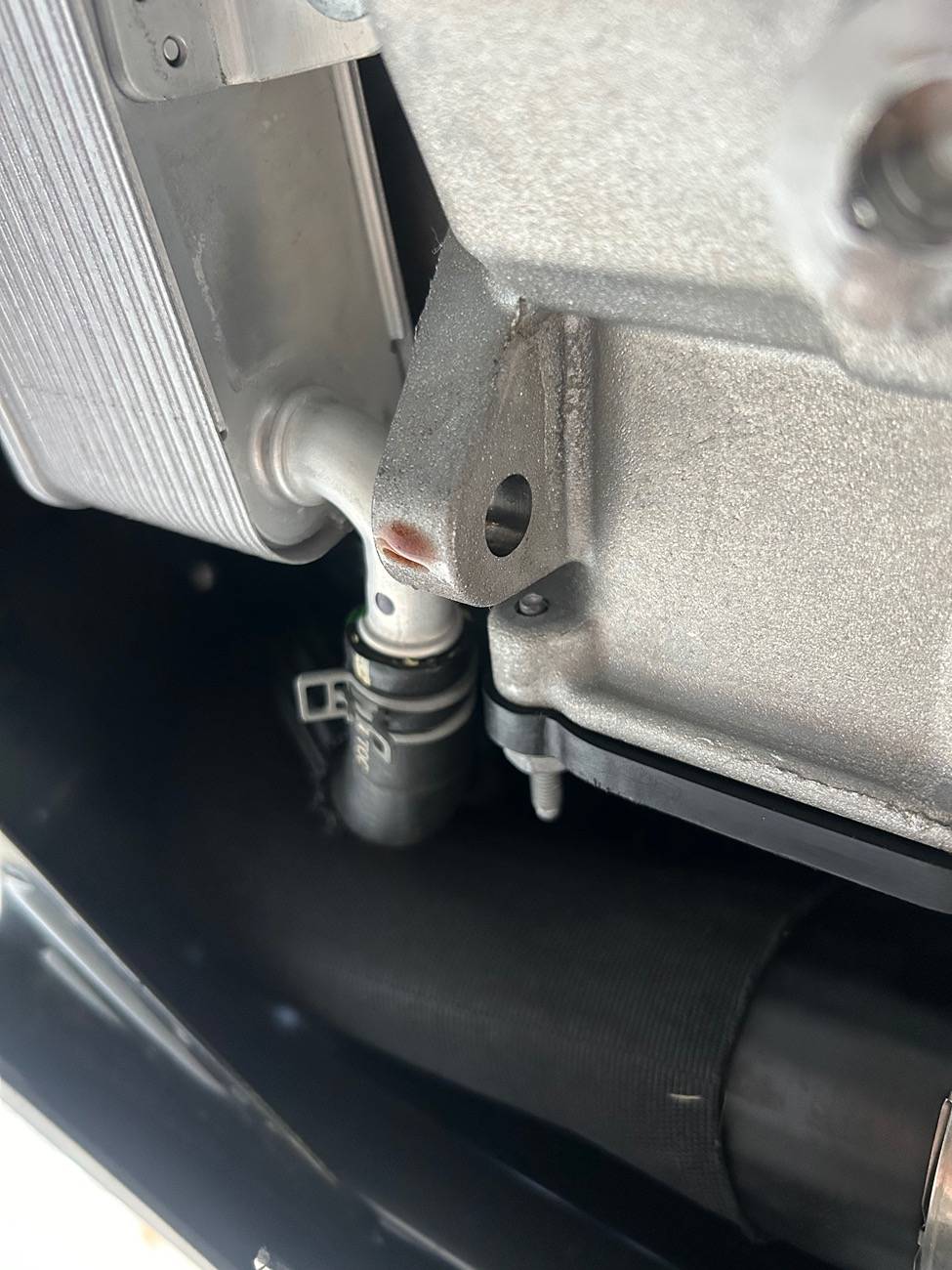

So water pump went out. Ford is going to replace it but part is on back order.
The pic below. We have wiped the residue multiple times but it keeps coming back. The dealership hasn’t found the cause. Anyone come across this issue?

Transmission tech found source of transmission leak. He found that the transmission case was POROUS. For you all who don’t know what that means.
A "porous transmission case" refers to a situation where the metal casing of a transmission has small holes or voids within it, allowing transmission fluid to leak out due to the material not being completely solid, often caused by imperfections in the casting process during manufacturing; this is considered a significant issue as it can lead to fluid loss and potential transmission damage if left unaddressed.
I don’t know if there is a thread for this issue, but if you have the opportunity I would go and check your vehicle.

What did your dealership offer as a solution to that possible potential significant issue?

Hopefully their techs know what they're doing! I would think it would be more cost effective to swap out an entire transmission vice disassembly and reassembly with a new case. New seals, shaft end play settings, other clearances etc. Cheers!

It might be just one part of the case that's leaking. If that part can be easily replaced it might make sense.
