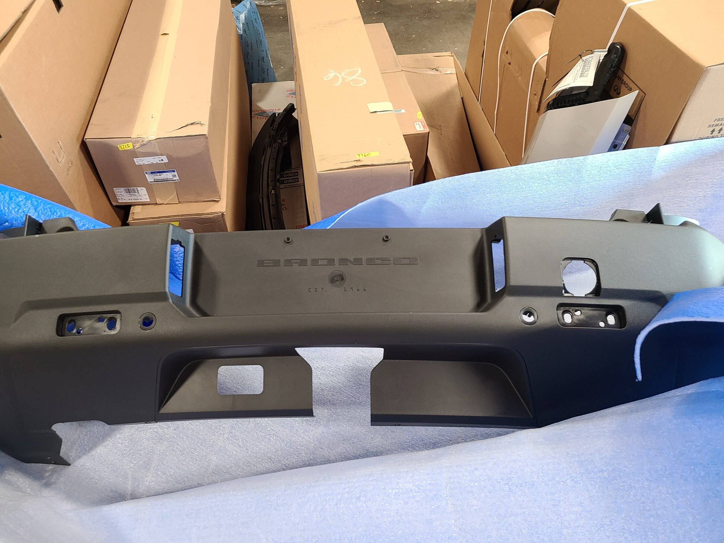

Show them a picture of this:
Ford Bronco Sport Factory Bumper With OEM Trailer Hitch Cuts s-l1600-
And tell them that the part number is M1PZ-17906-SC - Request to have them look up the part and call another dealership that has the part in stock and have that dealership send some photos.
I have this part sitting at my local body shop waitting for the hitch to arrive to install it all. Absolutely no cuts needed. With any luck I'll have the hitch around the end of the month if the vendors are right.

Dude, I contacted no less than three dealerships and they all said the same thing. It's not a conspiracy. They all said somewhere in their system Ford is telling them to cut/drill the bumper for the towing package even on the bumper ending in SC. I'm currently looking for the right bumper as I've got the wiring harness and OEM trailer hitch on order so why would I make up such a story?
They are all saying the bumper with the cutouts FROM THE FACTORY is M1PZ17906SBPTM , but maybe because a lack of supplies, is now going to M1PZ17906SC, which requires the hitch cutouts to be cut.
Ford Bronco Sport Factory Bumper With OEM Trailer Hitch Cuts 20211207_143306
Ford Bronco Sport Factory Bumper With OEM Trailer Hitch Cuts 20211207_142058
Ford Bronco Sport Factory Bumper With OEM Trailer Hitch Cuts 20211207_142022
Please excuse the upside down image I was in a bit of a hurry. So I'll just say it again. The information in FMCdealer where they're pulling up the parts catalog information is wrong. It shows the same thing for all the bumper part numbers. And this step is key, they need to call a dealership with the part in stock and have them take a photo so your dealership can understand that there are no cuts needed.

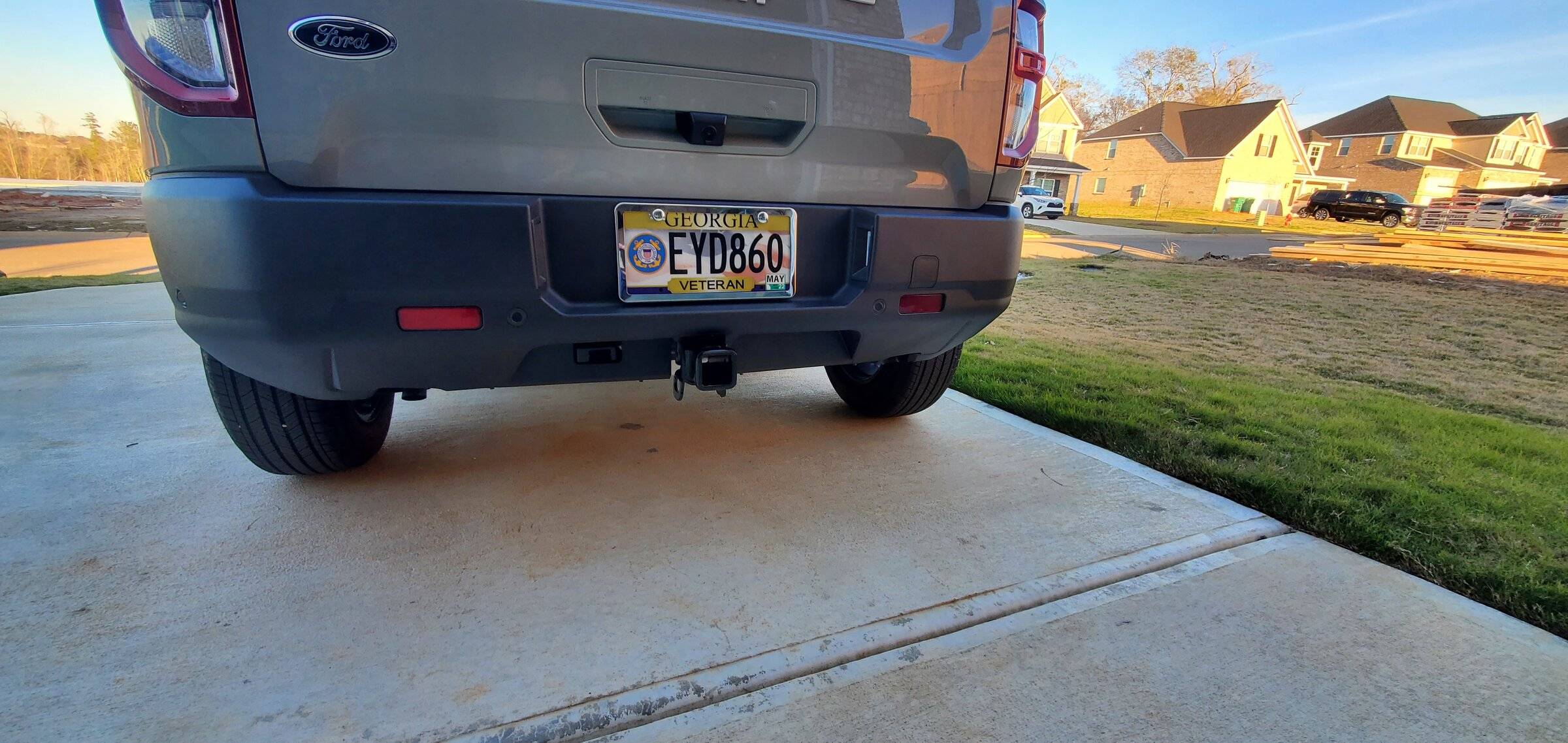

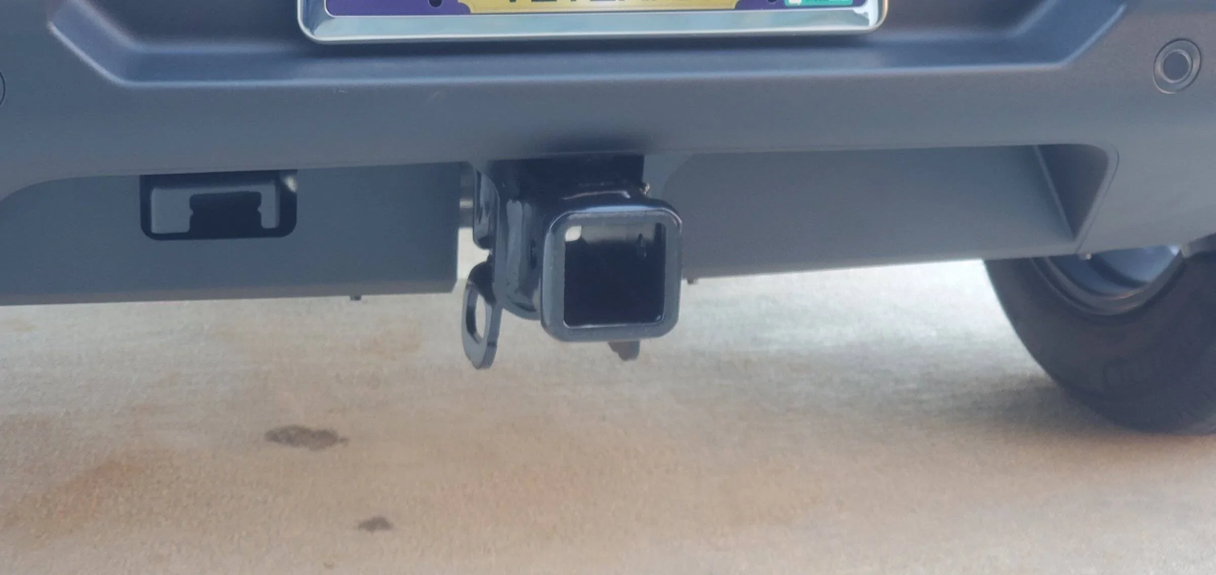

Here to revive an old-ish thread.
I replaced my non-trailer hitch bumper for one I ordered thanks to vxarctic along with the OEM trailer hitch. Not too hard but I definitely recommend putting aside at least a good three hours. I did it after work at 2 p.m. and was careful but wasn't taking my time as if I started at 9 a.m. on a Saturday. That's not including any time I need to devote to wiring up the 4-pin Ford kit.
For anyone thinking of doing it: YOU WILL BREAK THE GROMMETS FOR THE BLACK-TEXTURED FENDER 'FLARES'. Those things were on there as tight as can be and I only had 1500 miles so even when I pulled it to grab the sole screw some of the grommets broke. In the end, the remaining still hold pretty well but keep that in mind.
Hit me up with any questions.
Ford Bronco Sport Factory Bumper With OEM Trailer Hitch Cuts 20220110_165919
Ford Bronco Sport Factory Bumper With OEM Trailer Hitch Cuts 20220110_165913
