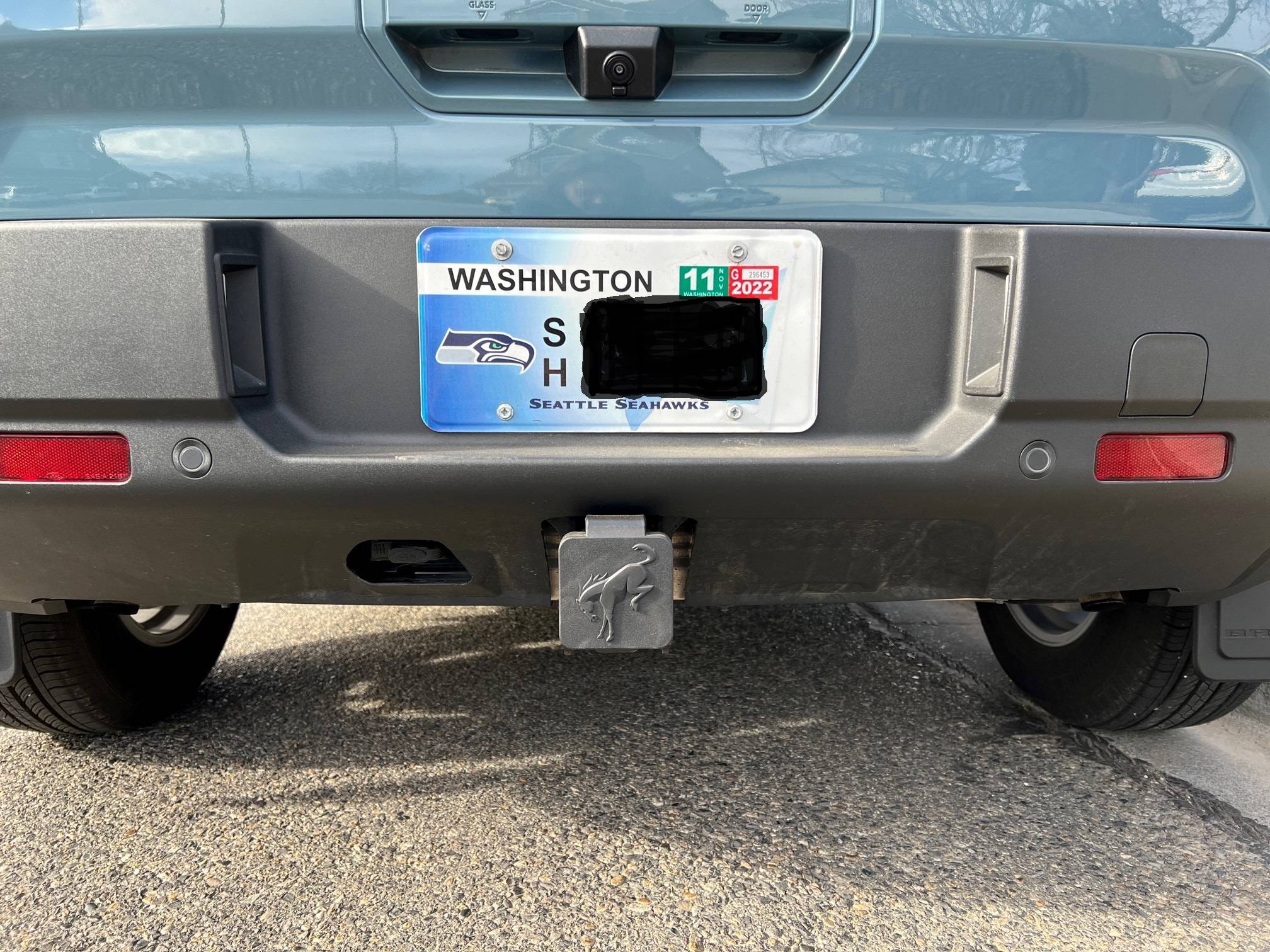

Where is the tail light plug? I had my dealer install mine and it looks like the plug is in the factory location but they cut a hole in the bumper so I can access it.
Do you have a pic of your 4 pin plug? I have been through all these hitch threads and no one seems to have it installed in the bumper (other than those that replaced their bumper cover).
Ford Bronco Sport Factory Bumper With OEM Trailer Hitch Cuts hitch2
My apologies for delayed response. I hadn't installed the wiring kit at the time of taking this picture, but I have it installed now. I used my CNC machine to make a bracket to hold the plug itself. I'll be honest, the wiring kit wasn't for the feint of heart. You definitely need a trim removal kit for that.
As for the arch wheel molding clips... On the passenger side, I'm pretty certain I broke all of them. But I still couldn't get it off! So, I just left the sucker on there.
