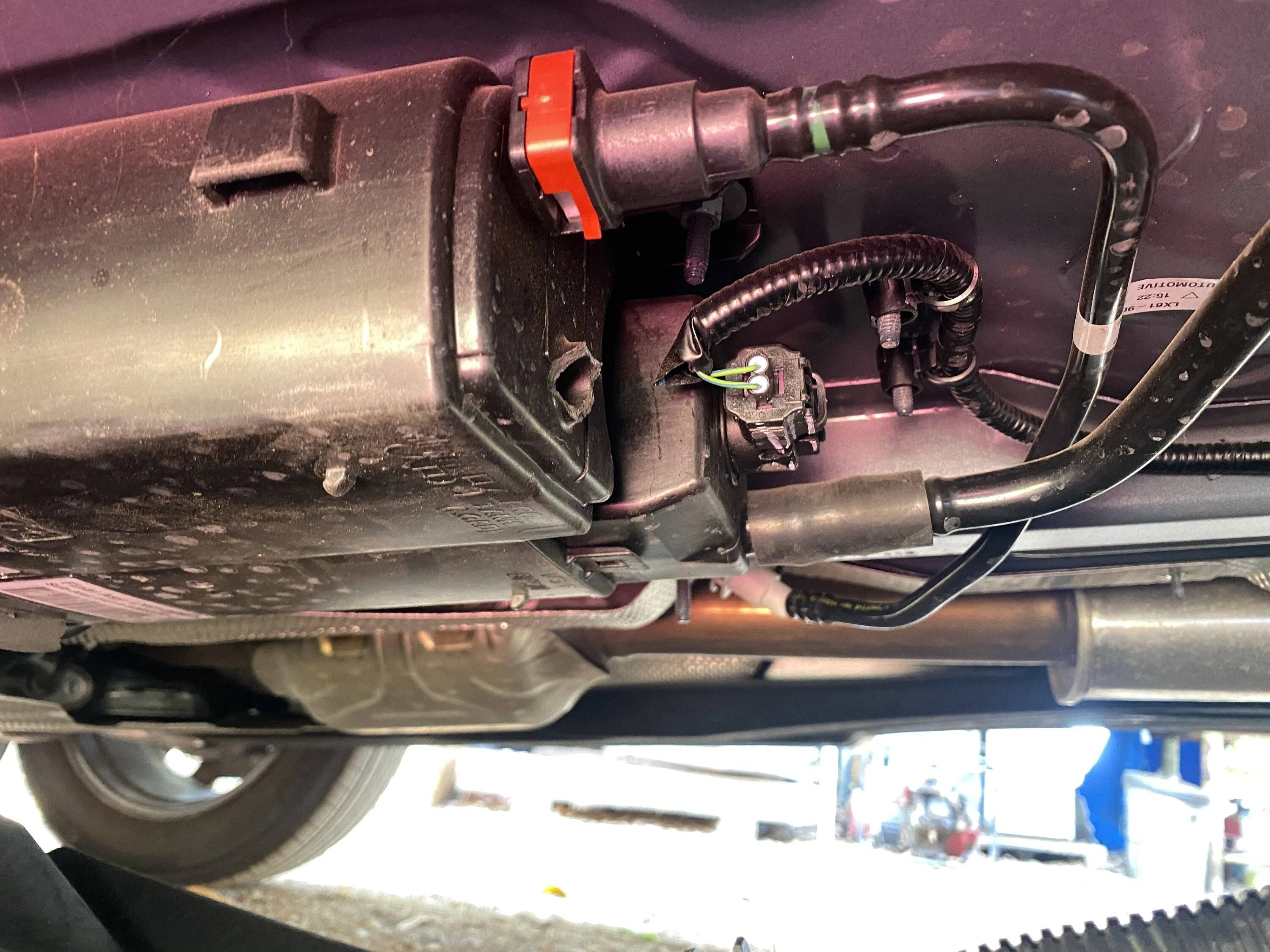

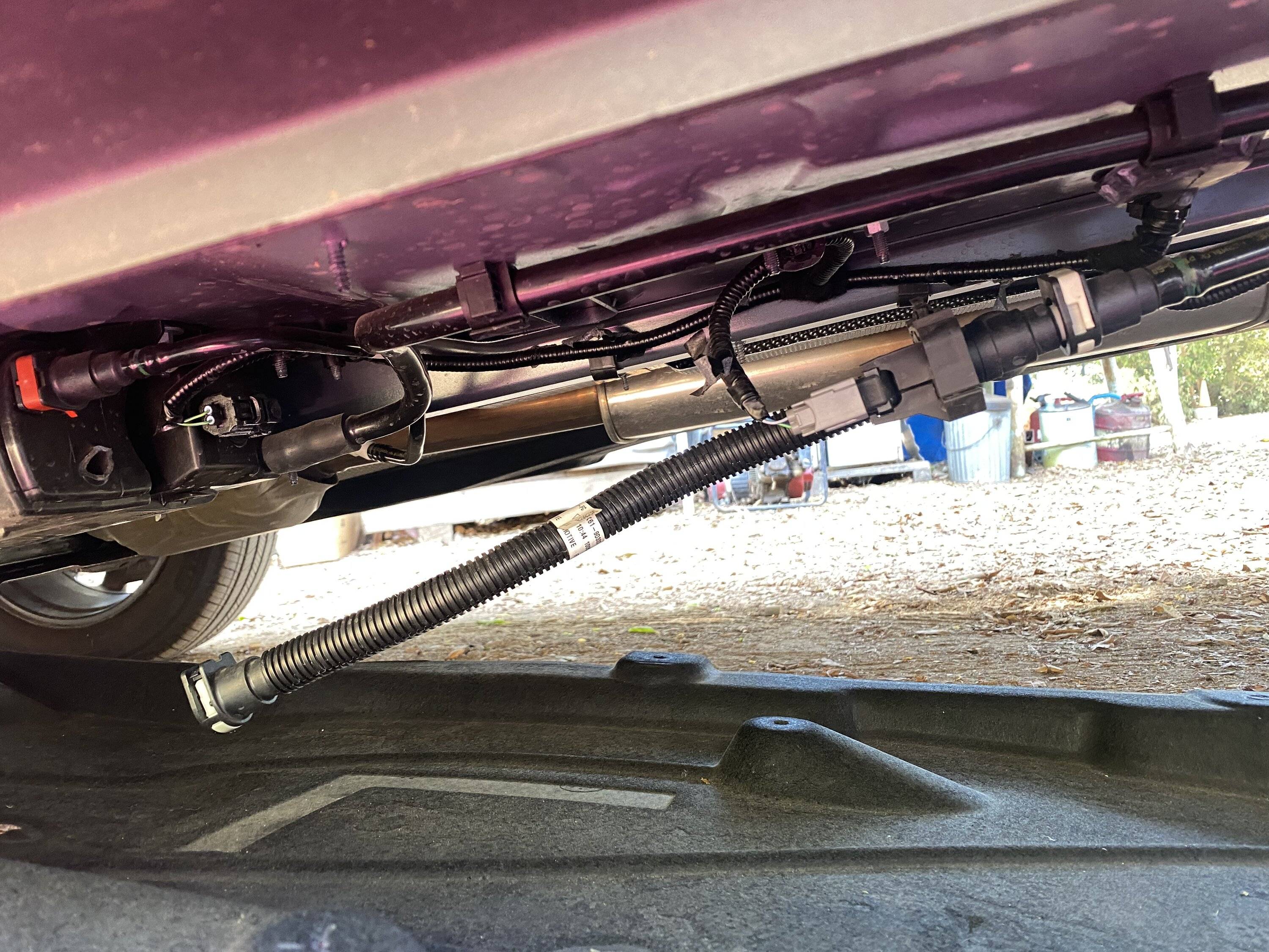

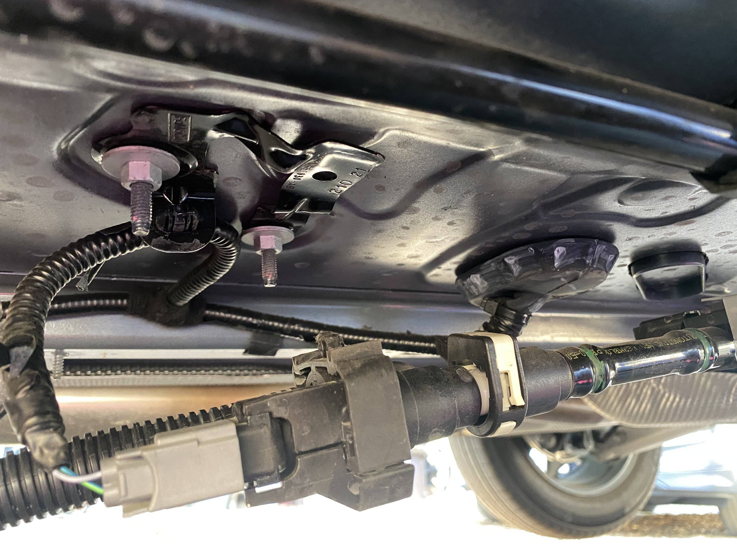

My check engine light came on the other day as well for small evap leak I don’t Ever remember hitting anything pulled the under body panel off and found this There was no damage to The underbody liner what I think happened Is the evap solenoid control valve shown in the picture came loose from it to mount and it put pressure on the fitting on the charcoal canister and broke it off my bronco only has 2500 miles on it bad design all the way around

The whole setup is cheap plastic on the evap. Is easy to replace at least. Just unplug all the connectors and then swap the evap and plug back in. Problem is there’s no place to move it since the bottoms all flat underneath. Unlike with solid rear axle vehicles where the pumpkin sits lower and evap can get tucked up higher to the tub. Even my badlands that has the evap skid still has all the lines exposed. Gonna be worse in winter with ford’s use of cheap brittle plastic as people go over snow berms etc. Seen quite a few people on here and other forums who’ve broken these.

Oh yeah. It looks like a lot, but they are really easy. If you can connect a refrigerator ice water line, you can replace an EVAP. Typically they are held in with just a few bolts and slide onto a frame piece. You have to work out the various connectors for the electric on the purge solenoid and the lines. Based on the picture above, you'd push or pull the retaining clip and then yank the connector off a plastic nipple. They have an O-ring to seal it. There are also specialty tools to help but I've never needed them. These are all vapor lines so it may smell of gasoline, but it is just vapor and not running from the tank. Be appropriately safe. You need to connect them fully and firmly to avoid any sort of vacuum leak or it will throw a code. Push hard till it clicks on.

To me , it looks like something hit it & broke the line 's Fitting & its attachment point . You may or may not see any damage to that fabric cover . As said , it needs better protection over that area .

I hit a rock and knocked the canister off of its mount and ripped the wires out of the connector. Canister is held in by 3 studs. The 2 front mounts are slotted and 1 rear is not slotted. The rear stud was ripped out. Installed a nutsert (riv nut) to replace the stud. Soldered the wires back on the connector. Used tyraps and rtv to stitch the cover back together. Reset check engine light. Back on the road. Rock Auto has the canister for less than $200.
