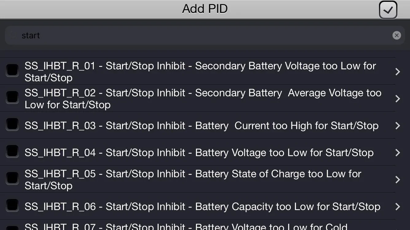

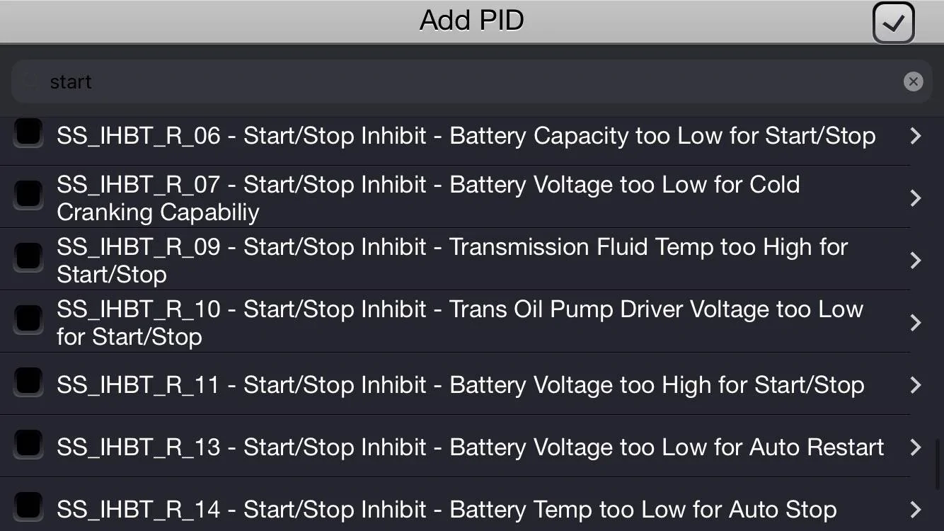

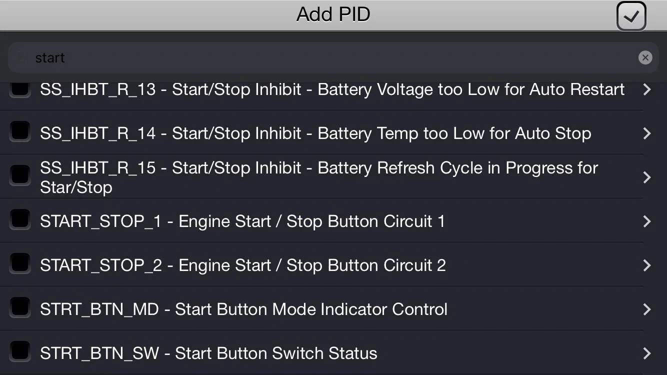

IIRC there's something like 15 or so parameters which, depending on their state, could "prevent" auto-stop/auto-start from occurring. Not sure how many are user modifiable via simple changes (mechanical that is since we're talking about non-FORScan based options), but perhaps there's one that has less of an impact on the rest of the vehicles systems.
Ideally you'd want something that is a zero-impact change, no added risk to system reliability, no impact to drivability, etc… that can be reverted / backed-out if you need to, later.
On my end, it's the 30 minute idle shutdown default state (timer always enabled at every engine-startup) that drives me batty, not at-intersection auto-stop/auto-start. For safety reasons, my vehicle might be idling for longer than that, so I have to explicitly check/disable that timer frequently. Not being able to disable it •at all• would have been a deal-breaker on purchase.
Ford Bronco Sport Disabled auto start/stop with Forscan IMG_7472
Ford Bronco Sport Disabled auto start/stop with Forscan IMG_7473
Ford Bronco Sport Disabled auto start/stop with Forscan IMG_7474
Low-rent, but a quick screenshot of the 15 Start/Stop Inhibit factors from FORScan Lite on a cell phone.
I think lying about Secondary Battery Average Voltage is the only one that is low-impact, •ASSUMING• that the "Secondary Battery" is the pack for non-existent Bronco Sport Hybrid powertrain. As to how one actually accesses that input from a location a human can reach.... dunno.
Secondary batttery is probably there to help keep things powered during auto stops (headlights, cabin fan, radio, etc).
I'd like to think that (who doesn't wish for dual battery banks?), but where is that battery, then?
The current-shunt on the main (starter) battery reads ~ -23A net-flow during an auto-stop with HVAC fans running, daytime. (so DRLs + brake-lights only).
