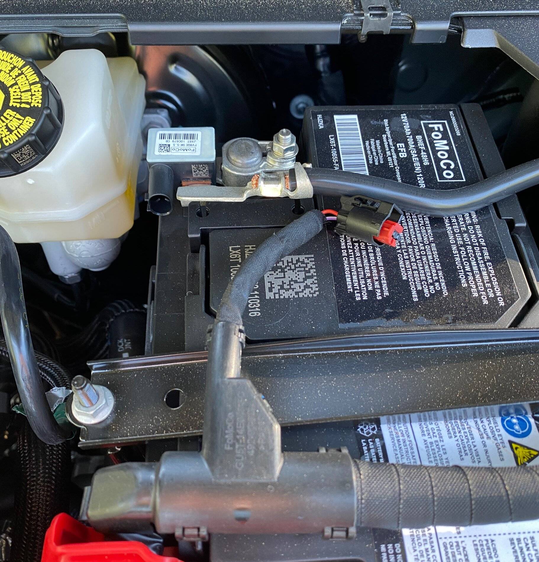

I just unplugged this terminal from the negative side of the battery post on my OB. Auto Start/Stop disabled. I haven't noticed anything else being affected. I'll tape it up to keep it clean, and will watch for adverse reactions as well.

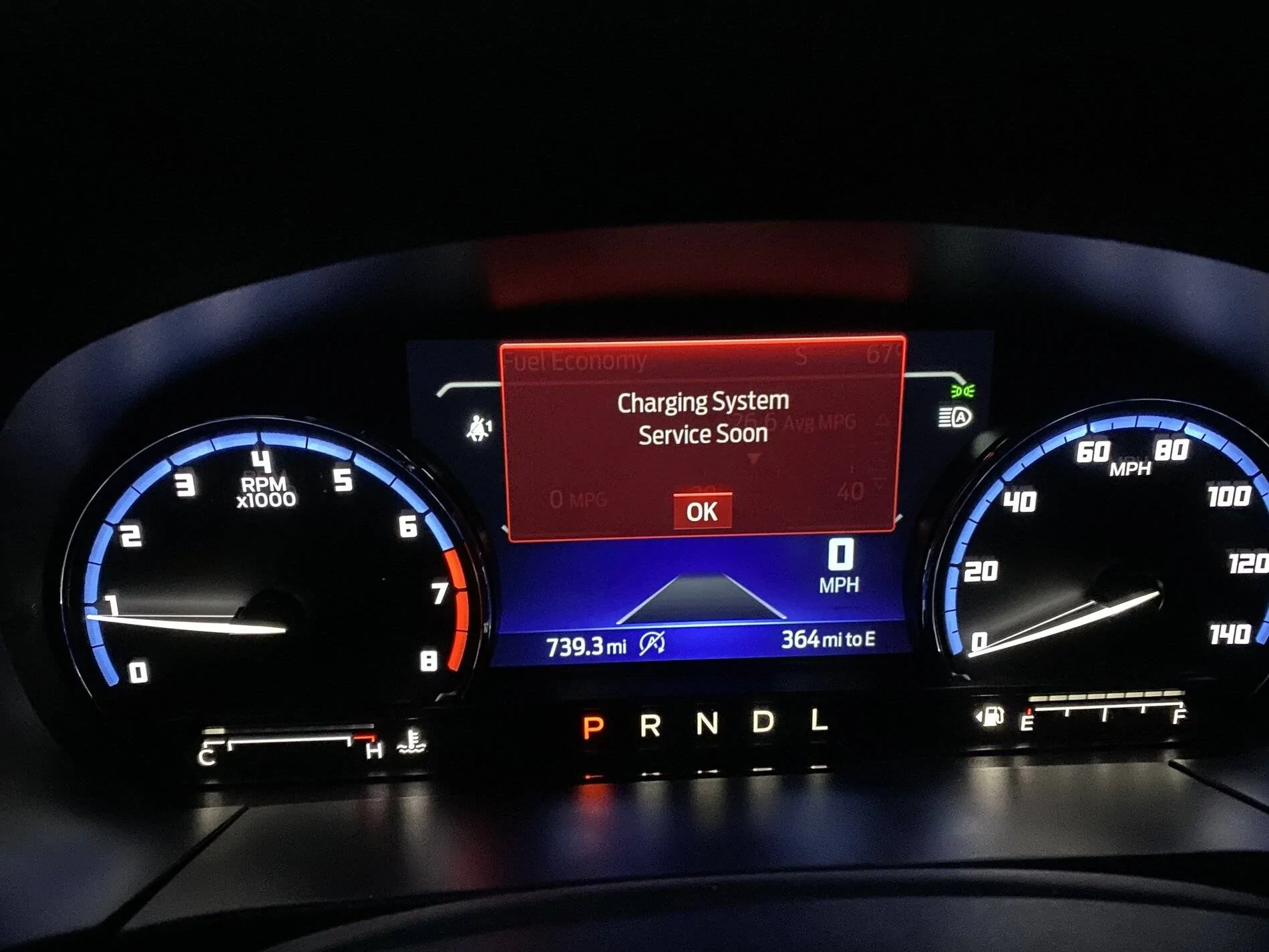

Update: I get this message each time I start, but I haven't seen anything affected. Maybe the alternator will keep working. It's annoying, but so is my engine cutting off at a traffic light.
Ford Bronco Sport Disabled auto start/stop with Forscan IMG_4846.JPG
I'm fairly certain that's the current-shunt used for measuring current flow to/from the battery. That's a pretty draconian method of disabling auto-start/auto-stop subsystem on a heavily computerized vehicle.
The BCM uses that current-shunt's data as part of determining recharge strategy for the battery (alternator output control) among other things.
