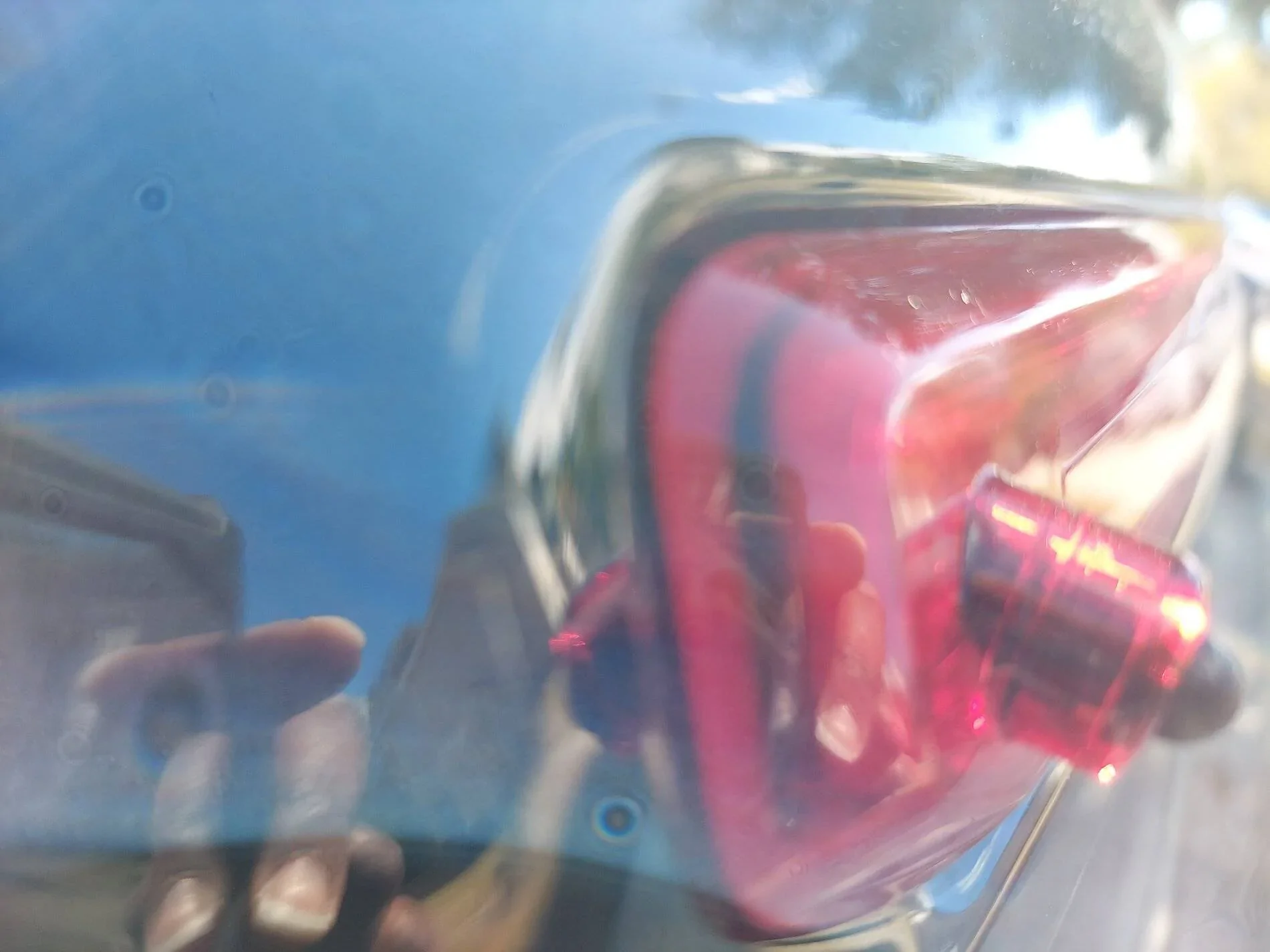

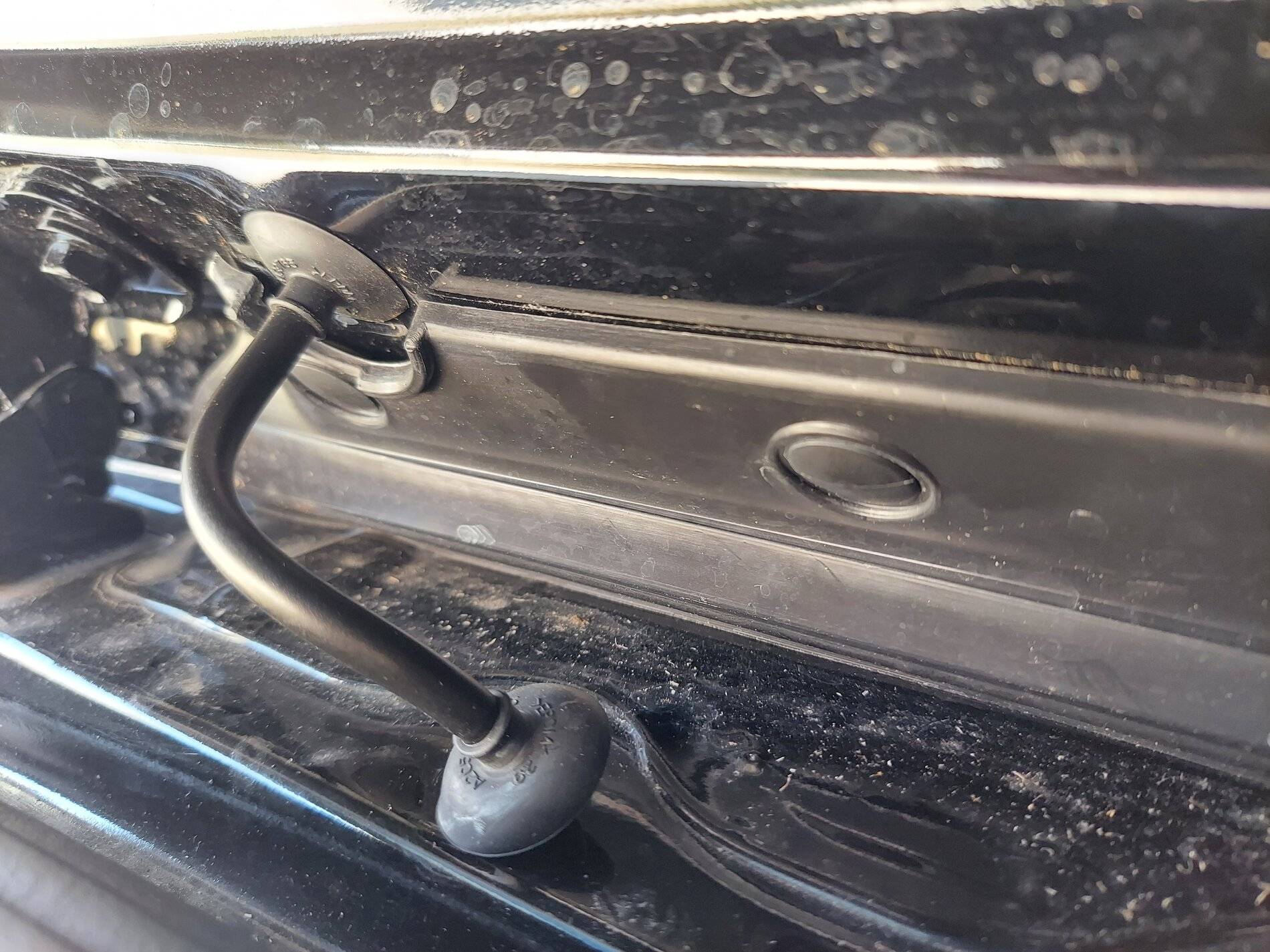

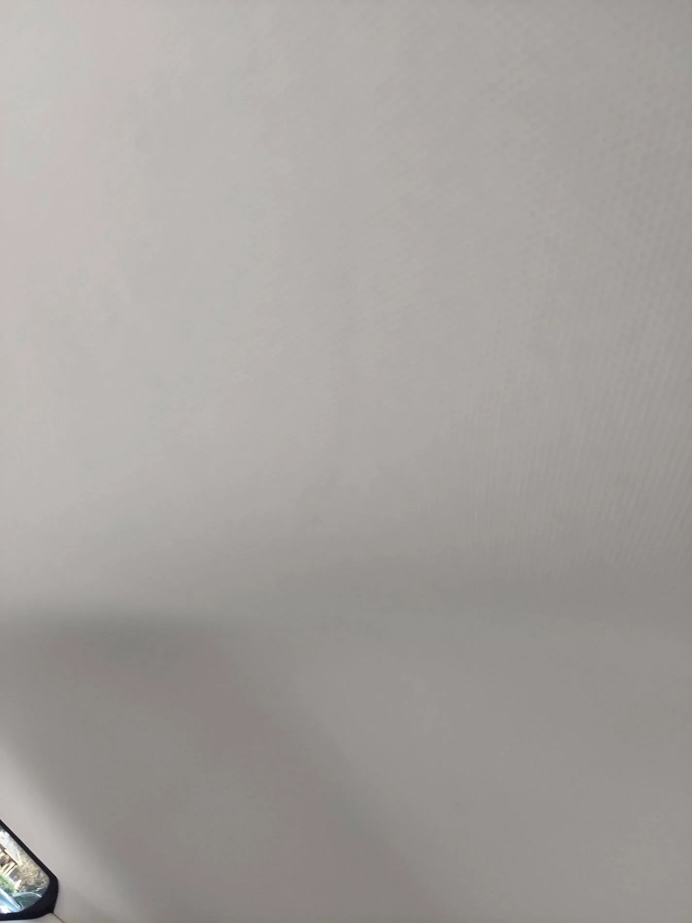

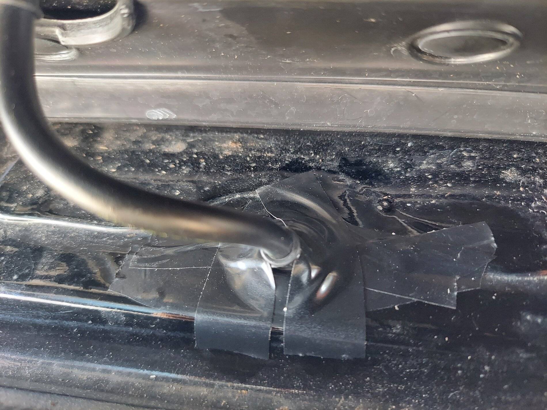

Just noticed this after going through the car wash. Noticed the headliner was wet with blue streaks. Noticed that the rear top light was sticking out and the pins underneath that hold the black flap were out. The line for the wiper fluid that looks like a stopper is attached to the body was out. So I taped that down with electrical tape. I went to the dealership and asked about the light and the service department did not know how to handle it so it is fun having a new vehicle that no one knows how to fix.

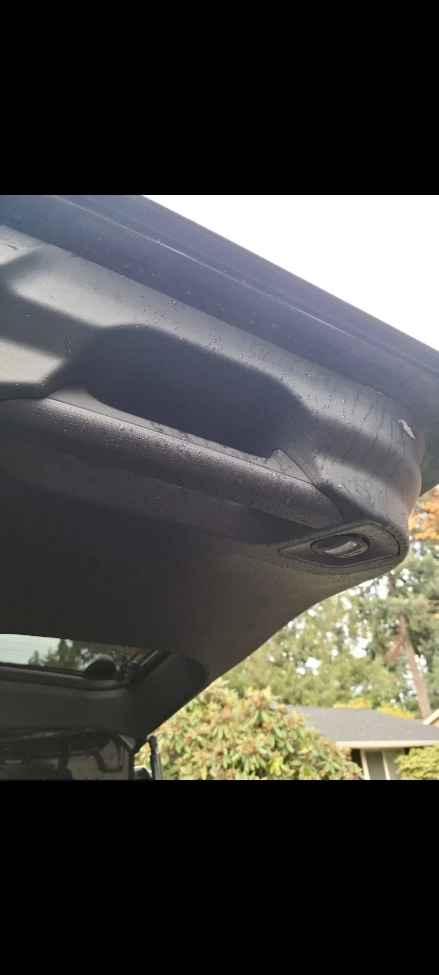

Just had this same problem today. Just got out of the car wash and I heard water sloshing around for a bit. When I got home, I opened the trunk door and I found that water is somehow getting through the rear window. I dried everything inside and then I grabbed the hose with low spray to see if it was just the car wash having too much pressure. When I opened the trunk there was water again, getting through rear window seams. Back to the dealership....again. smh
