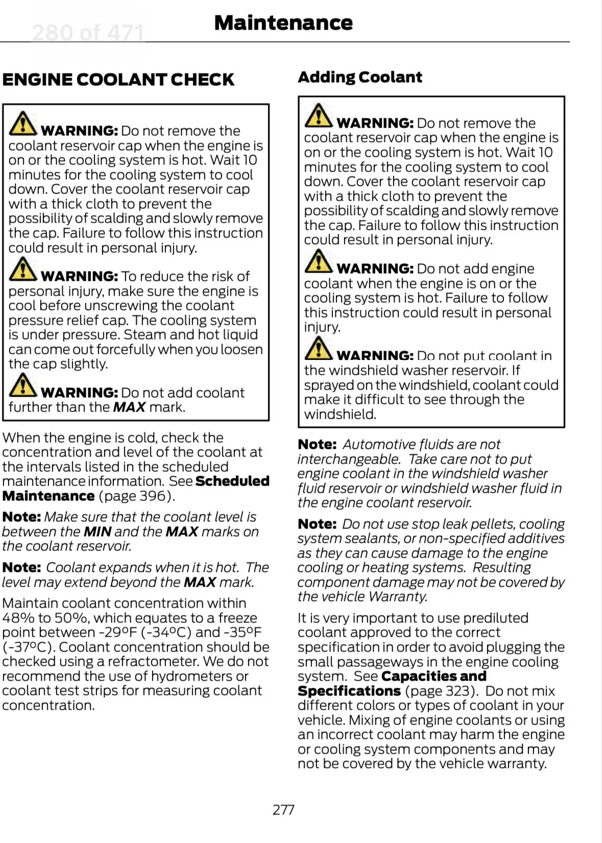

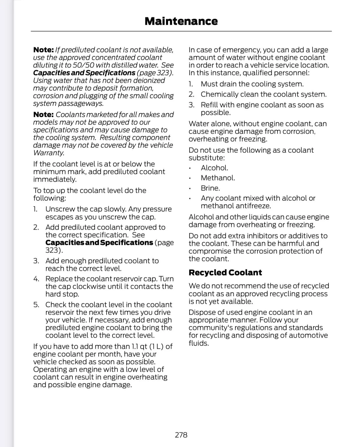

Make sure you add the correct coolant.
I was having to top off the coolant in the past, but have not had to add any recently. If the reservoir is empty, you probably have a bad water pump. However, the coolant maybe being sucked into a combustion chamber through a bad head gasket.
The leaking water pumps are a known issue.
