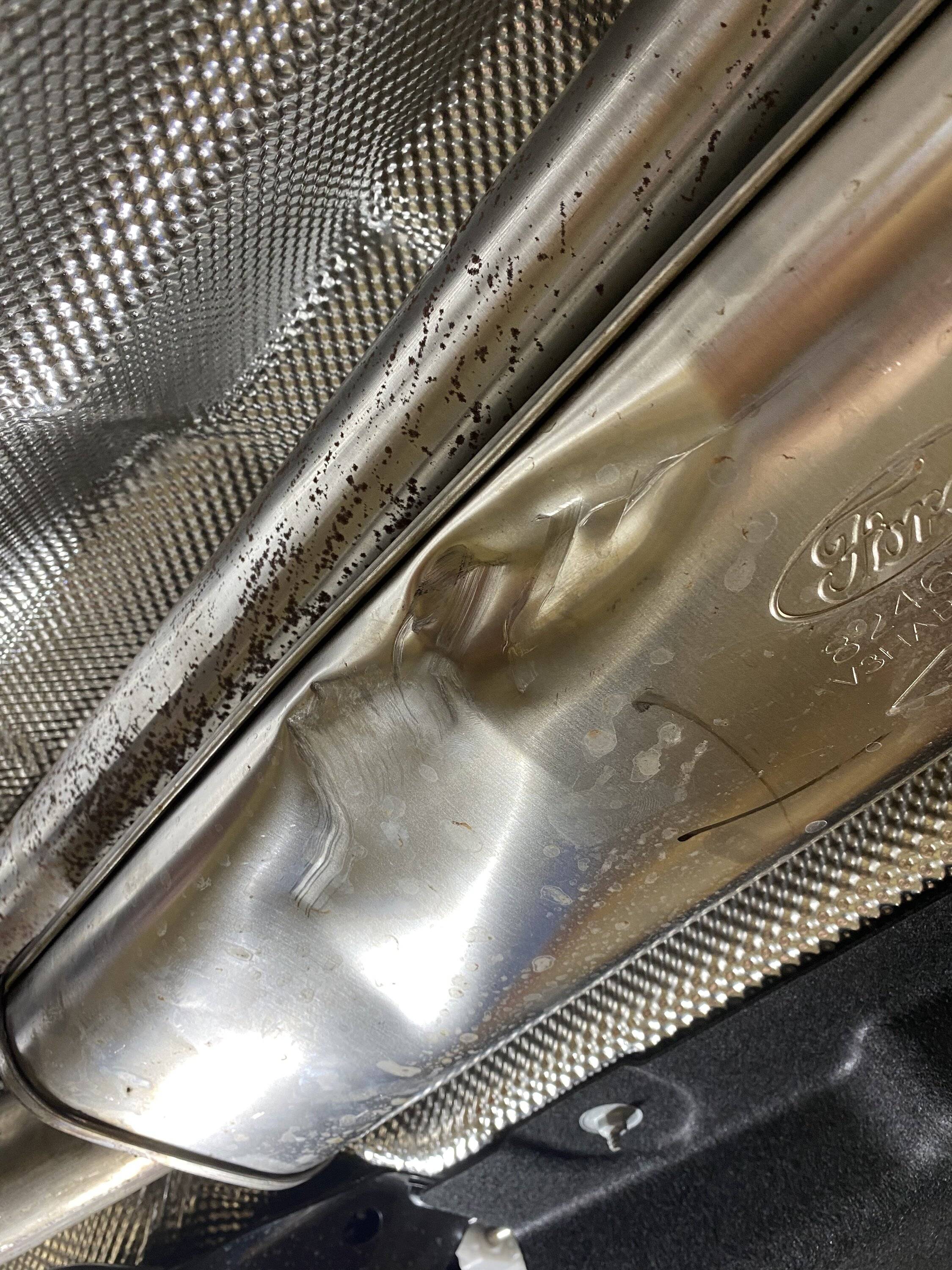

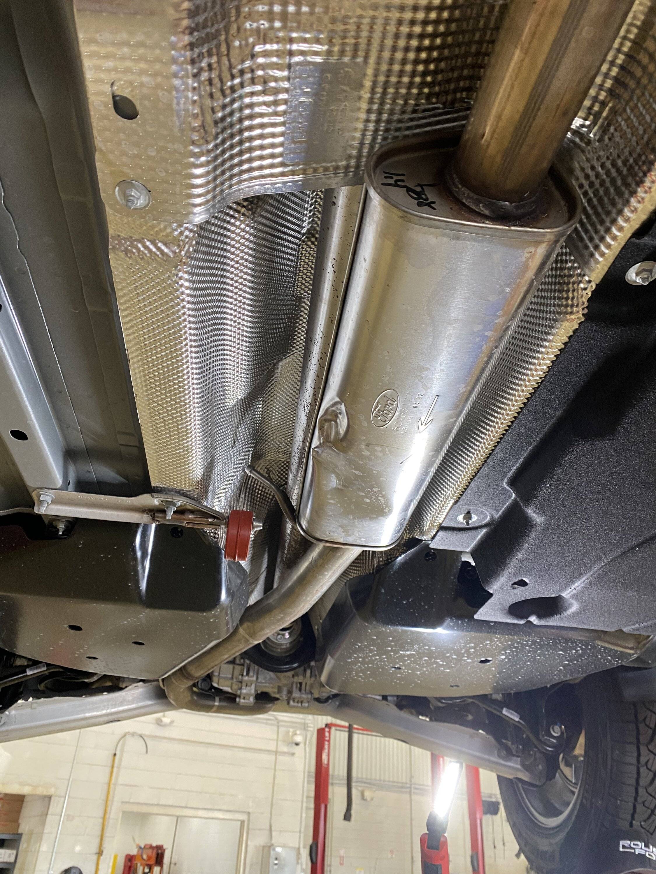

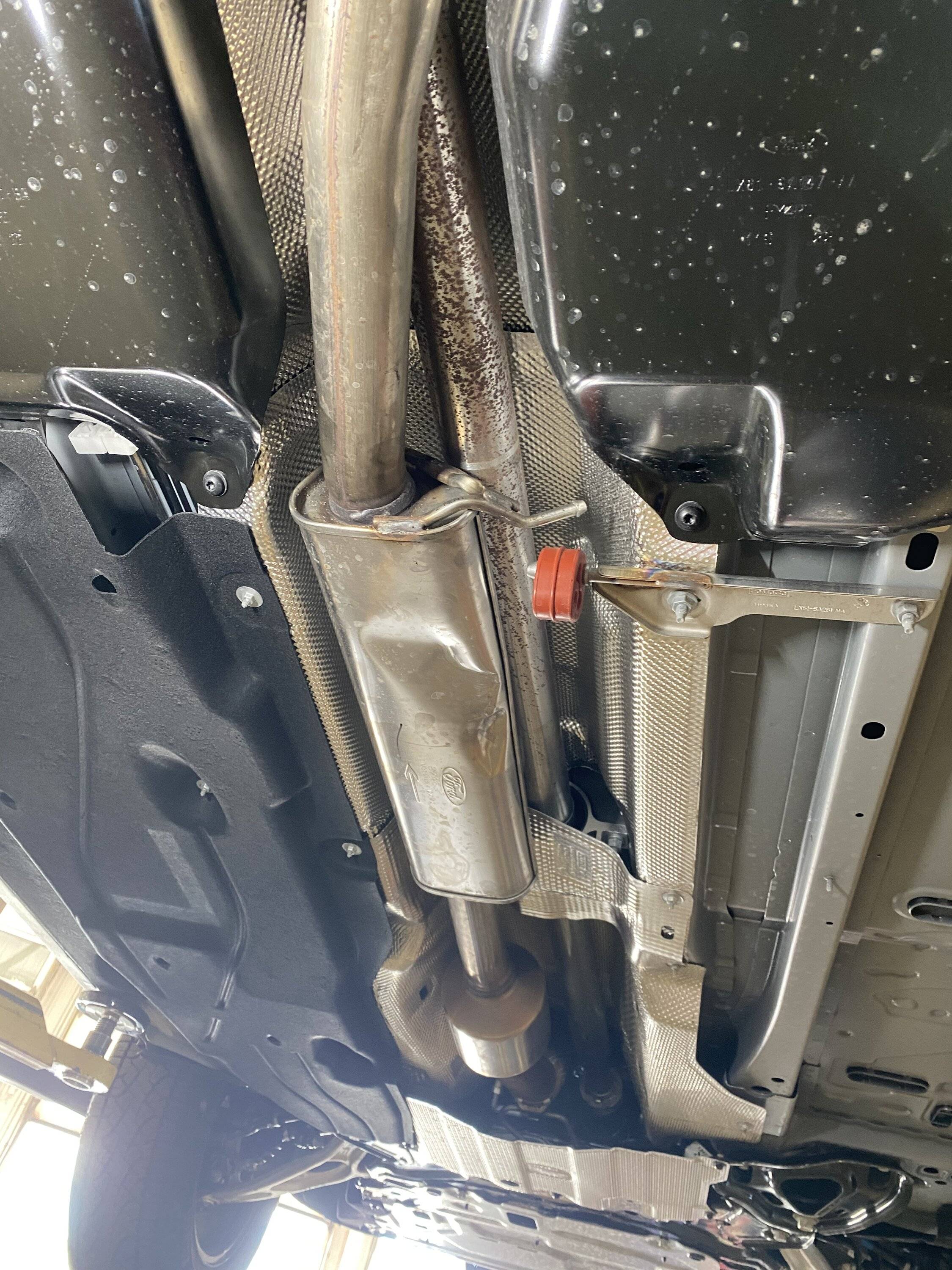

It gets to sit in my garage until parts come in. They keep telling me I hit something. I DID NOT!!! Pretty sure I would have heard something hitting my car as hard as it would had to been hit for this to happen. I pulled out of the house garage with 60 some miles. Got to work pulled in garage and the awful sound started. Pretty sure this was damaged during transport & it just shook loose today. A piece came off and was rubbing the drive shaft. They are checking with Ford on covering costs. Mentioned me claiming it on my insurance which is total BS because I didn’t do anything to my vehicle.

Nice to see someone finally doing some serious mall crawling! JK!
That took a serious knock from below. Maybe one of the lot hands tried to jump the curb on the way to PDI. Surprised you didn’t hear it right away. You can see where the muffler is rubbing on the drive shaft because it was broken away from the hanger.

Quite bummer and hopefully they resolve it for you (some Ford Goodwill!)... On a different note (sorry!), isn't there suppose to be a metal bash plate on the Badlands edition? That looks like the felt underliner, plus only 1 piece/on 1 side??

It's there. It's right where the picture edge is at the bottom.

I don't doubt that you did not hit anything -- but obviously someone did.
Perhaps it was damaged during transport, as you said.
I don't make a habit of defending dealers, but this is not a clear-cut situation. From their perspective, it's clearly not a mfr defect. There's no way to cover it under warranty.
Your best bet may be trying for some "goodwill assistance" from Ford -- since you cannot prove it happened before delivery and they cannot prove it did not -- and you've had it less than 2 weeks.

OP, couple things to pay VERY CLOSE ATTENTION to
Note the top post (green arrows)
Note the lower post (rubber rings)
Top post sure looks bent (not parallel to lower post)
Lower post looks untouched
How does upper post take a hit and lower post is fine????
If this is the case I'd suggest it may have been installed this way
damaged from the start
Another point to take note of
exhaust muffler/post takes a giant hit
heat shield inches away unscathed?
