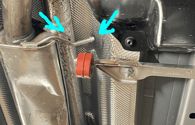

How does upper post take a hit and lower post is fine????
If this is the case I'd suggest it may have been installed this way
damaged from the start
This is a great point. Also, what's the black X drawn on the muffler? Did your dealer do that so the damaged part is identifiable or did someone at the factory mark it bad and then somehow it got rolled to a new position without getting replaced? I seriously doubt someone at the factory has a job putting black X's on every muffler rolling off the line. Can't speak to all of them, but mine doesn't have that. That is a actually a double post that goes into the red damper. One of yours is broken off (missing) completely.

OP, couple things to pay VERY CLOSE ATTENTION to
Note the top post (green arrows)
Note the lower post (rubber rings)
Top post sure looks bent (not parallel to lower post)
Lower post looks untouched

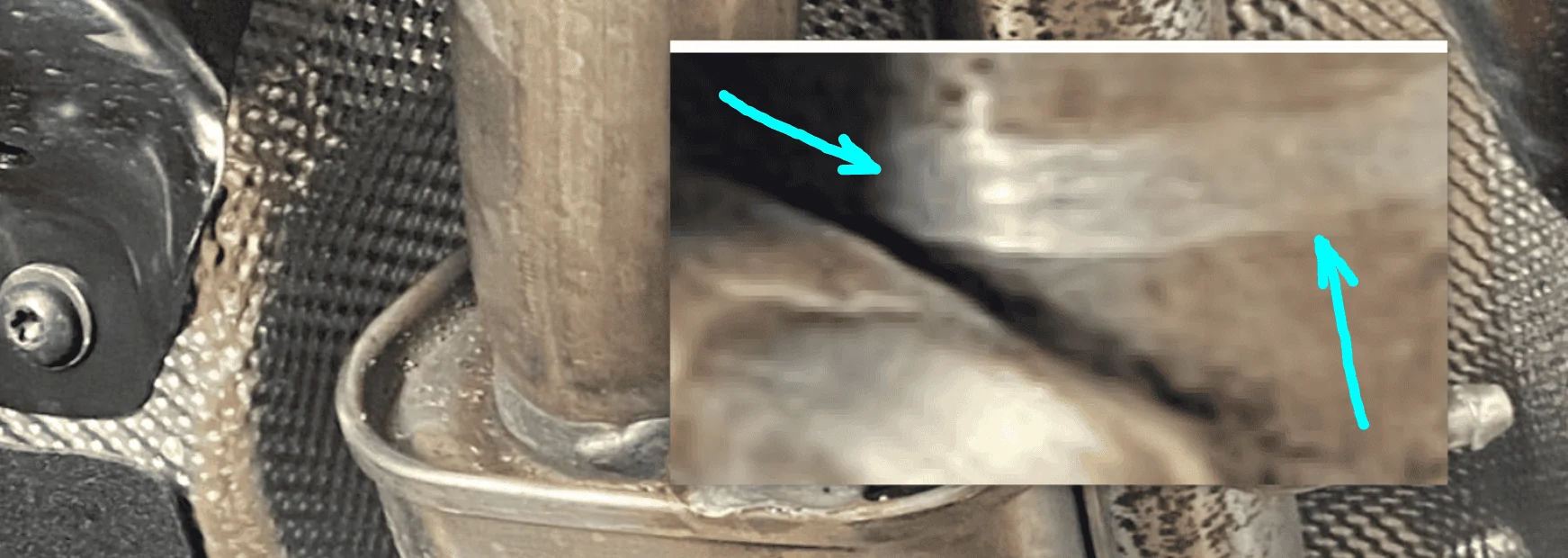

Another point to take note of
exhaust muffler/post takes a giant hit
heat shield inches away unscathed?

Good eye Major Kong!
After giving it another look, if the upper post was violently yanked out of the exhaust hanger, the hanger and/or the lower post should be damaged.
Also, for the upper post to be at that angle, it would have to have been hit with whatever hit the exhaust (which is possible). If the exhaust alone was hit and forced upwards, that upper post would have been pulled down (if it were bent at all).
The plot thickens.

Hit/fell off ramp while loading/unloading on train/truck ??
Someone with marking pin looked at it for sure.
Not to mention the drive shaft above it. If the muffler had been installed when it was damage it seems to me whatever damaged it would have also at least left a mark on the drive shaft.
