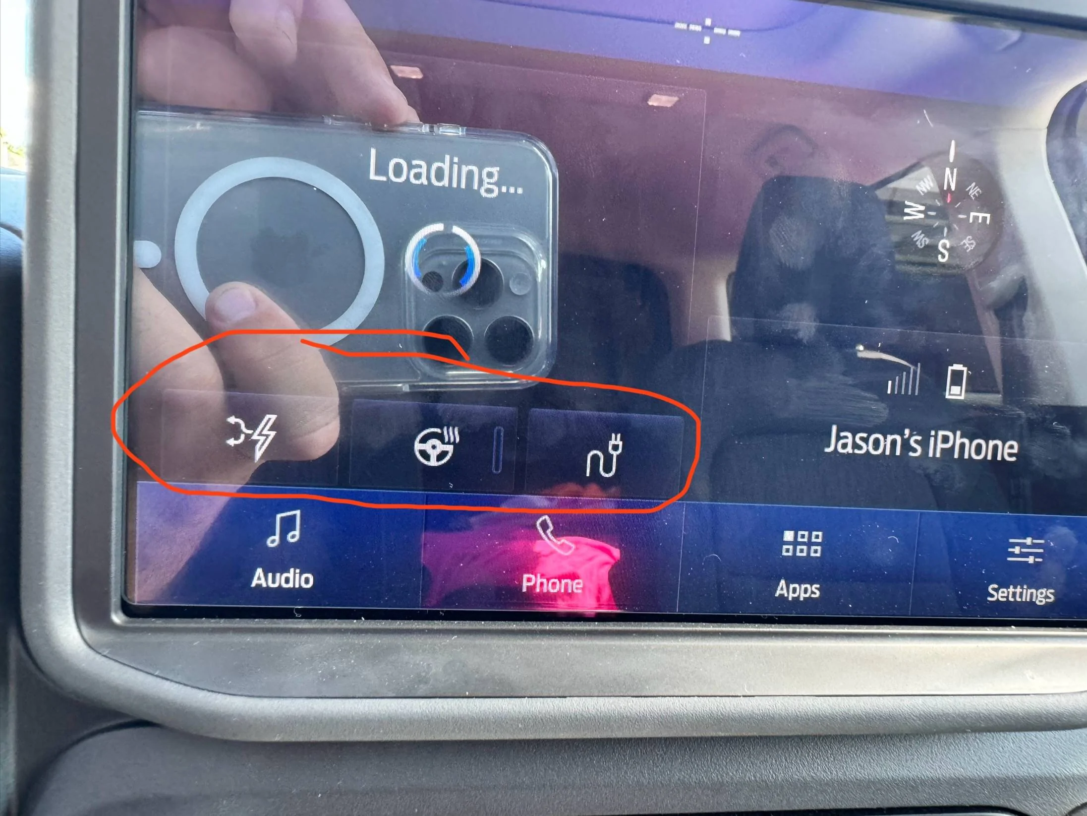

#5 having problems getting it to show. It showed once for me but when the unit restarted when doing the next step it went away.
with that being said when I originally did #5 I didn’t have the engine running when doing the Climate Domain and I went and rebooted the display unit (Holding Power + FF button simultaneously) this screen/icons showed. Any idea what the 2 icons are on either side of the heated steering wheel?

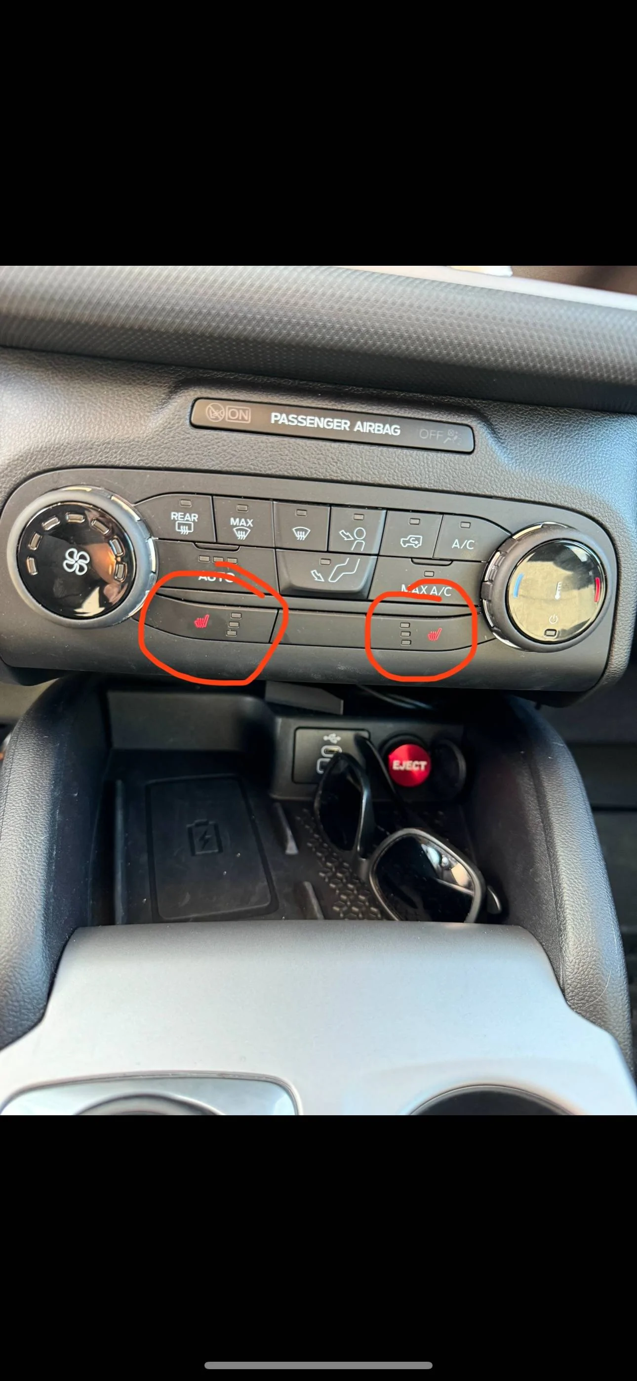

Did almost all of these but apart from bambi mode & double honk nothing else worked. I dont know how to change the flashing sequence. I did add the heated steering icon on screen but i dont think my BSBB is equipped wirh it.
You do not. Not in the Big Bend!!!
However, do you have the red bottoms at bottom? If so you can put the heated seat icons on the Home Screen of the display. Look in APIM and filter/search Seat Icons.
Also be aware IF you have them and get the icons on the Home Screen of the display, every time you turn off the BS and turn it back on the screen will ALWAYS default back to the Home Screen. Made me crazy so I took them off lol
Ford Bronco Sport Bronco ForScan Thread IMG_4811
Thank you for the advice. I do have the heated seats options/buttons. If it is going to go back to the default screen then i would leave it as it is.
