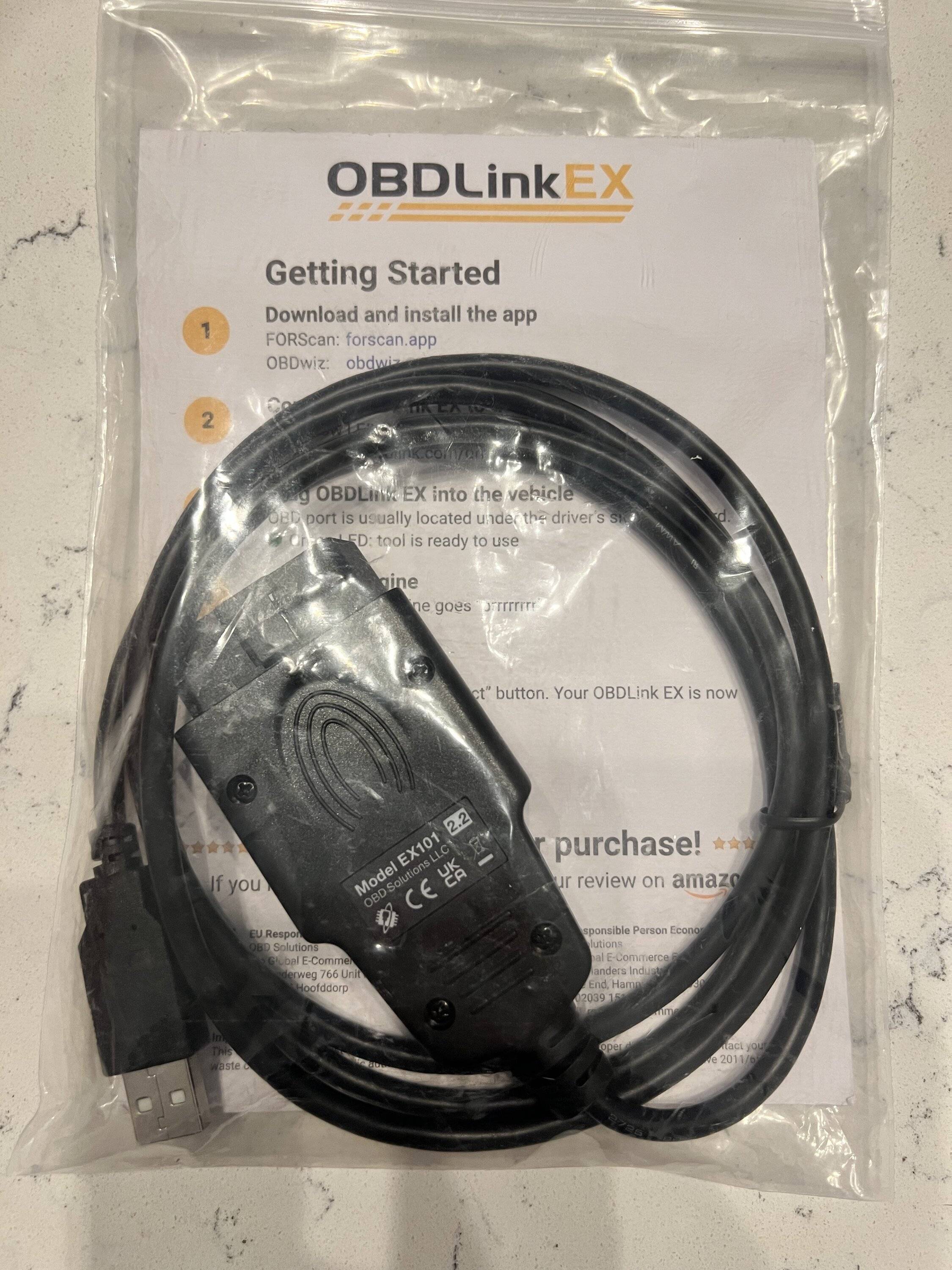

Finally wanting to get around and use FORScan.. is this a good OBD2 adaptor to get?
https://a.co/d/i9OgldJ
I've never heard of that brand, but that doesn't mean it won't work. It's rated well on Amazon, so there's that. I've got an OBDLink product, and I haven't had any issues with it. I bought it a few years back before they got really popular. The Bluetooth version is pricey.
This is the wired version.
https://www.amazon.com/OBDLink-EX-FORScan-OBD-Adapter/dp/B081VQVD3F?ref_=ast_sto_dp
This is the Bluetooth.
https://www.amazon.com/OBDLink-Bluetooth-Professional-Grade-Diagnostic-Performance/dp/B07JFRFJG6?ref_=ast_sto_dp
Whatever tool you get, be sure it communicates with Ford's canbus.
115
4,762
5,870
I have the same wired OBDLink product as Mark posted and it works great.
Bluetooth sounds nice but read about the downsides of going with a Bluetooth product. Although many people like them, I’m wary of Bluetooth disconnects as data is being written (with its possible data corruption side affect).

Thanks guys! That’s enough of a recommendation that I’ll go with this one as well!!
