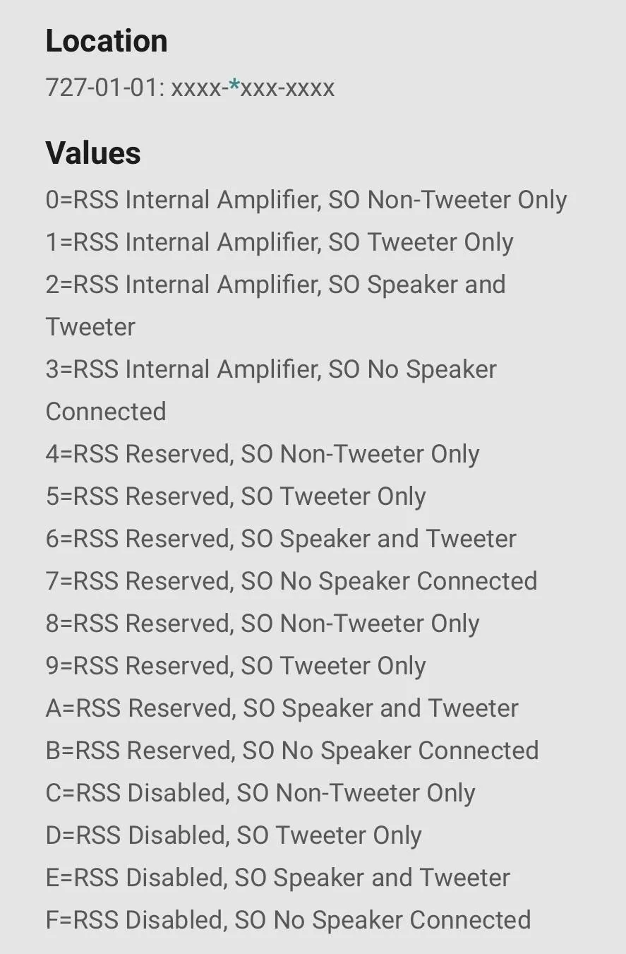

Been doing some research and looking at a lot of AsBuilt data from different BS's, Escapes, and some others. It turns out the EQ setting (727-01-02) isn't the correct fix for the rear speakers to be full range if you have the 6 speaker setup (no-b&o). We actually dont know what the EQ settings are for sure, only that they exist and are "model specific".
There are individual settings for the front speakers and rear speakers for 2021+ ACM modules. Looking at my AsBuilt data my fronts are set to woofer and tweeter(this is correct), but my rears are set to only woofer, which explains the sound difference I have.
Example, my ACM AsBuilt (6-Speaker):
727-01-01 = 382B, 0002, 00
Power Source and Left Front Speaker:
Ford Bronco Sport Bronco ForScan Thread Power Source and Front Left Specs
This is correct for full range.

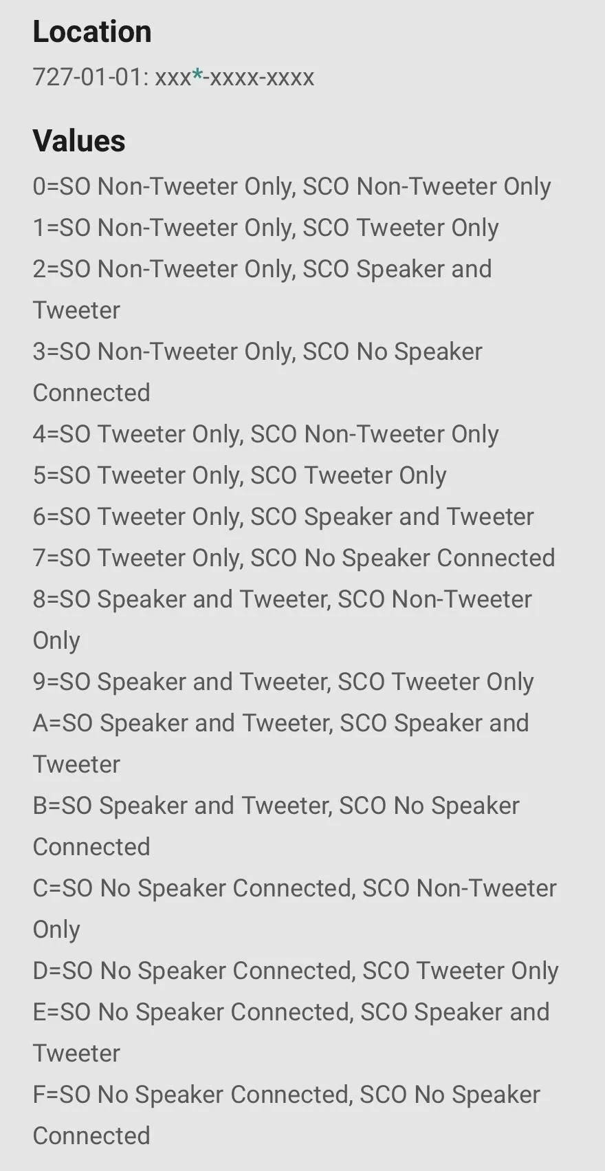

Right Front and Center Channel Speaker:
Ford Bronco Sport Bronco ForScan Thread Front Right and Center Channel Specs
This is also correct for Full Range but no Center.

Power Source and Left Rear Speaker:
Ford Bronco Sport Bronco ForScan Thread Power Source and Rear Left Specs
This should be changed to a 2 for full range.
And it's the same story with the Right rear....

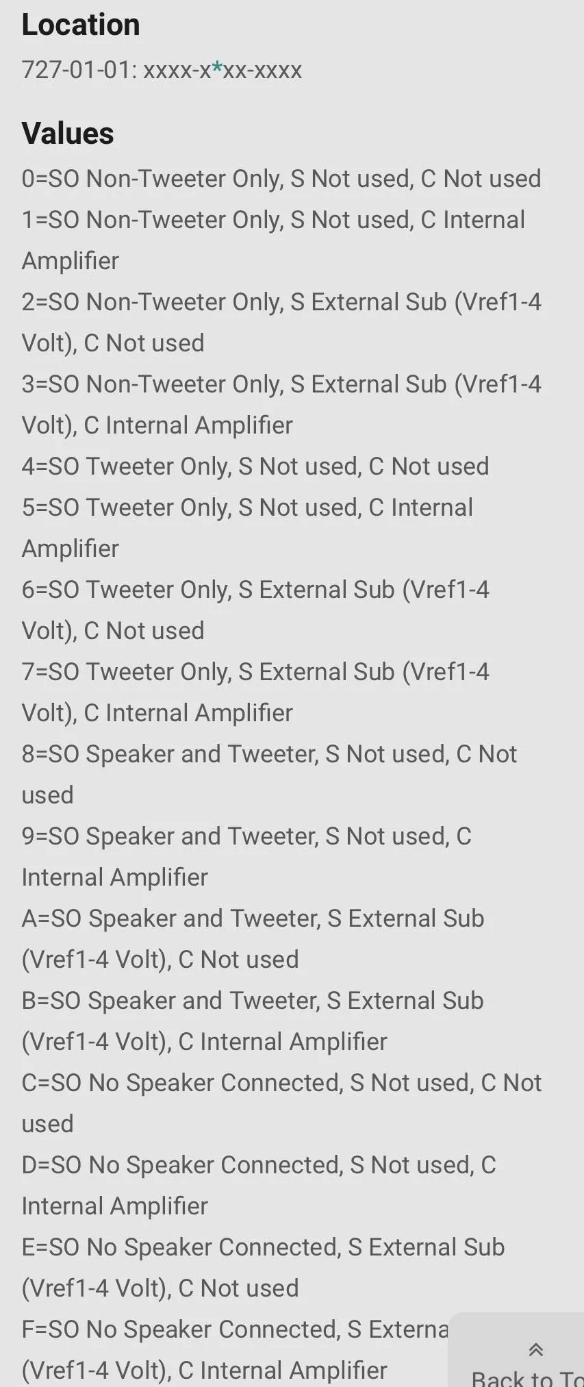

Right Rear and Subwoofer:
Ford Bronco Sport Bronco ForScan Thread Rear Right, Sub, and Center Specs
This should be changed to an 8 for full range and no factory Sub.
So will will be changing my line to:
727-01-01 = 382B-2802-00

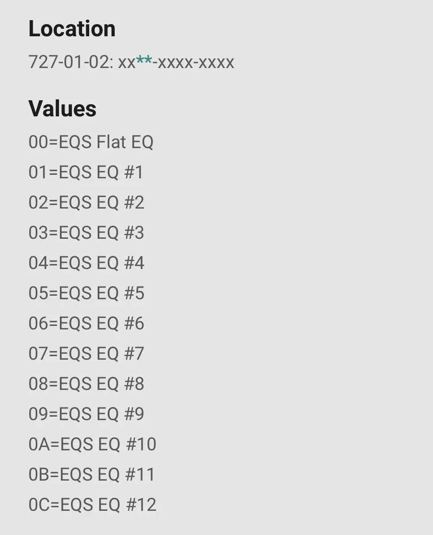

Now addressing the EQ setting thing....
My AsBuilt:
727-01-02 = 0901, 0000, 00
Ford Bronco Sport Bronco ForScan Thread ACM EQ Values
Changing the 01 to a 00 will make the EQ flat. BUT it will not change the dynamic of the speakers without changing the lines above. Now, what EQ 1-12 are and how they effect the output; no one seems to quite know what the actual differences are, but they are "model specific".
I have not loaded this yet with Forscan because I am sick and dont feel like moving from my couch currently, but when I do I will let you know.
