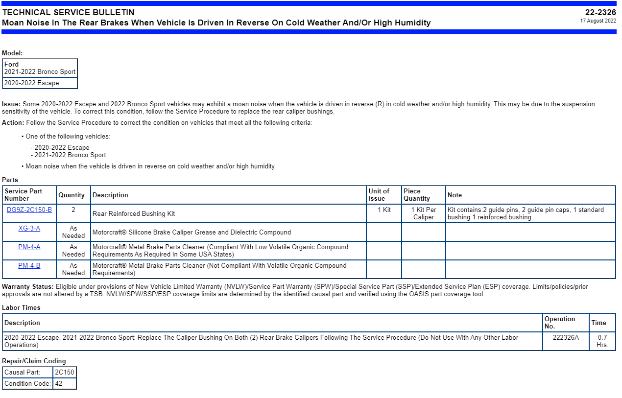

It is not normal and Ford is aware of it and it also affects the Escape models. There is a Technical Service Bulletin from Ford that addresses this problem. I had the issue from the first day that I received my 2021 Badlands and finally had the replacement parts installed by my dealership last week which solved the issue. The parts have been on backorder and may be difficult for your dealer to get quickly (took mine 2 and half months to get the required parts).
TSB 22-2326
Parts number - DG9Z-2C150-B

Yep the common tug boat horn in a harbor sound. Ford has rear caliper bushing TSB for that issue. And useless dealers say its normal jerking ppl around hoping they don't come back.

Thanks a lot for this. I will definitely show this to the dealership so they actually fix my problem.

Perhaps you should show them a copy of TSB 22-2326 and see what they have to say (unless you already have). Cheers!

Yup, not rust. Time for a new dealer. Rust on the disc’s makes a grinding noise. This is a resonance (fog horn) sound. Might want to tell them to brush up on their responses as you know people!

Tug-boat-horn-in-harbor noise when backing up after sitting is the Caliper Bushing TSB.

I had it in for that TSB. It is supposed to be done already, but it seems even louder and more frequent after the new bushings.

You need to take with you a copy of the tsb above . Had mine replaced back in oct 2022 and all is good . Give this to the service manager and tell him to read it . It is very simple . Let us know .
