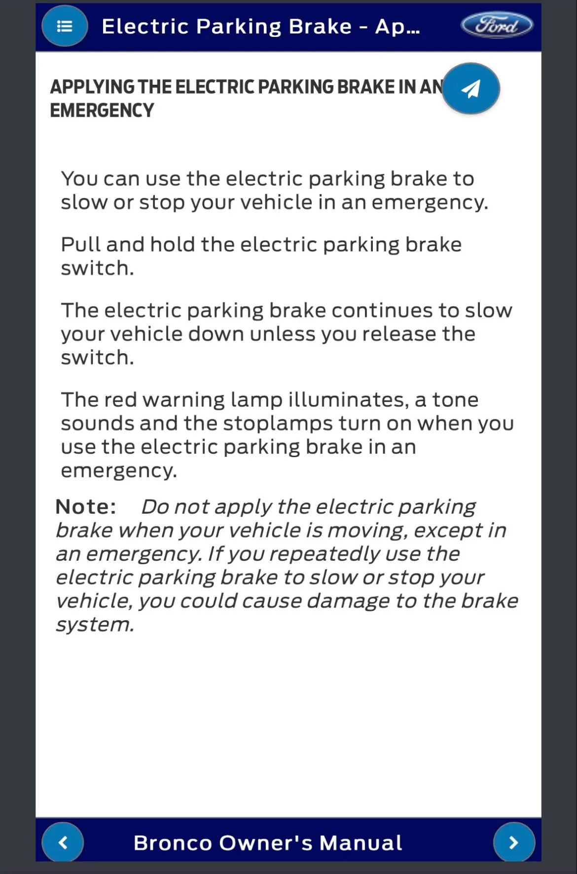

This makes me wonder: Does the parking brake on the Bronco Sport have any use in a situation like this? Obviously if it was a regular old e-brake handle, we could use that to brake in emergencies. But does our parking brake on/off switch have any application here? I'm not even sure it would come on, or what would happen if I just flipped it on while moving.

So I guess no power slides in the snow... I was wondering if I pulled it would lock it up, but I guess not. That does make sense, though. The mechanism to push/pull and the electronic activation would be too slow to quickly apply and release for some winter fun
