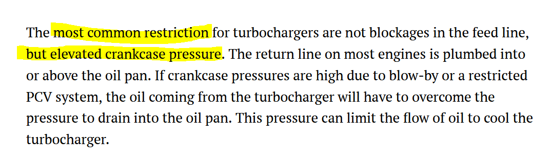

Ford Bronco Sport Boomba Racing Blow Off Valve (BOV) adapter; Vent to Atmosphere on BL 2.0 1654116030096
by now you know my opinion on crank pressures
another angle I was of which I was unaware
