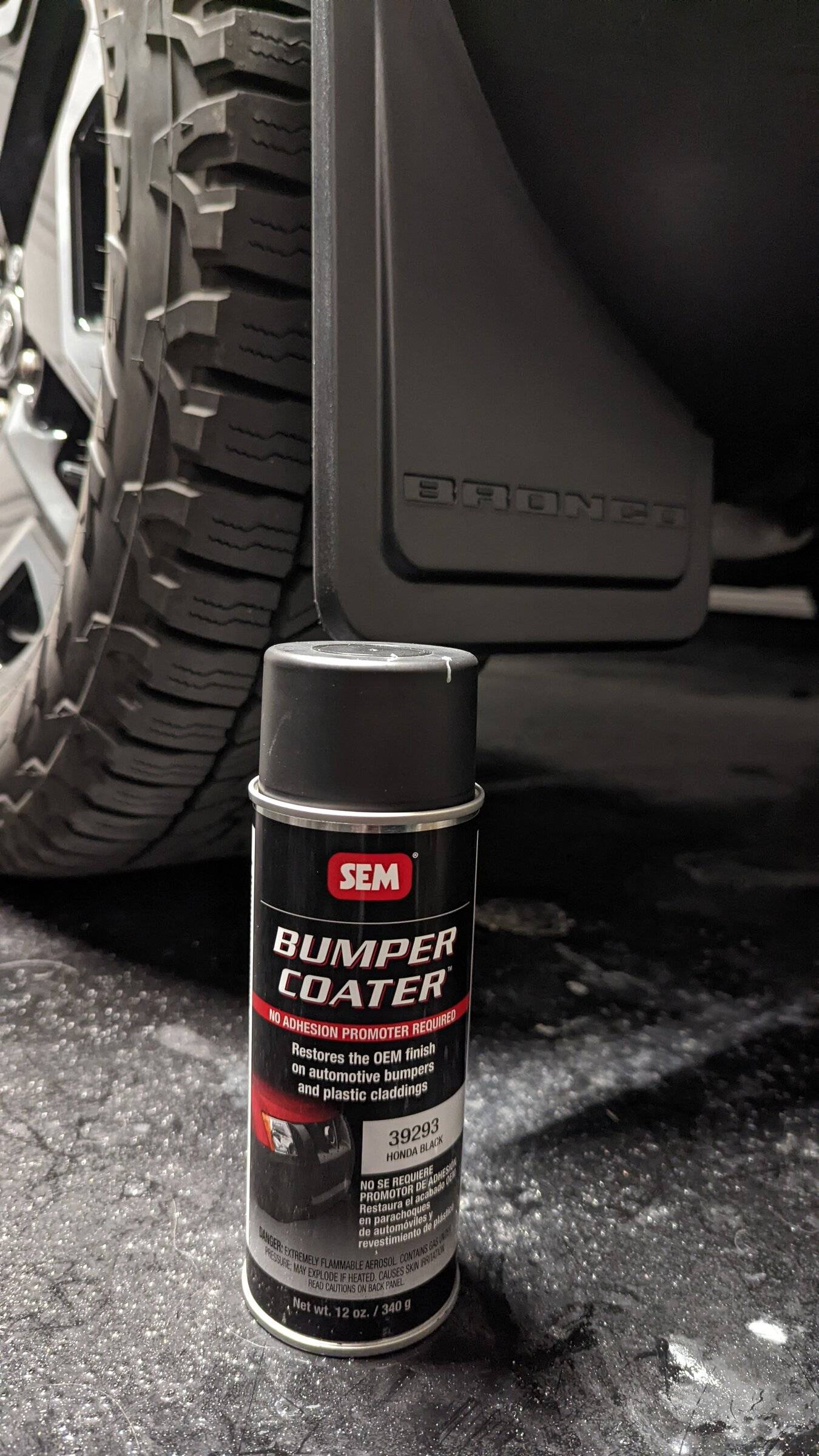

If anyone needs to do some repair to their plastic lower trim after some off roading, SEM 39293 Honda black is the perfect match for color touch ups. You can do spot touch ups and literally cant tell where the new color ends and the original bumper plastic begins.
Here is a photo where I did only half the mud flap as a test. I had to buy a lot of non refundable paints to find the perfect color so I thought this information could come in handy for others.
Ford Bronco Sport Black plastic bumper repair / spot touchup with Bumper Coater spray (SEM 39293 Honda black) PXL_20220120_063349839
Good to know! Thank you for your research and sacrifice. I'm sure many of us will need this at some point.
