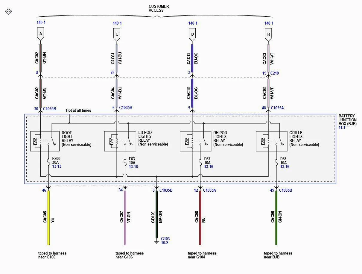

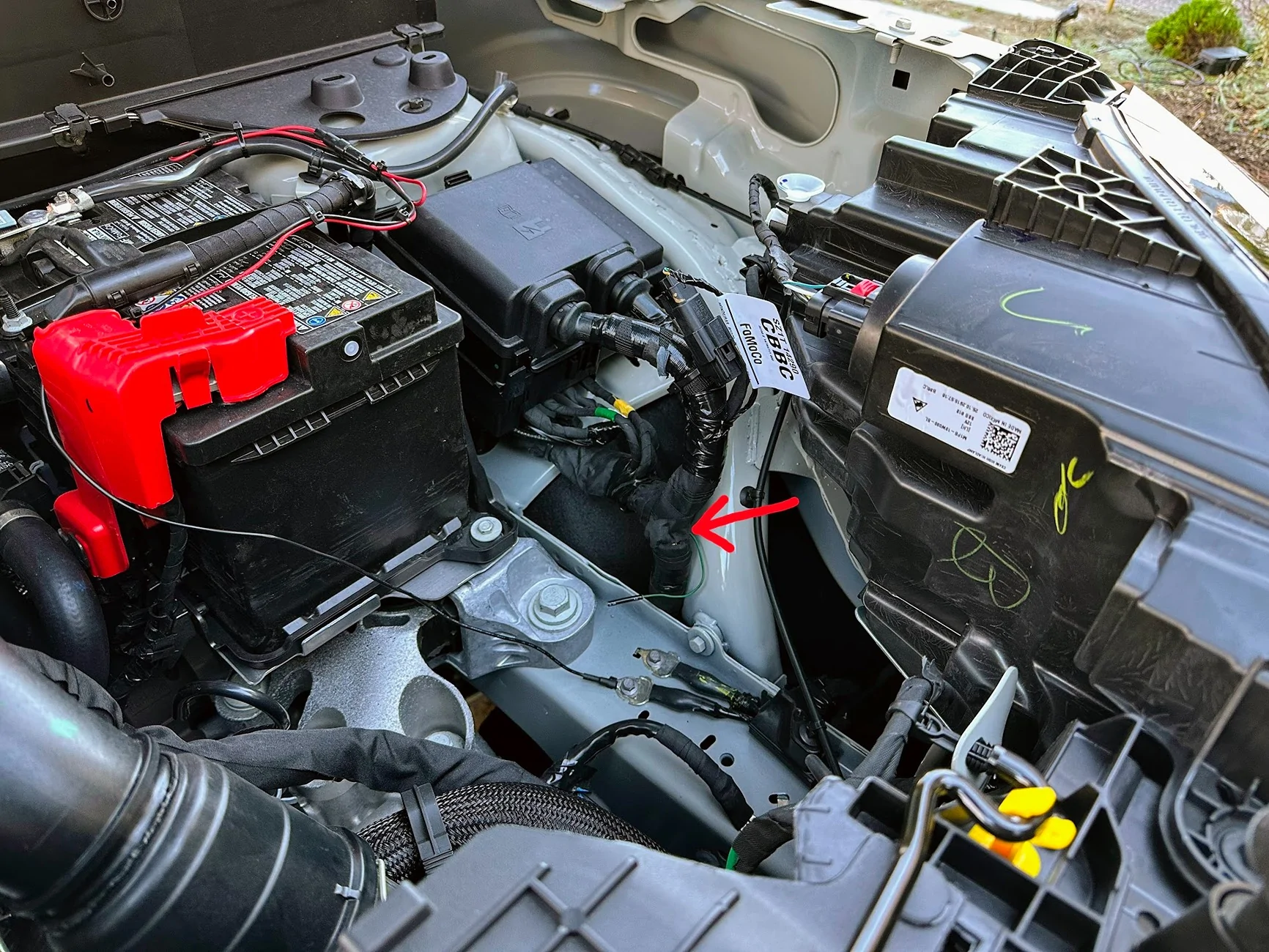

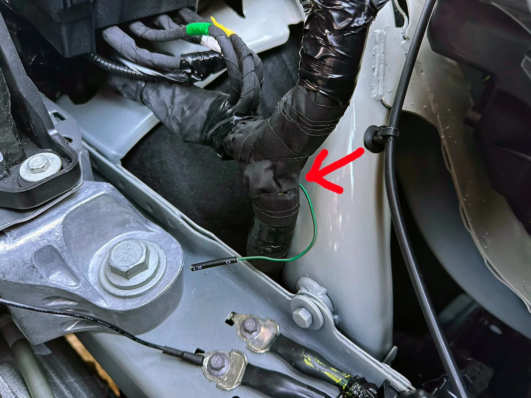

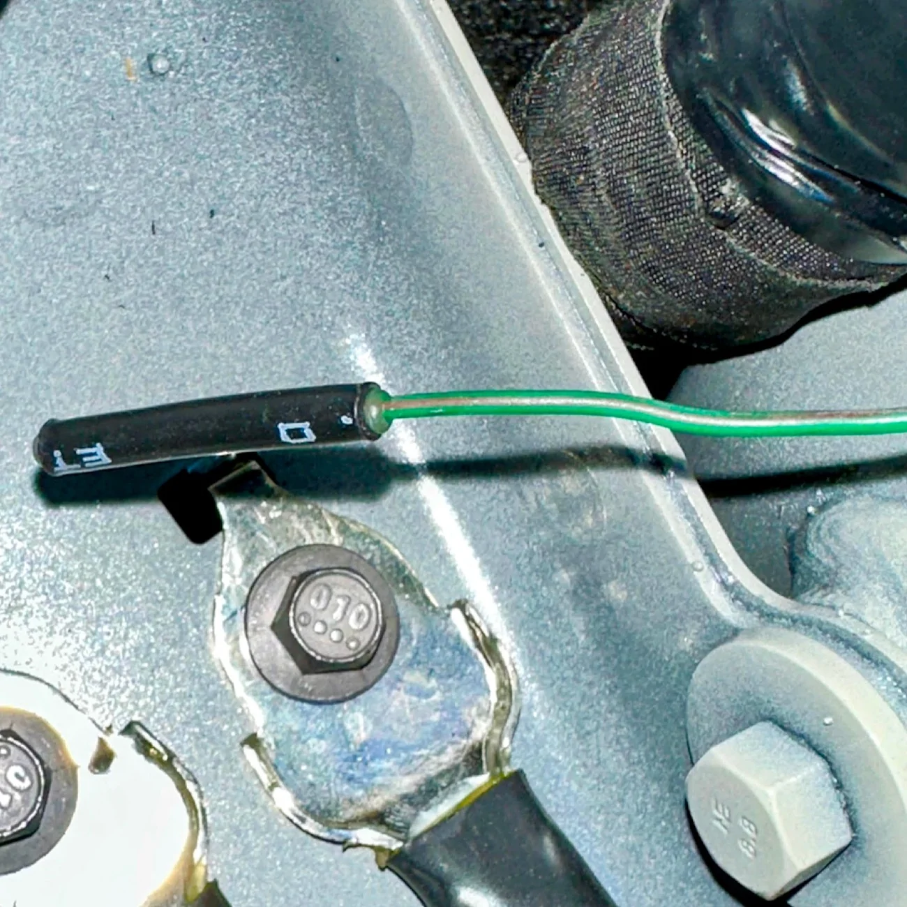

It's pretty much where the Ford diagram shows but I fished out the Green & brown "B" Aux 2 wire today. It was around the backside of the wire bundle not the easiest to find. you could feel the single wire through the electrical tape. Here's some photo's of where it was on mine. I plan on using it for some front floods mounted to the Sasquatch bar. Just waiting on mounting brackets
I found it taped up with shiny electical tape right where the red arrow is -->
Ford Bronco Sport BL Sasquatch AUX Switches Wiring Guide? IMG_1773-EDIT
a bit closer view -->

closeup of the wire itself, green with a brown stripe and capped off. It sure would have been nice it the put some sort of label on these.

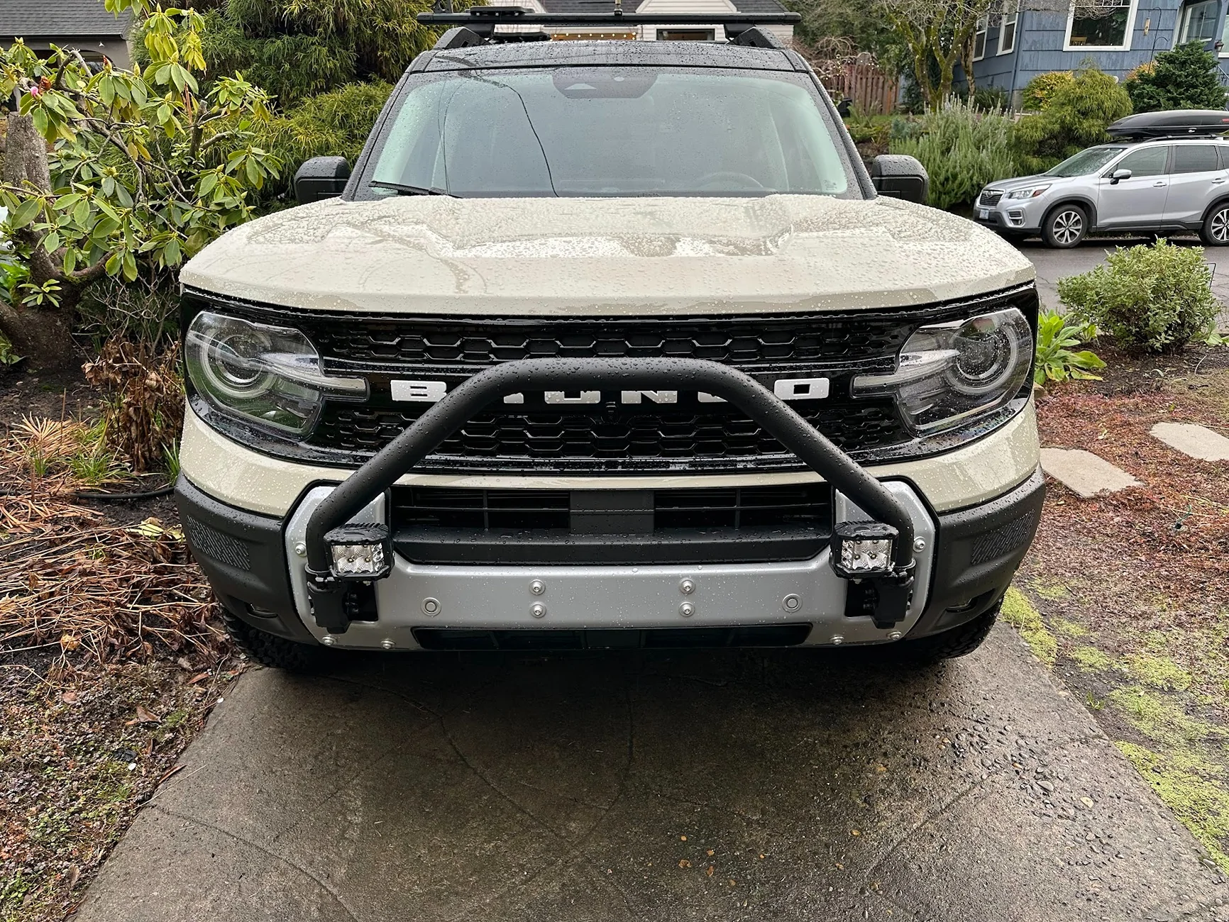

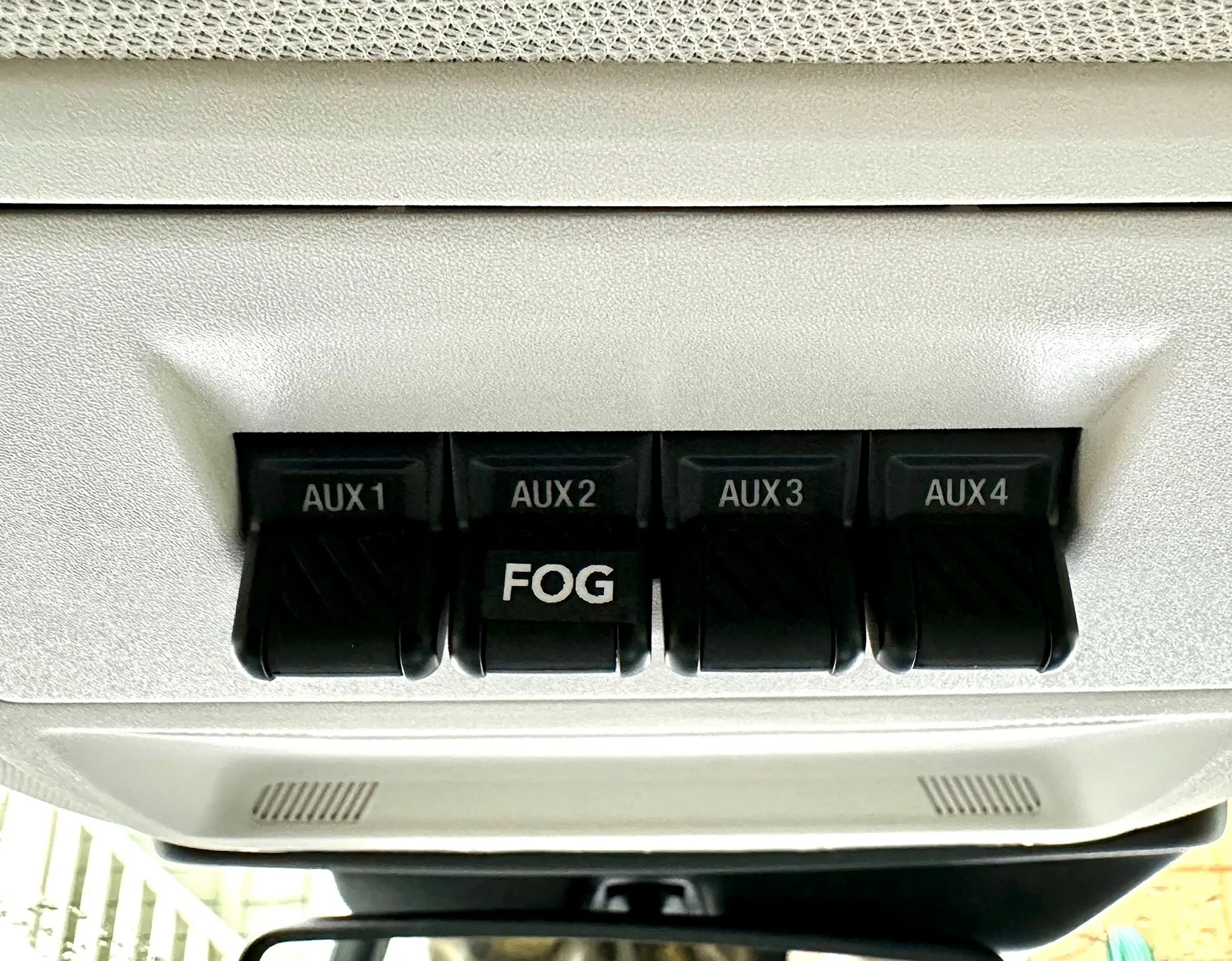

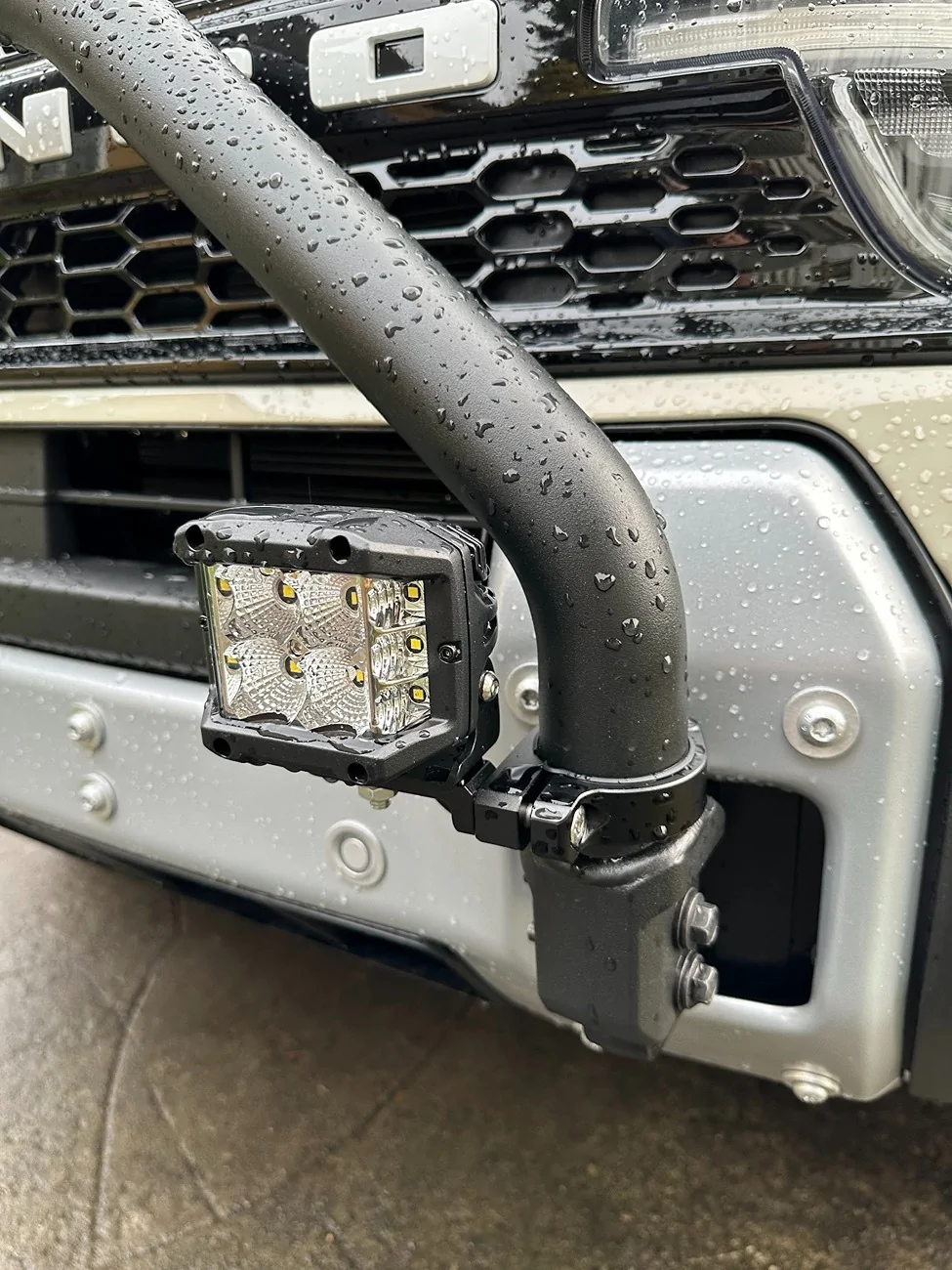

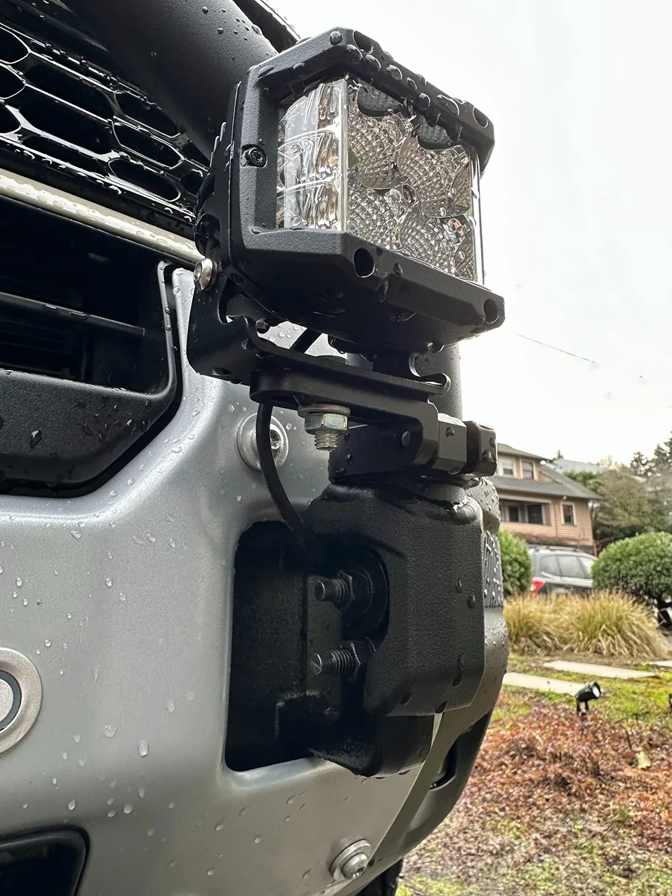

The brackets arrived and I added some cheap Harbor Freight 3" LED floods to the AUX 2 switch of my 2025 Sasquatch. I mounted them to the front bar. They sit forward of the bar, they’ll probably get hit at some point— So $85 felt better than some of the much more expensive options for now.
They’re actually brighter than I expected and only draw 50 watts each, so the 10-amp AUX 2 circuit was plenty without needing an extra relay. I routed the wiring through the existing holes in the steel bumper where the recovery points and bar pass through, which worked out nicely.
The brackets are from Amazon and are surprisingly well made. They should work with other lights too if I decide to swap them later. A quick P-Touch label on the switch and I still need to aim them but overall I’m happy with them for now.
Harbor Freight 3 in. Roadshock lights
Vazeswin aluminum mounting brackets
They won't interfere with the front plate once I get it and don't block any of the cooling
Ford Bronco Sport BL Sasquatch AUX Switches Wiring Guide? IMG_1788
The Brackets just wrap around the bar and are quite solid once tightened up
Ford Bronco Sport BL Sasquatch AUX Switches Wiring Guide? IMG_1789

P-Touch label looks ok too.
Ford Bronco Sport BL Sasquatch AUX Switches Wiring Guide? IMG_1787
