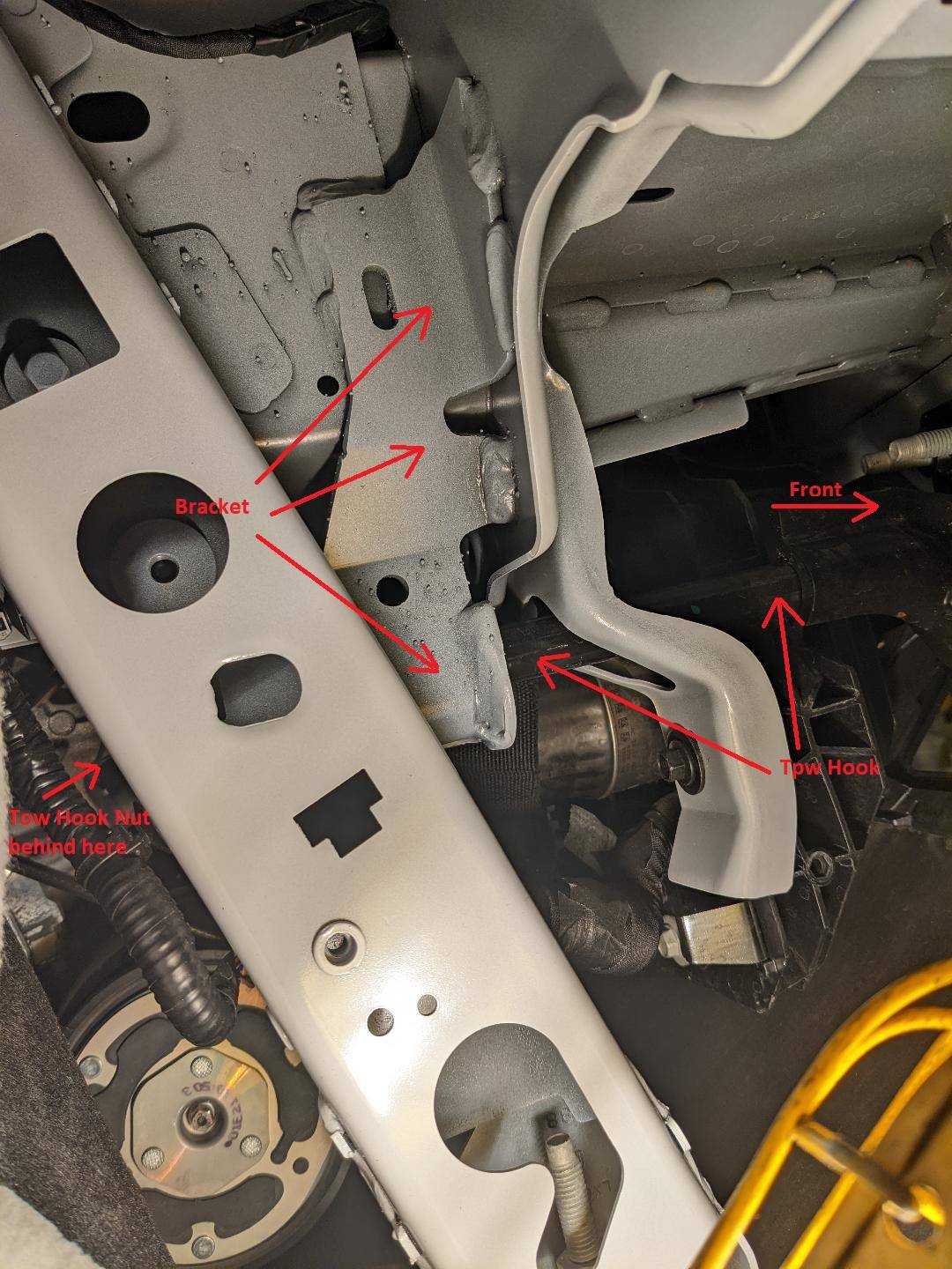

Maybe confirmed with this parts image. Seems us non-BL folks are missing the grey piece in the top right.
Ford Bronco Sport Big Bend Tow Hooks Screenshot 2021-11-18 162829
Grey piece top right is on all models. I can confirm that on my teardown it was there and have an OB. The part that is missing is what I highlighted in Red in these photos. Though it "Could" be a different bumper, I believe you or someone pointed out on here a $1300+ part. I think its a factory mod based on the indicators for model of the $1300+ part and it not being a different model for BL or FE
Ford Bronco Sport Big Bend Tow Hooks XUJTfec
Ford Bronco Sport Big Bend Tow Hooks XWJGbp6

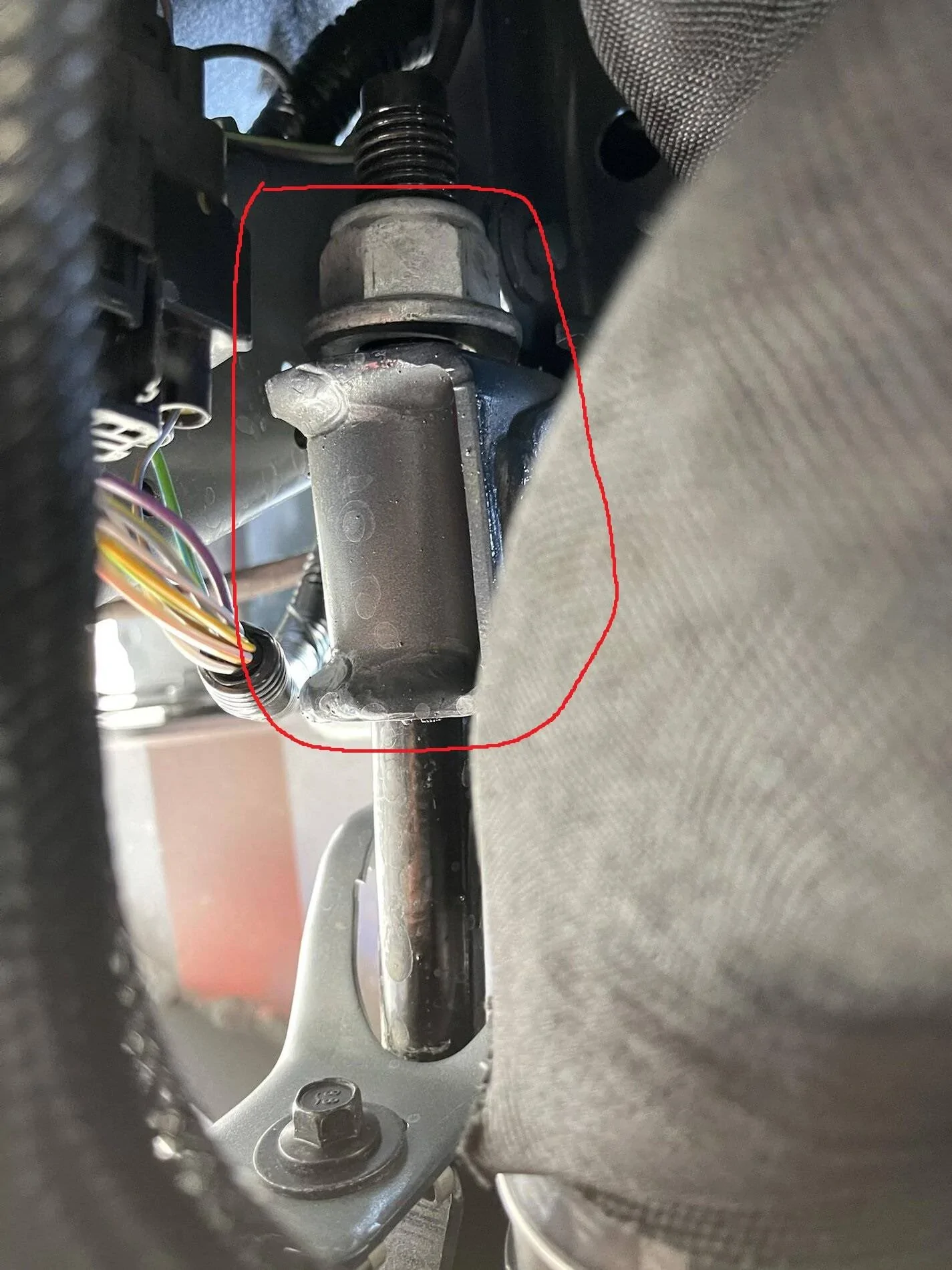

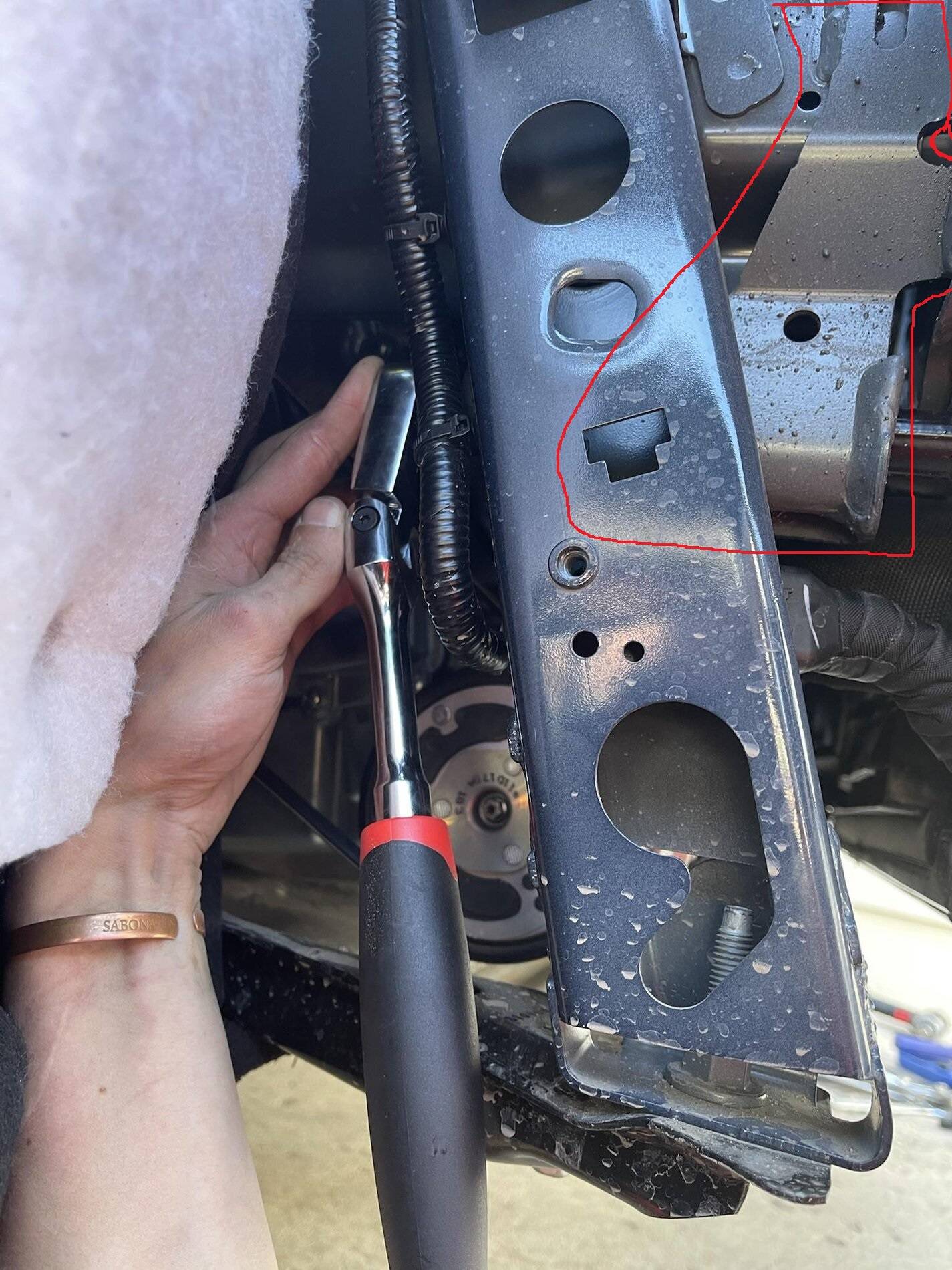

I had my badlands on my lift today and took this picture. I took the clips out of the felt wheel well liner on passengers side in front of tire. Looking straight in from the side you can see the thick metal bracket that is welded to the frame. I was hoping to be able to make something similar to sell to others but bolt in but does not look easy. So I assume that bracket welded to the frame is what lower trims are missing?
Ford Bronco Sport Big Bend Tow Hooks Tow Hook Bracket Annotated
1000% This! Thank you for confirming. I'm on this thread and a few others. Not sure how frequently you have your BS up on a lift and exposed but would be immensely interested in some dimensions of this bracket if you are ever up for it! I am interested in mocking it up in CAD and having it fabricated at some point, just don't have a BL or FE to take the measurements off of.
It has road salt in wheel wells right now and 20 degrees out but next time I wash it I put on my lift again hold measuring tape up to it snap more pics.
