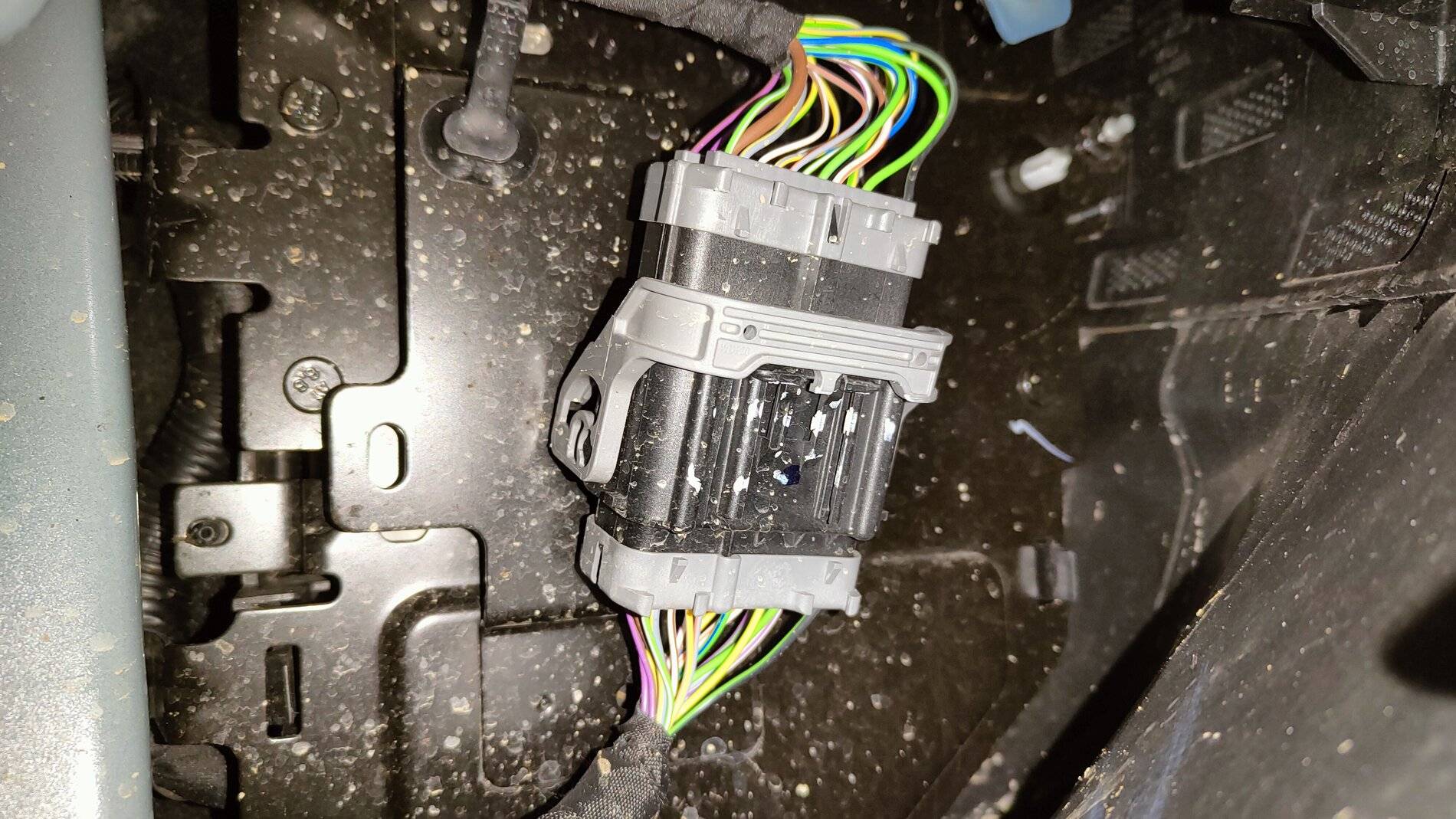

DISCOLEG
May 19, 2021
316
402
You might want to pass on that option as it seems to me the ECU connector is better protected without the hooks. View is from the hook hole.
Ford Bronco Sport Big Bend Tow Hooks IMG20210603181417
Good call... That changes my plan. Thanks for that heads up!
