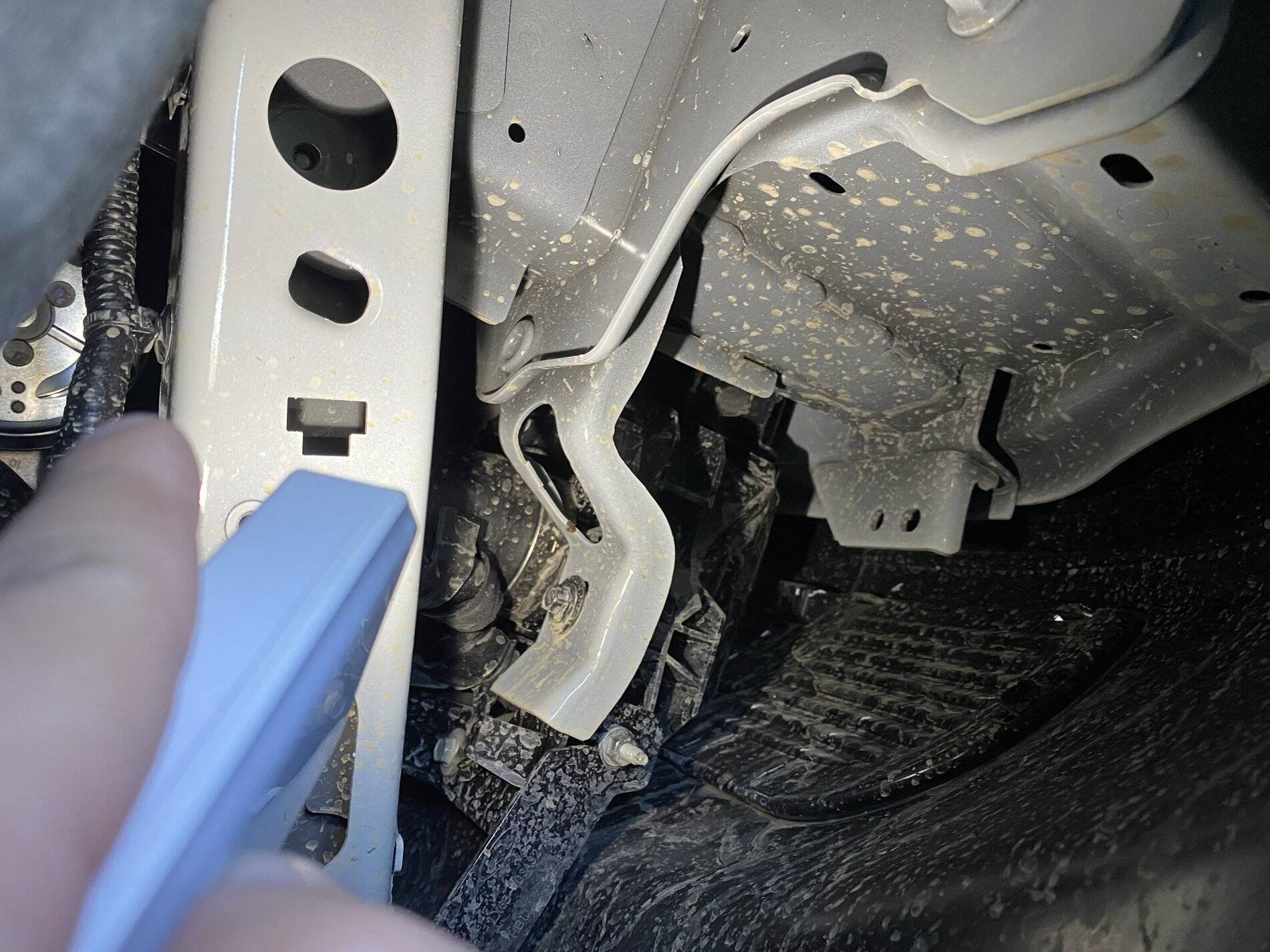

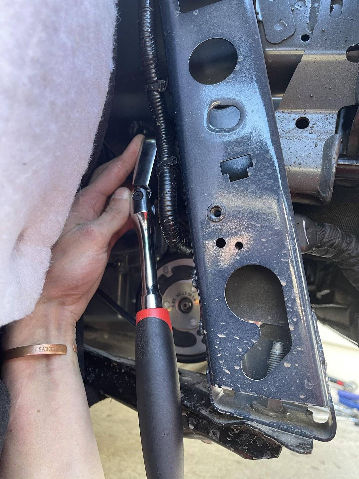

Found these pictures on this forum where the owner is removing them to repaint them.
Ford Bronco Sport Big Bend Tow Hooks XUJTfec
Ford Bronco Sport Big Bend Tow Hooks XWJGbp6

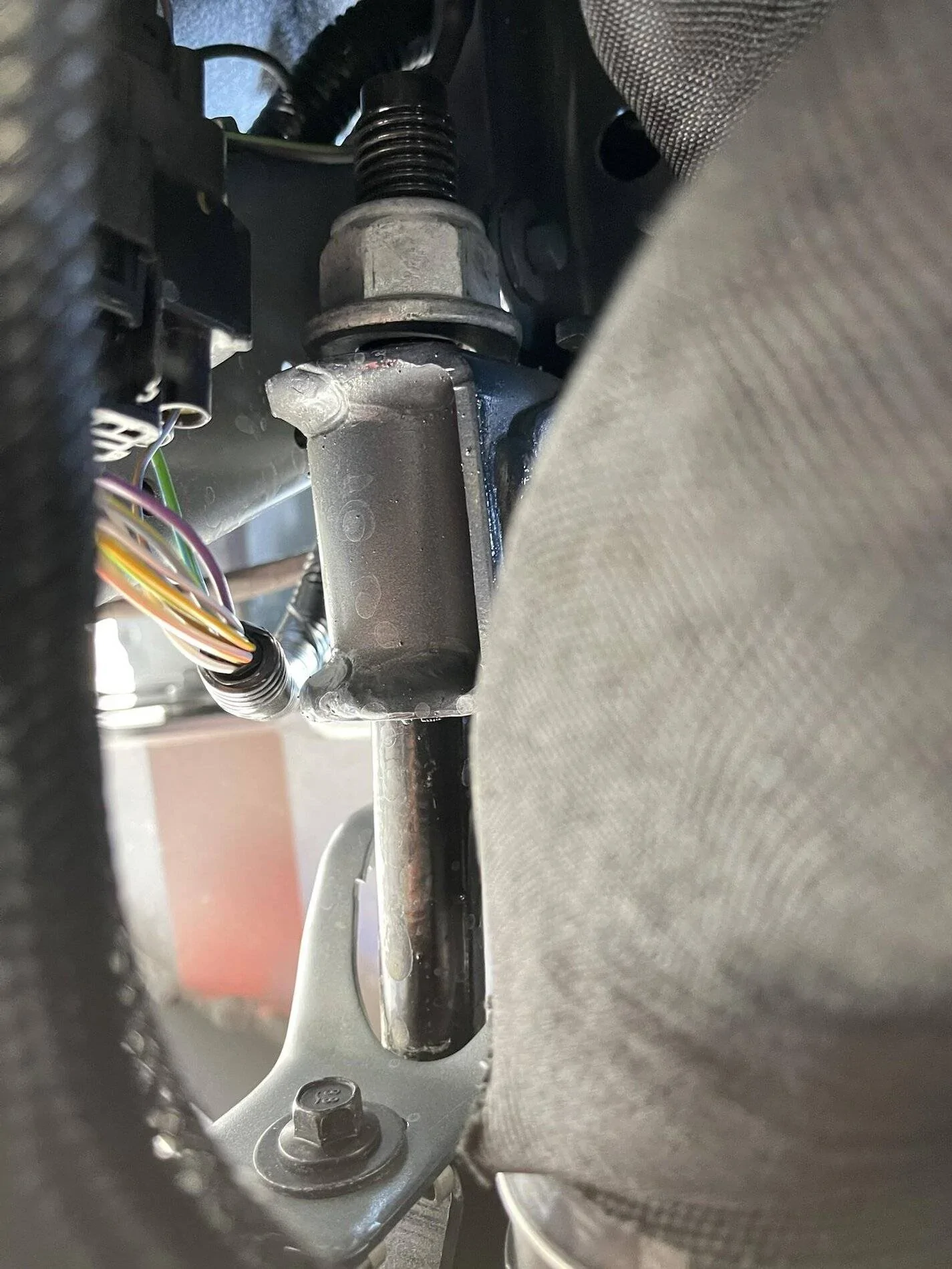

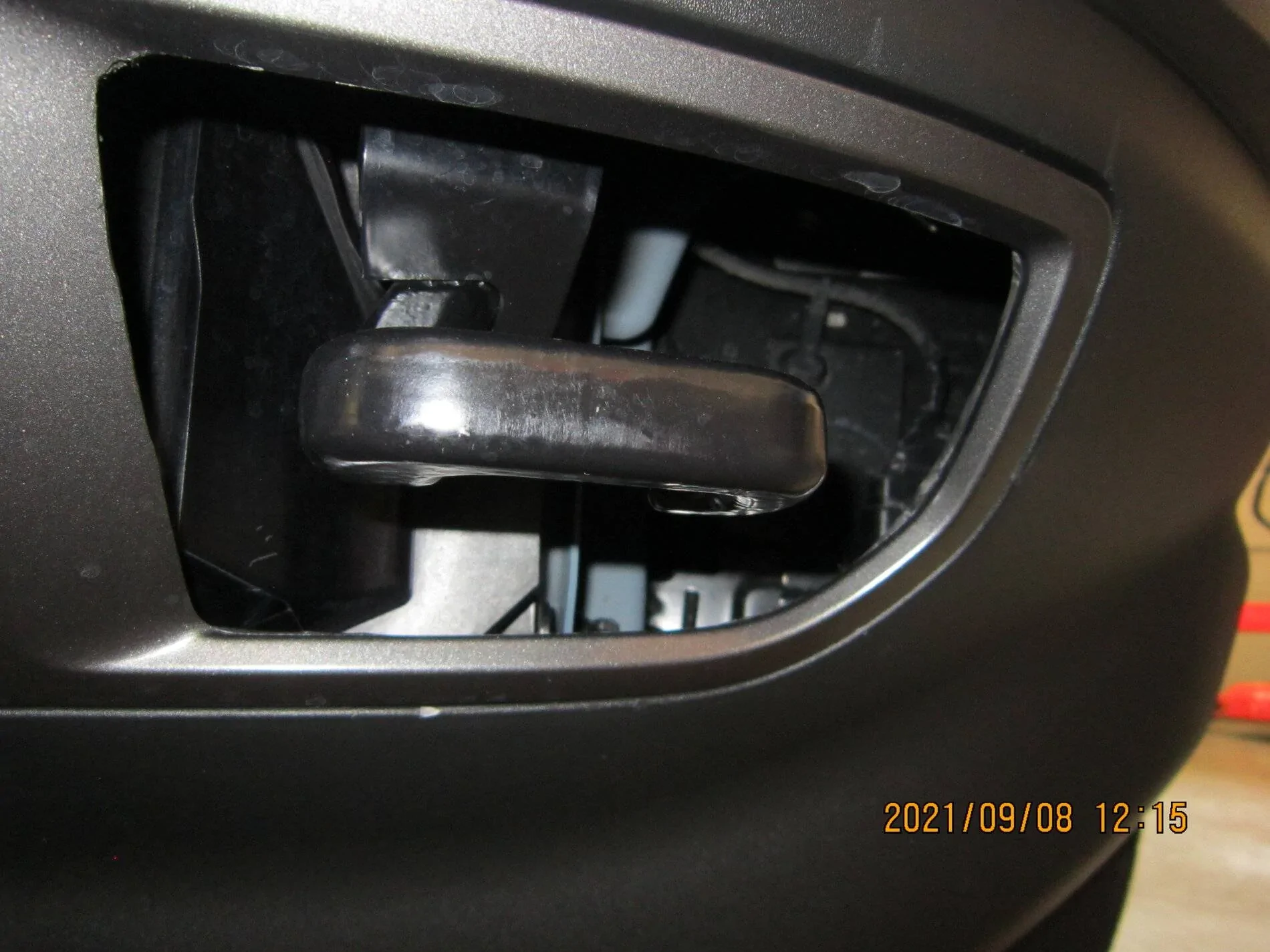

This is how it looks on a Big Bend.
I'm sure a fabricator should be able to make something.

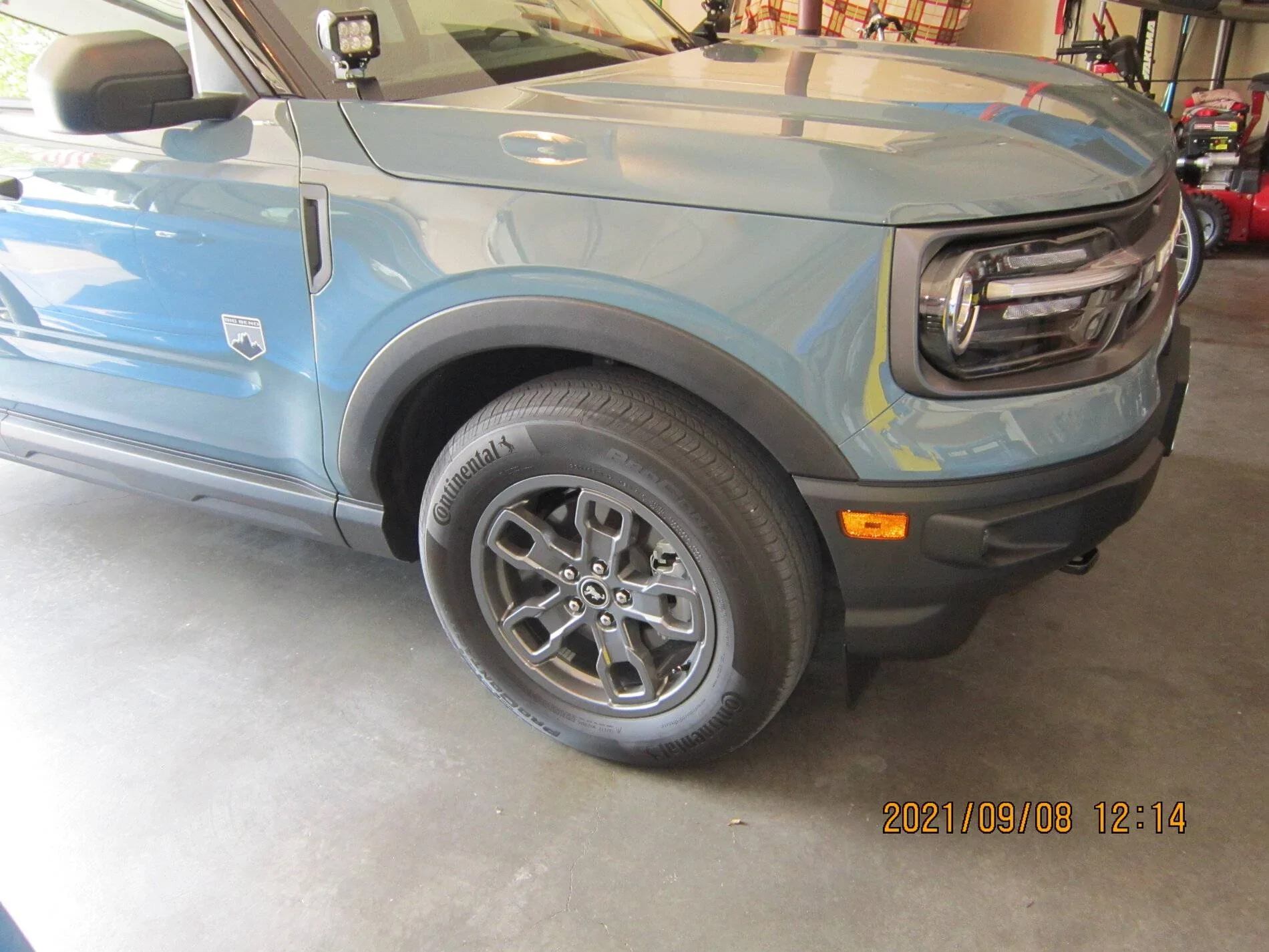

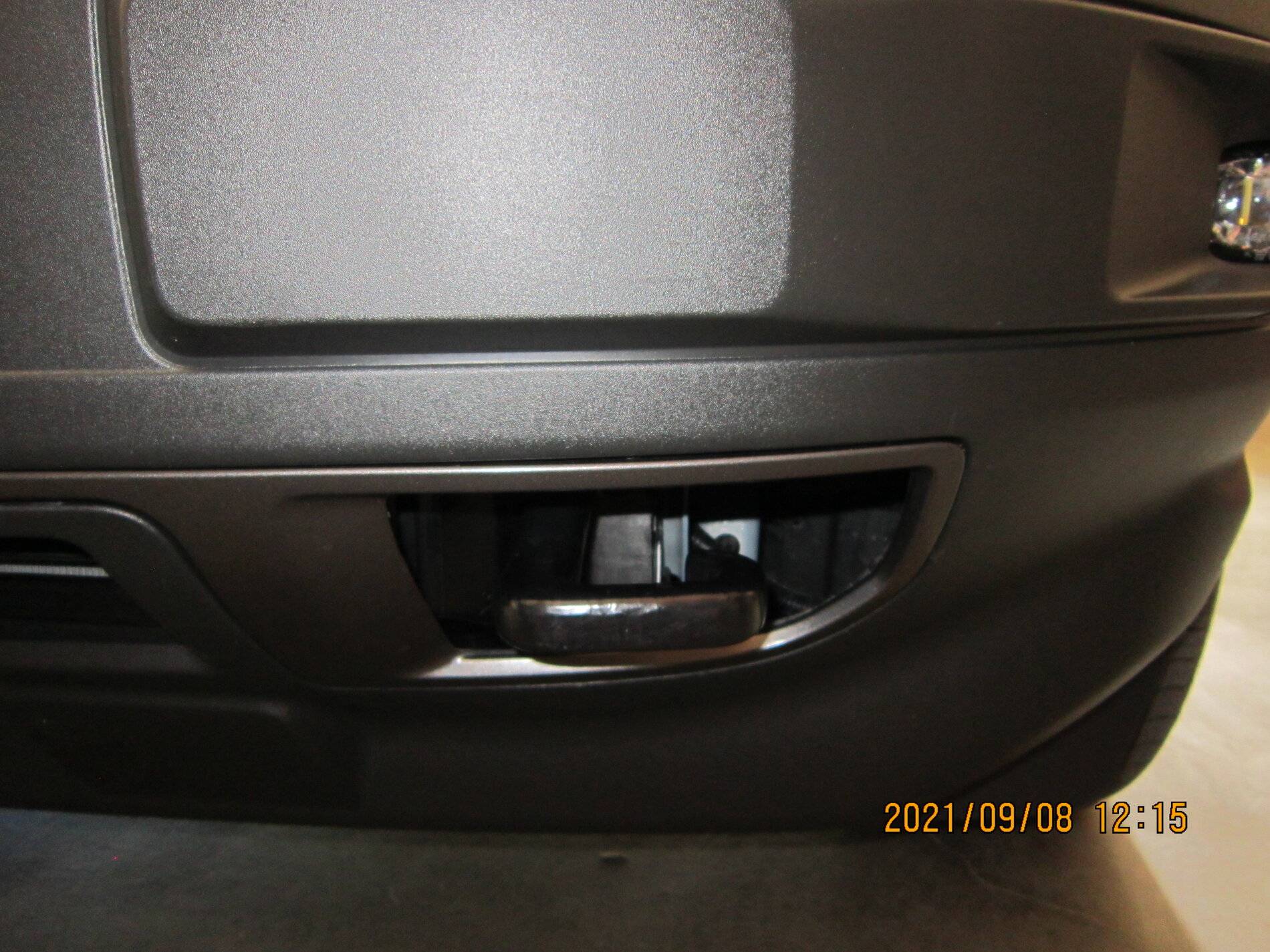

I put the tow hooks on my BB. You don't have to take the bumper off but you do have to cut out the vent like opening with a dremel. The tow hooks can then be mounted in the holes on the frame. The only thing is that there is no frame brace for the end of the hook rod. There is a trim piece on the bumper that you should remove prior to cutting out the panel hole. When you buy the hooks which are about $180 apiece you also need to get the 4 bolts to connect the hooks to the two threaded holes on each side.

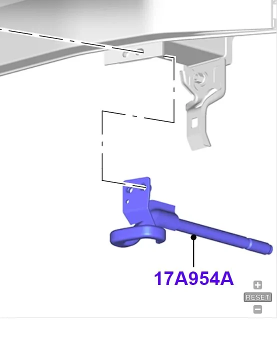

Maybe confirmed with this parts image. Seems us non-BL folks are missing the grey piece in the top right.
