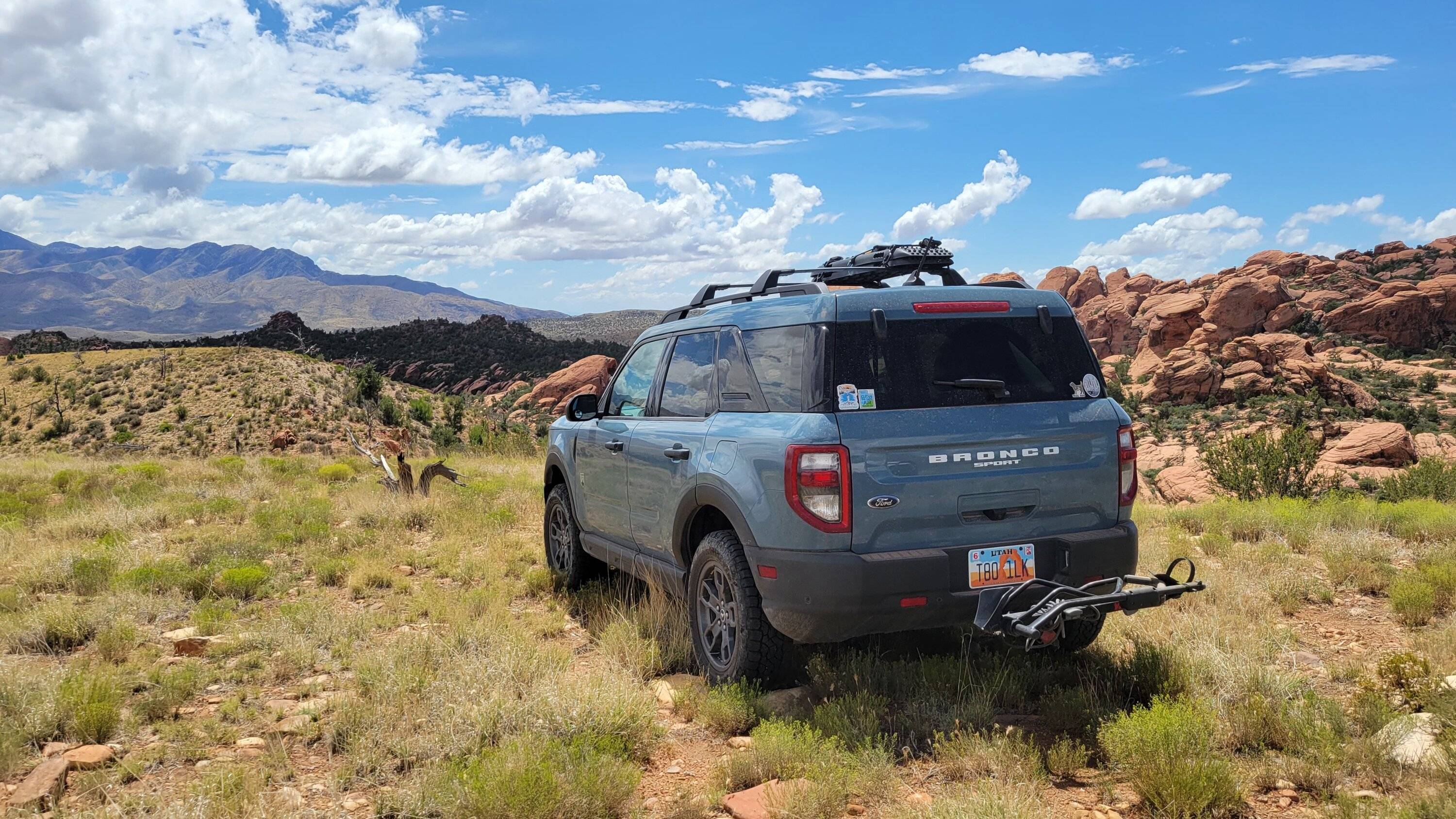

I had a Curt installed on my 21 BB. I asked about using it as a tow point and they said it would be fine. I attach a bike rack on mine so I'm not pulling and it has great clearance because I don't remove it at all. Even off roading.

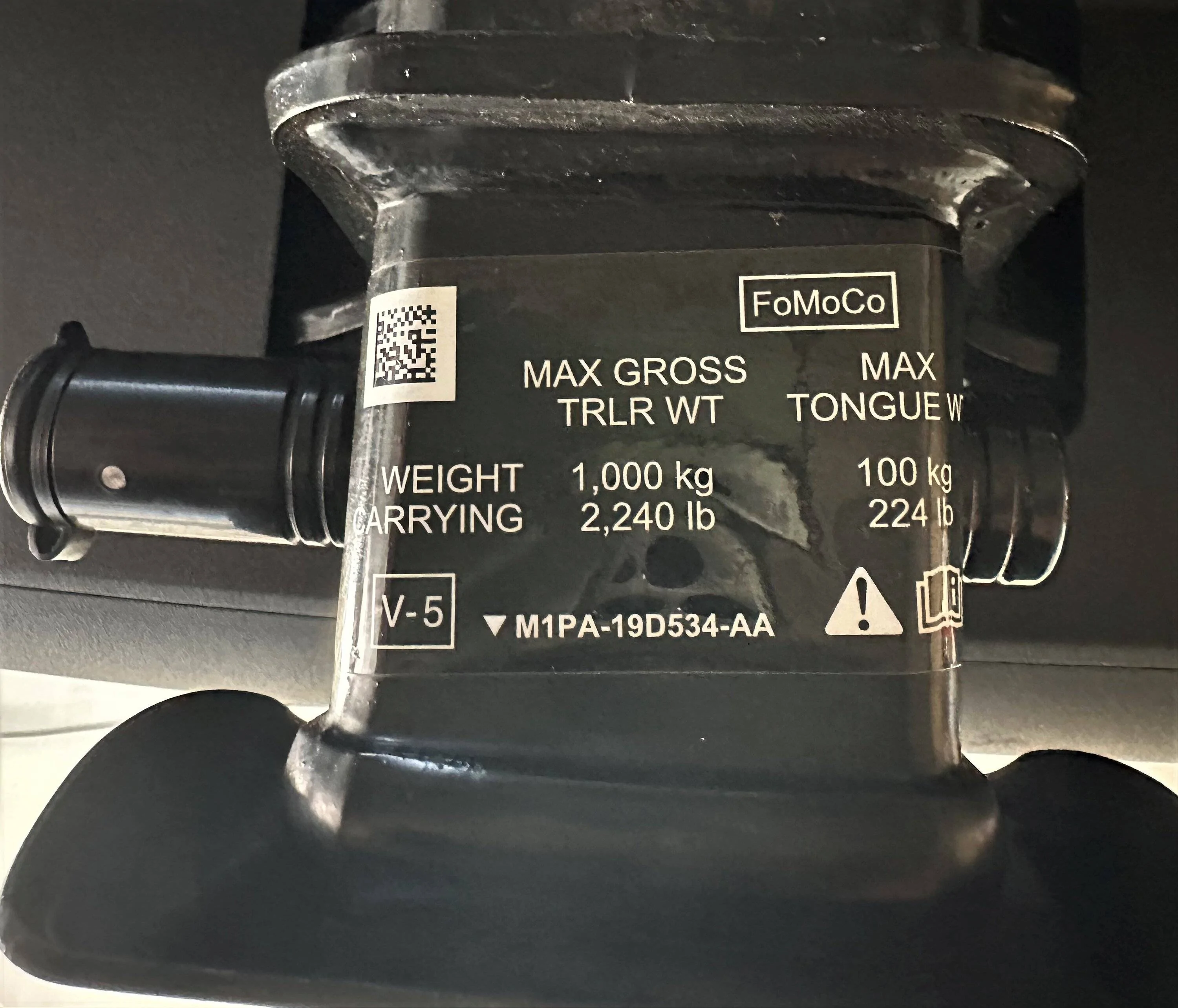

Here's a photo of the label on the bottom of the factory tow package receiver on my BL.
FWIW.
