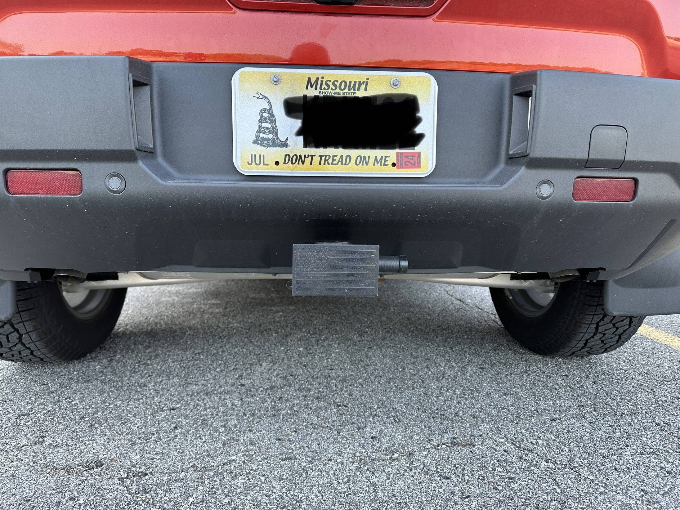

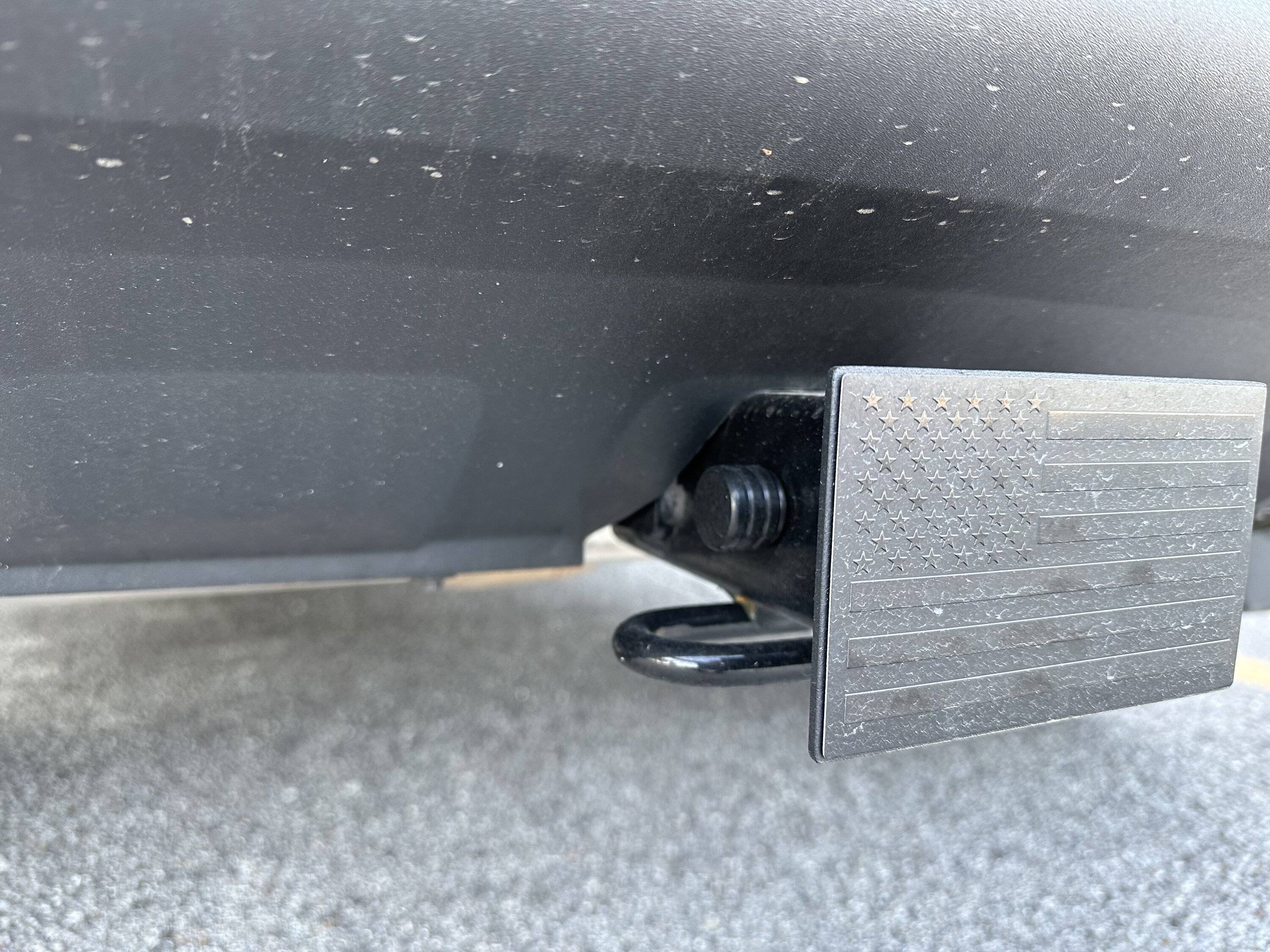

I installed the Curt one on mine, still had to notch the fascia and no support bars show, looks sort of "factory" I will try and find a picture of what it looks like. I choose the Curt because the install looked easier than the Ford one, at least the videos I watched.

Yes the install was failry easy and I did have to drop the exhust as the videos show. It helps to have 2 people and take your time on the "cutting" of the fascia. I ended up taking multiple passes just so I didnt make too big of a hole the first time. I havent yet used it for towing or recovery but it does attach to the frame just not the same as the OEM.

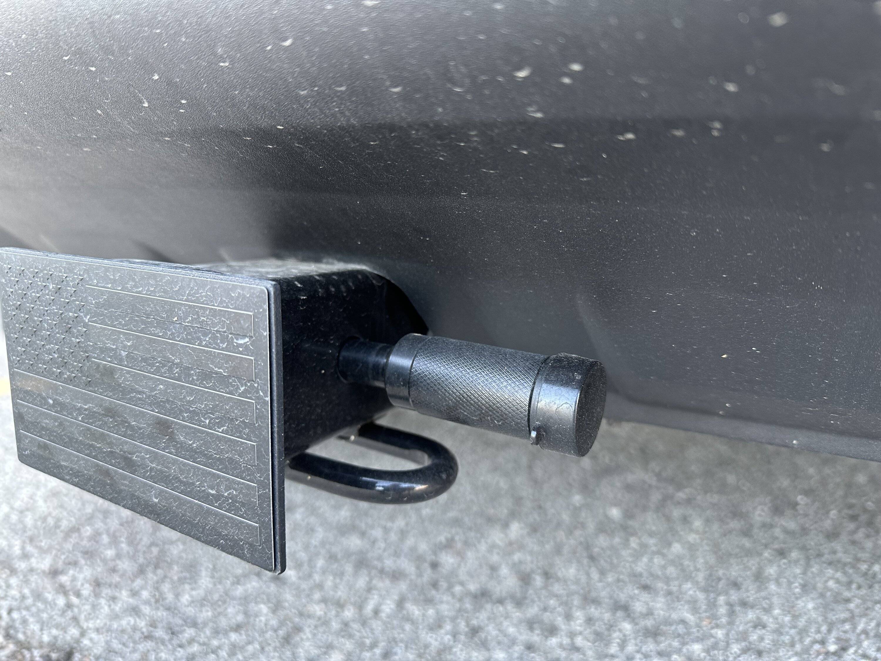

Just took some pics for you to see install.
Ford Bronco Sport Best "NON-straight-from-the-factory" Hitch IMG_1032
Ford Bronco Sport Best "NON-straight-from-the-factory" Hitch IMG_1033
Ford Bronco Sport Best "NON-straight-from-the-factory" Hitch IMG_1034
Ford Bronco Sport Best "NON-straight-from-the-factory" Hitch IMG_1035

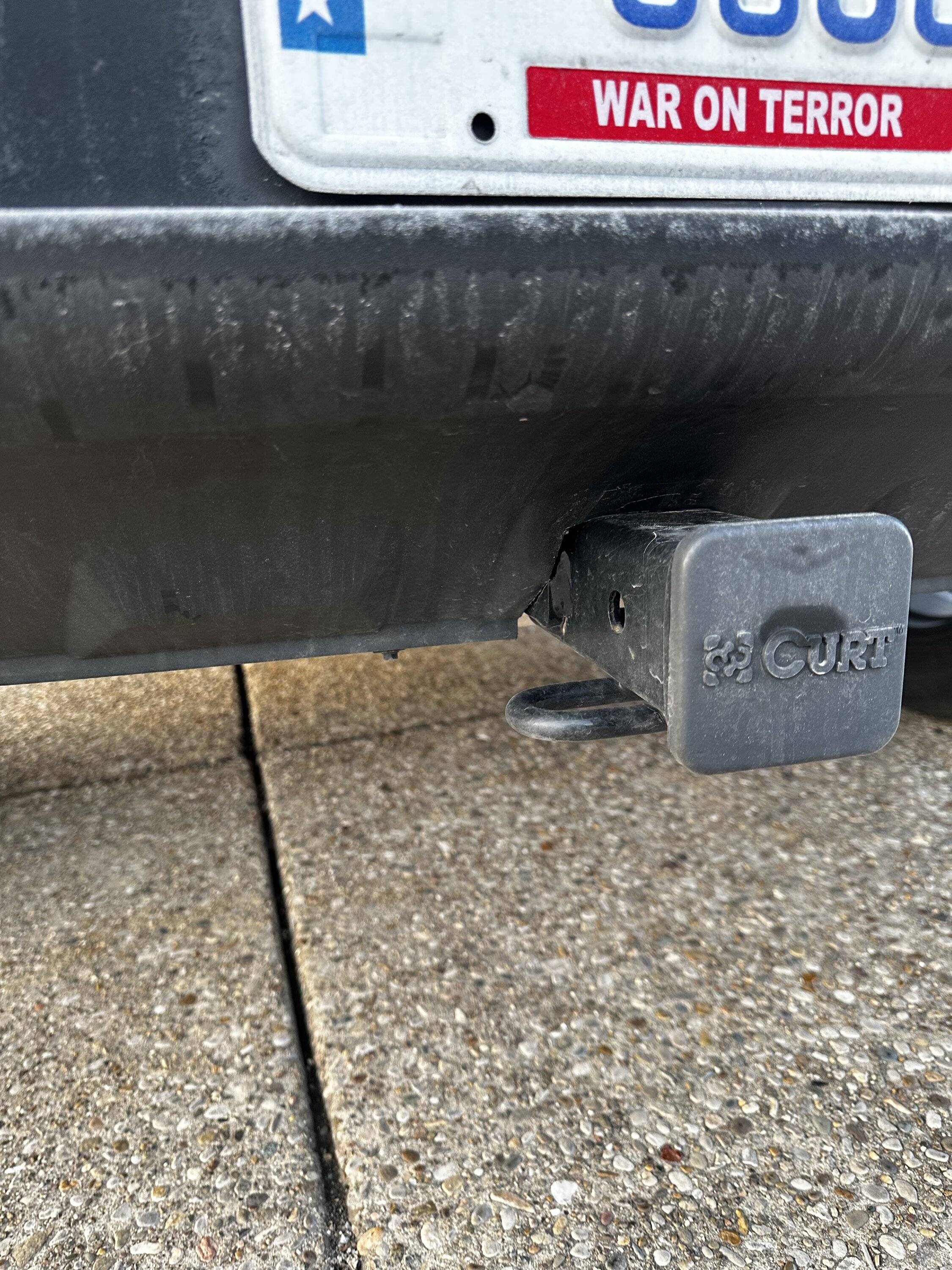

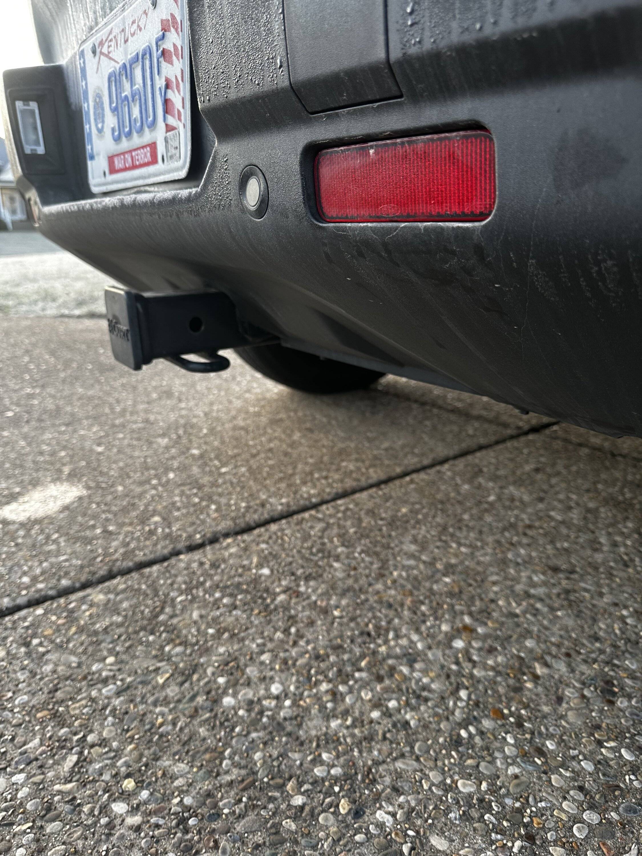

I liked the fact that the Curt hitch has horizontal safety chain hookups, v/s the Ford factory hitch. Also a big fan of the fact that Napa offers the Curt under 200$ plus free shipping. My opinion is that the Curt or Ford factory hitch is likely the easiest Install. With Drawtite, the rear bumper has to be removed, because the hitch frame replaces the crash bar-and you still get to drill the cut-out for it.
Ford Bronco Sport Best "NON-straight-from-the-factory" Hitch IMG_0055
Ford Bronco Sport Best "NON-straight-from-the-factory" Hitch IMG_0054

Everything installed and torqued to spec,....If you had to get pulled out of somewhere using that as the recovery point, do you feel confident that it would hold??
@Kraken23 that question goes for you too.
I wouldn’t hesitate to use it gatornek. Although the Ford factory hitch mounts appear slightly different than the Curt, it looks like both hitches with similar capacities either top load, or side load the bolts to the frame. In addition, even if the hitches by themselves are rated at 3500/350, any of the above are limited to the vehicle tow ratings: 1500/150, 2000/200 and 220/2200 for the Base, BB/OB, and BL/FE.

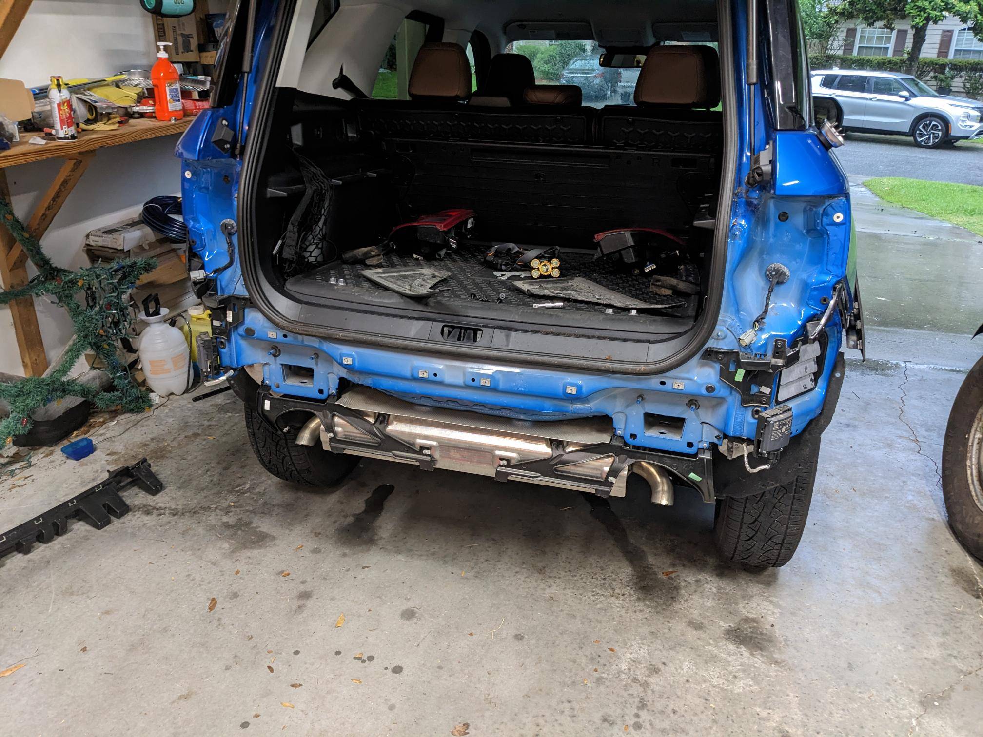

I can't speak for the other hitches, but I installed the Ford factory hitch myself in an afternoon. Rear bumper had to come off and the hitch replaced the rear bumper crash beam so I'd tend to believe it's very structurally valid. It bolts in from the side and the bottom.
Ford Bronco Sport Best "NON-straight-from-the-factory" Hitch tmp_74b4290f-0d69-4ce8-8b26-b2e66c7bb2e0
Ford Bronco Sport Best "NON-straight-from-the-factory" Hitch tmp_c2509d43-4a71-44bf-adcc-c956fef9a2bc
Ford Bronco Sport Best "NON-straight-from-the-factory" Hitch PXL_20230713_221620392
