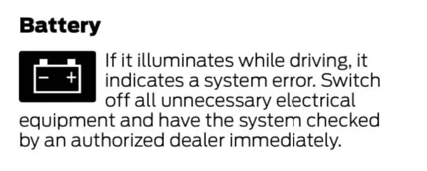

That light could mean other issues with the charging system not just the battery. Also, owners have reported actual messages both on the instrument cluster and in the FordPass App.
See this from the owners manual about the battery icon:
Ford Bronco Sport Battery just died - no warnings or any signs IMG_7818
