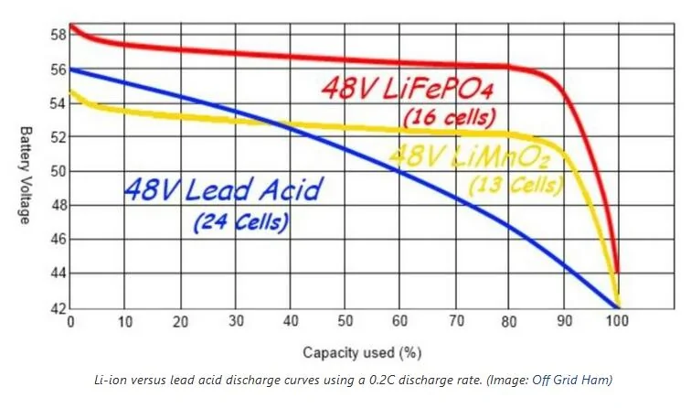

Some background on why this is even an issue in the first place: While there are a ton of advantages in using the newer lithium-ion batteries that these vehicles have, one of the major drawbacks is the very steep discharge curve. Old lead-acid batteries have a flatter discharge curve, which means they give you plenty of warning when they are dying. Lithium-ion batteries just don't do this- they can be on very little charge and give you almost full voltage- making traditional voltage monitors pretty useless. Here's a graphical example of what I'm talking about:
