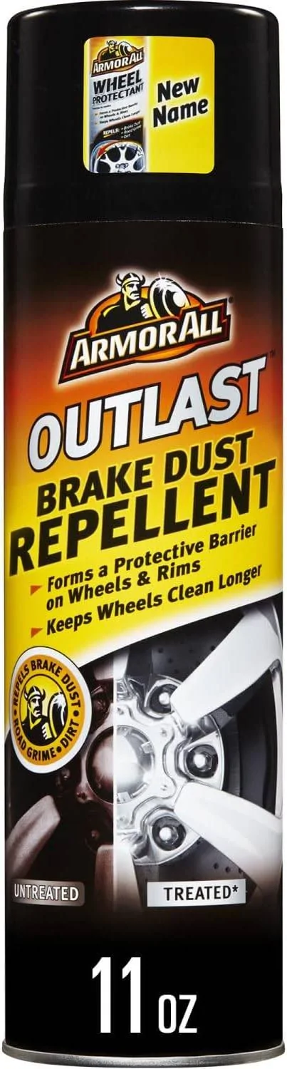

Yeah, i seem to get t loads of dust on my Heritage trim wheels (white)…. sort of a bummer.
I cleaned the wheels, gave them a hit with one of the Armor All ceramic coatings and all it really takes is a quick rinse to get rid of the brake dust... easy-peasy...
PS - no complaints with the factory brake pad performance at this point
