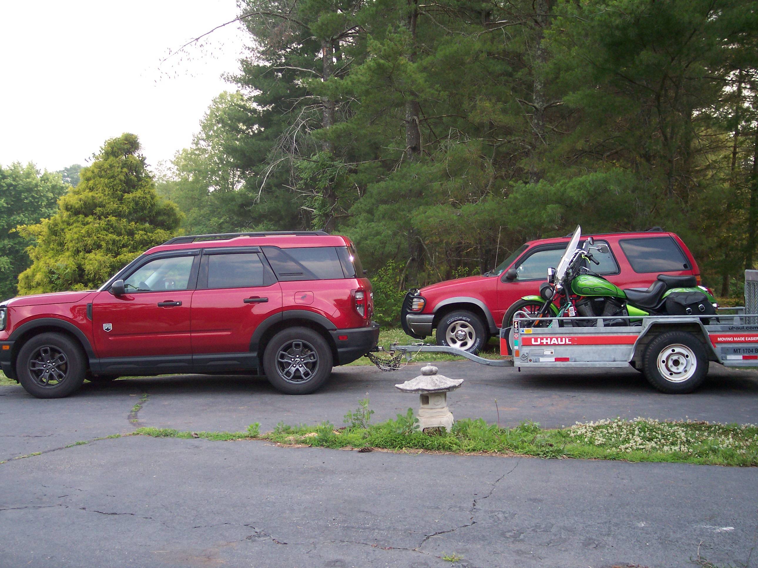

In June we did a 900 mi round trip my wife's 2021 BS/BB towing my wife's 2016 Kawasaki Vulcan from southern Virginia to southern NJ. Towed it without a problem, even with the hills in Virginia, West Virginia, & Maryland.
