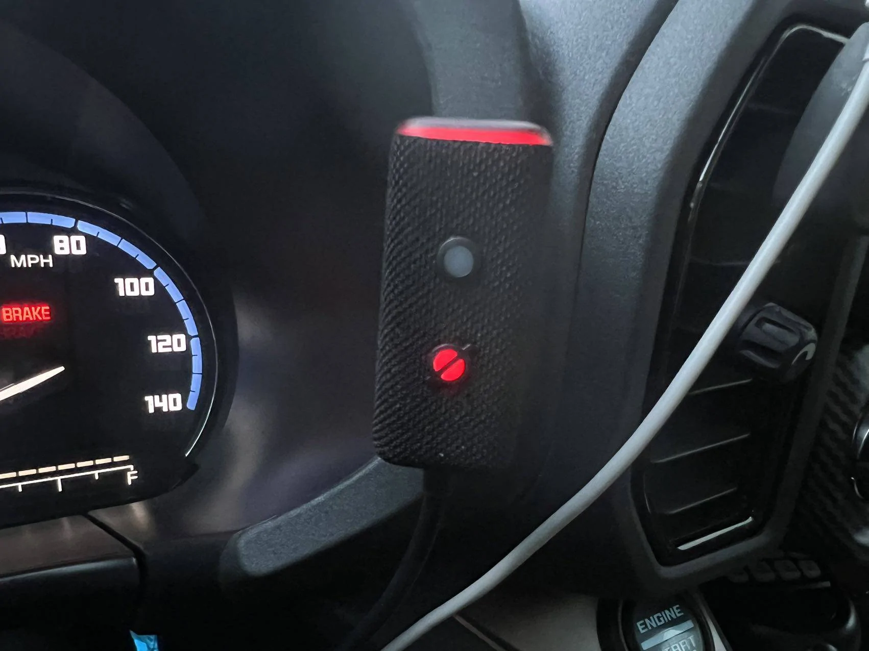

The Echo Auto act as the microphone for the Alexa Hand Free. It gives you the ability to use Alexa hands-free in the vehicle.

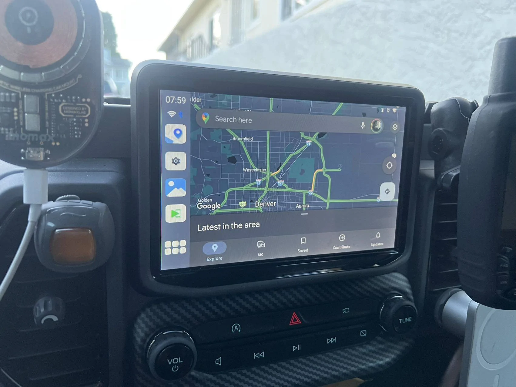

1. Plug in the Carlinkit Ai Box to the dash side USB C port, you need to wait for a while and it will take over the screen and display the Android interface.

5. Plug in the Echo Auto to the second USB port at the bottom, you can place it anywhere you want. I put it on the right edge of the gauge cluster.

When starting a Navigation on Google Maps, music sounds bad.
Reason:
This is because when you start using Google Maps, the Google Assistant in the Map will be in action, that means it will turn on the microphone and wait for you to say OK Google. This will let the audio switch to a telephony protocol (I won't get to the technical details of this...), so the sound will be bad.
Solution:
For Android 12 Ai Box users, turn off everything with Google Assistant in the Google Maps, and after you start Navigation, and click on a different app, the Google Maps will become a Picture in Picture floating window. Wait a minute and click the floating window, your audio will be fine.
For Android 8 Ai Box users, use Waze Map instead of Google Maps, and turn off everything for Google Assistant in the Waze App.
