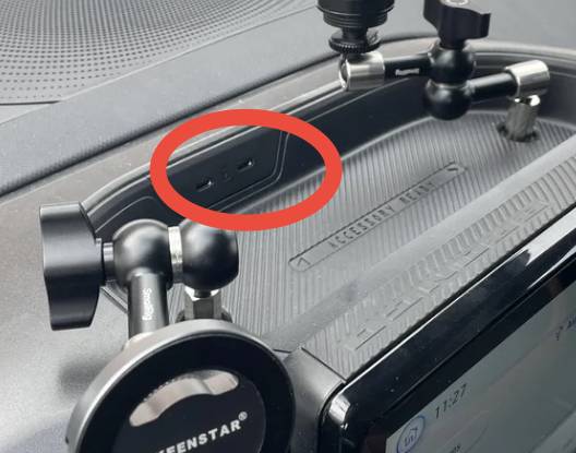

I connected the bulletpount mounting solutions 25 bronco sport package. Connected right to the two mounting bolts. 😊 got a VERY solid phone holder and a GoPro mount connected.

I sure am. Using the dashboard USB-C ports to power, my phone and the GoPro
Thanks. That was my concern, can the USB-C ports can handle the needed power requirements of a dashcam. Obviously all dashcams have different power specs.
It would be nice to know what the power output is from the ports.

There’s adequate power there for anything that needs power. 😊

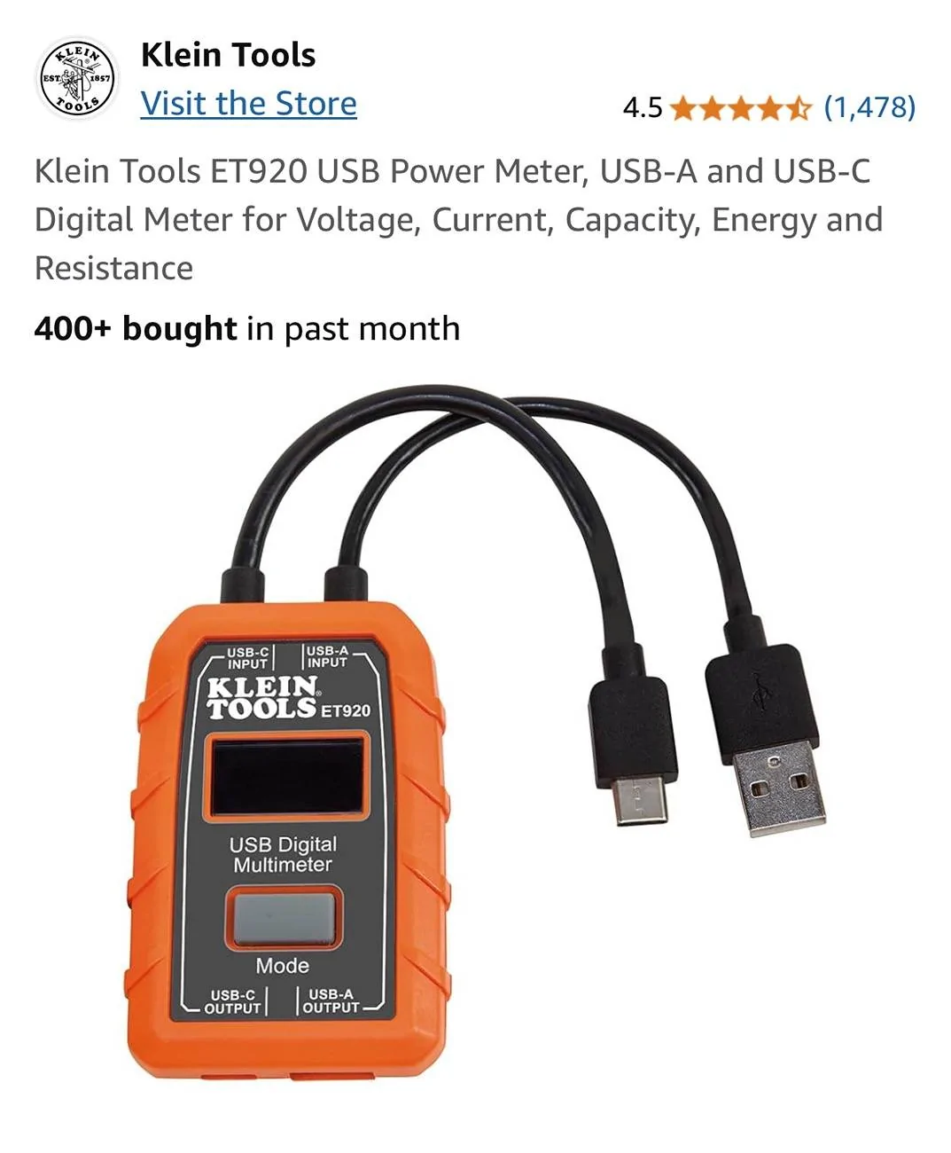

“It would be nice to know what the power output is from the Bronco Sport ports”
That’s easy to measure using: Klein Tools ET920 USB Power Meter, USB-A and USB-C Digital Meter for Voltage, Current, Capacity, Energy and Resistance

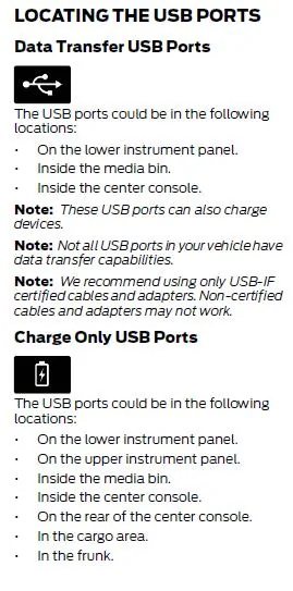

I still have not found a spec from Ford for the power that the USB-C port in the ‘25-‘26 accessory tray can provide
For my 2022, I measured the Center console USB-C Port: 5V/3A which is 15W using a high power USB Cable (USB Cables as well as the end device being powered influence the output power put out by the USB Port - easy to measure with the Klein tool)
