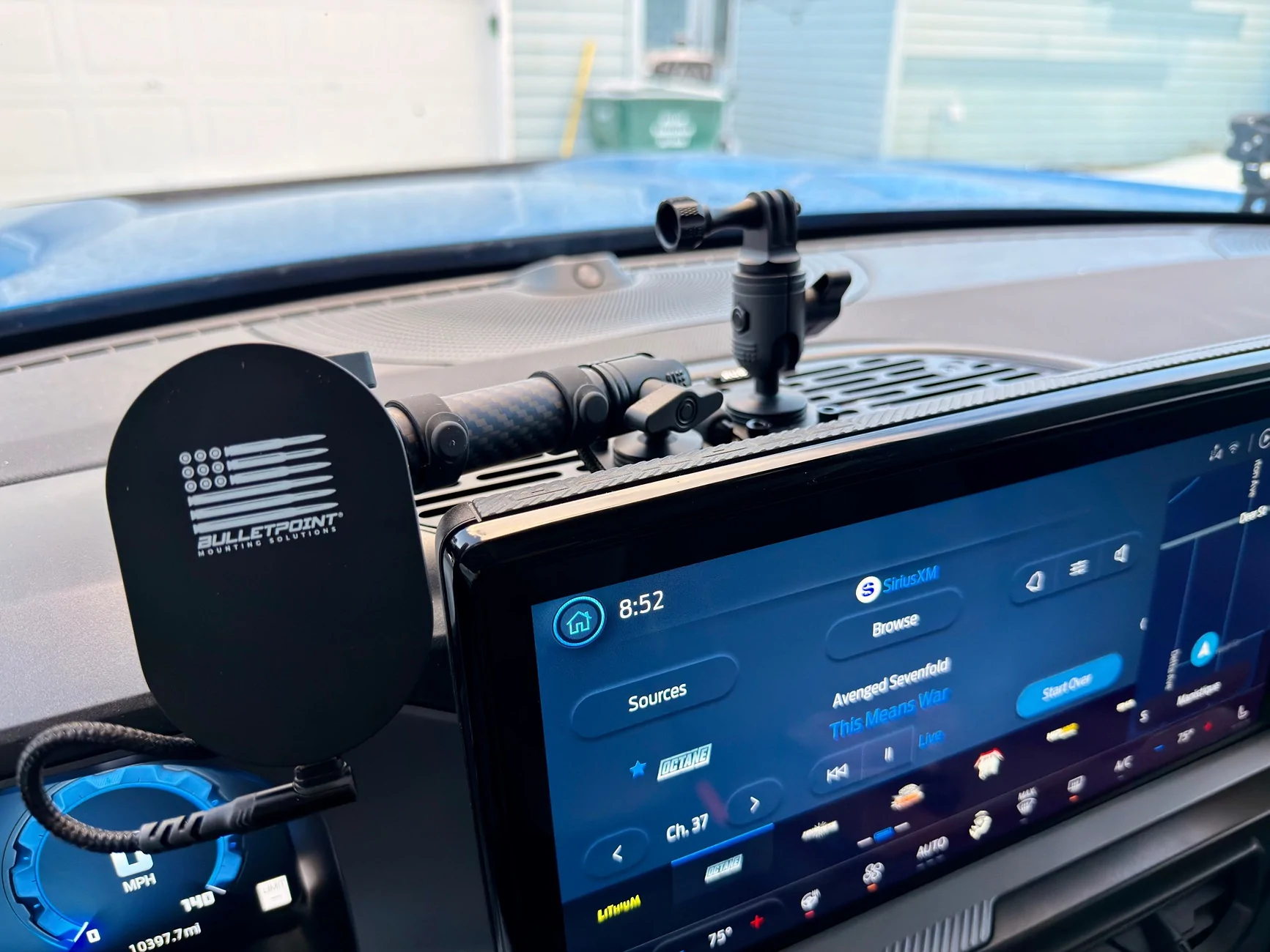

I connected the bulletpount mounting solutions 25 bronco sport package. Connected right to the two mounting bolts. 😊 got a VERY solid phone holder and a GoPro mount connected.
Do you use a Go-Pro and are you using the USB-C ports for a power source?

I sure am. Using the dashboard USB-C ports to power, my phone and the GoPro
Thanks. That was my concern, can the USB-C ports can handle the needed power requirements of a dashcam. Obviously all dashcams have different power specs.
It would be nice to know what the power output is from the ports.

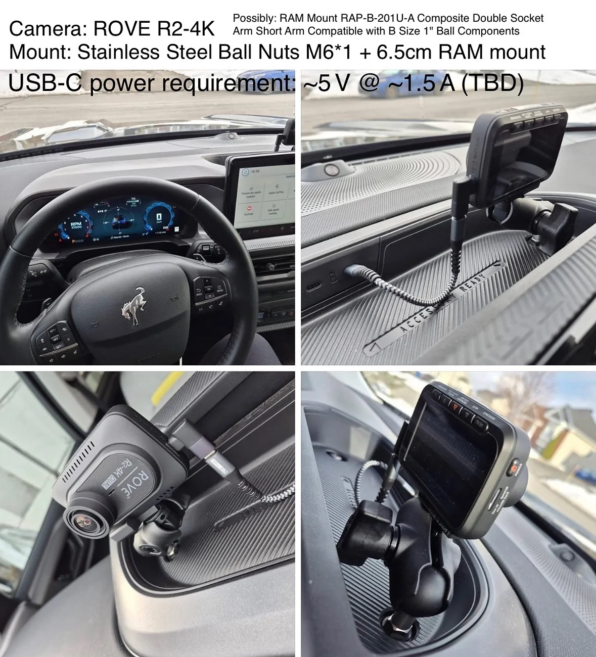

Apparently the ROVE R2-4K camera can be powered from the USB-C port in the ‘25-‘26 accessory tray
Not entirely sure but this camera’s USB-C power requirement might be: ~5V @~1.5A (TBD). I still have not found a spec from Ford for the power that particular port can supply.
Also: a hardware kit can be purchased from ROVE to supply power for some amount of recording when the vehicle is turned off
Another owner posted these pics (the added wording is mine)

There are many dashcams that exceed the power output from the USB-C port in the ‘25-‘26 accessory tray - they won’t work
