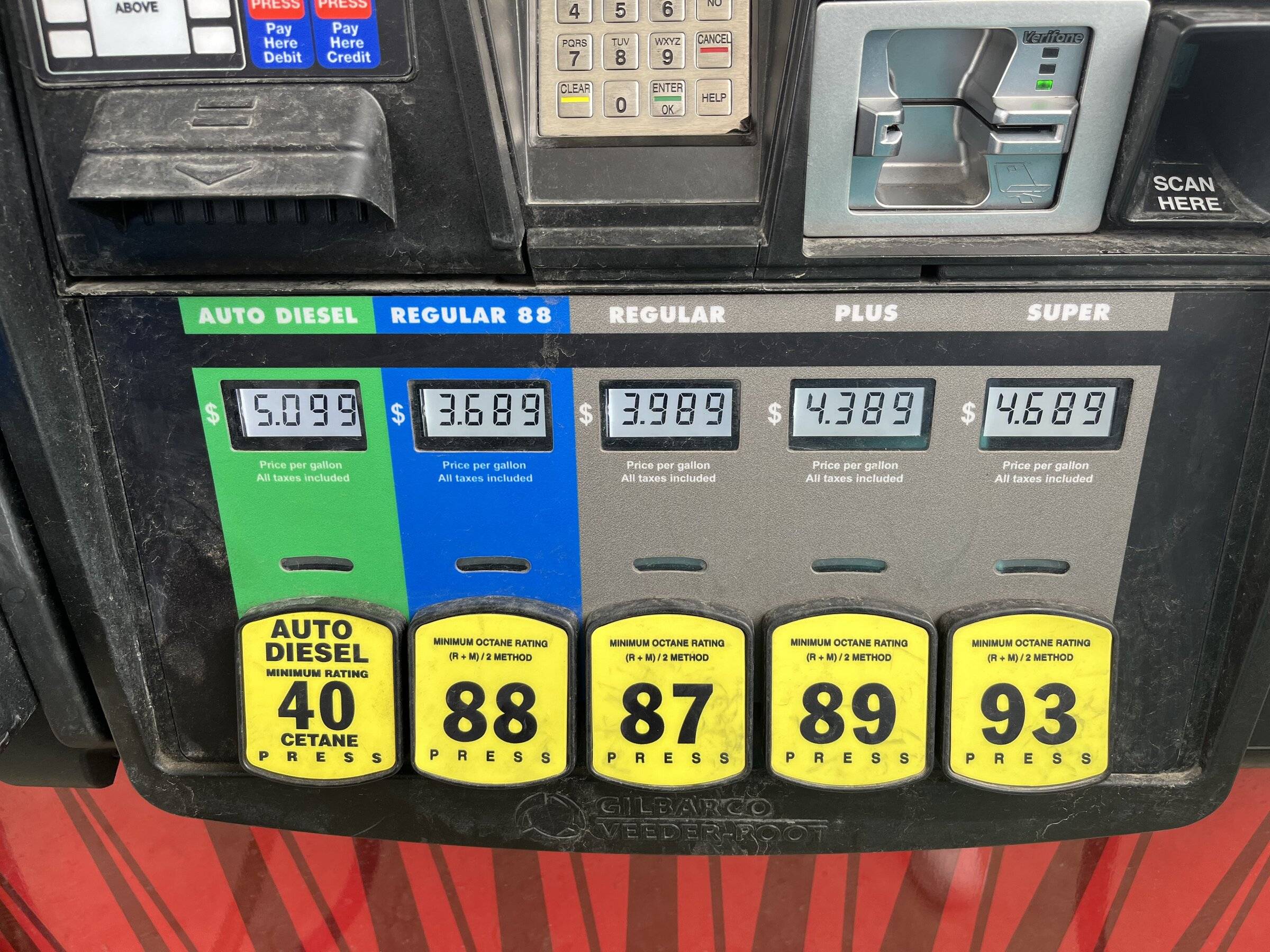

This might be a dumb question…I went to get gas the other day and these were my options. Went with 88. I have just over 16k miles on my Big Bend. Is that okay or a mistake?

Unleaded 88, also known as E15, consists of 15% ethanol and 85% gasoline.
This fuel has a higher octane rating than regular 87 octane fuel, offering your engine a boost, and it burns cleaner than regular unleaded, improving our air quality and reducing greenhouse gas emissions. It is also typically offered at a lower price
The difference is Unleaded 87 has 10% ethanol and Unleaded 88 has 15% ethanol. The 5% increase in ethanol increases the octane rating to 88.
Mild downside, the more ethanol, the more it tends to gum up fuel lines etc over time.
It's easy to say one tank won't be an issue, and with new motors it's less likely to cause harm...I was forced to use 92 octane on a road trip long ago and it fried my oxygen sensors. Again far les.likely with the technology today...but never say never
Your owner's manual says you must use fuel with a minimum octane of 87 that contains no more than 15% ethanol. As others have noted, the 88 octane selection is 15% ethanol, so it meets both of the manual restrictions. The reason it's 88 octane instead of 87 is because ethanol is higher octane than gasoline. By upping the ethanol content to 15% in this blend you get slight higher octane than the 87 octane regular, which is most likely 10% ethanol.
The only major downside to using fuel with 15% ethanol is your fuel economy may suffer. Ethanol has much less energy content (measured by BTUs) than gasoline, so increasing the ethanol content in a blend will reduce the overall amount of energy in each gallon.
