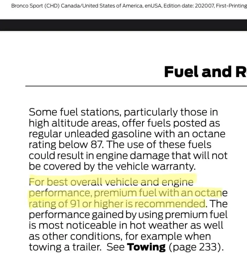

87 is required. 91+ is recommended (for max targeted hp) and other times for best overall vehicle and engine performance.
Ford Bronco Sport 87 vs 91 Octane? 3676C473-6939-421C-B3DA-CB9FEF4630E8
Yeah I read that but I doubt I'll ever push my engine into that upper zone of 90-95% power.
Flame propagation Is slower with Higher octane I just see no reason for it, never have.
As for 'training an engine' It's an on going thing as the atmosphere Is always in a state of change. I'll trust my Airgate until I hear a knock.
