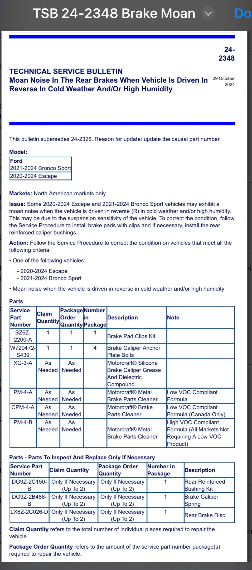

Ford’s latest fix for the Moan Noise In The Rear Brakes
EDITED 3/13/2025:
TSB 24-2348 may be superseded, see TSB 25-2051 and / or contact your dealership.
Moan Noise In The Rear Brakes When Vehicle Is Driven In Reverse In Cold Weather And/Or High Humidity
Date: 17 February 2025
https://www.broncosportforum.com/forum/threads/25-2051-moan-noise-in-the-rear-brakes.13913/post-228320
TSB 24-2348
Moan Noise In The Rear Brakes When Vehicle Is Driven In Reverse In Cold Weather And/Or High Humidity (for me can occur at pretty much any temp or humidity including high temps >100°F and low humidity)
This bulletin supersedes 24-2326. Reason for update: update the causal part number.
The pic shows just the 1st page, the full content is found by searching at: https://www.ford.com/support/service-information/
Ford Bronco Sport 24-2348 Moan Noise In The Rear Brakes IMG_9944
108
4,332
4,993
For those interested here is some of the history:
TSB 24-2348
TSB 24-2348
